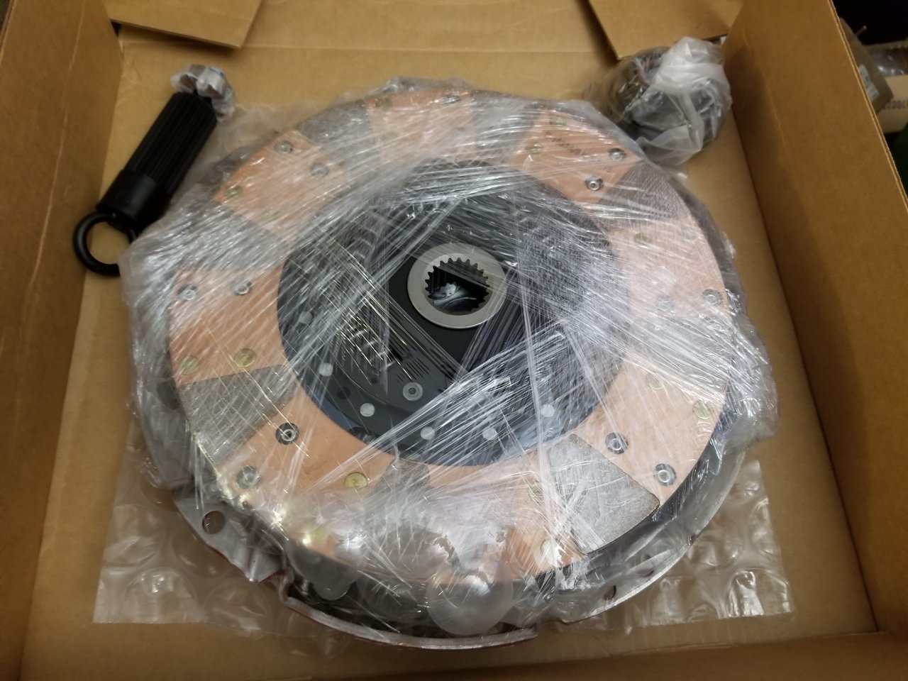

    Dual comp clutch ! Piling up the parts for the turbo install :cool:

    What torque output is that rated for?

    NWF crawlbox, 5.29s, rear Detriot, front Harrop, 37" SXIIs, 17x9" KMC Grenade Crawl beadlocks, Dirt King 3.5" LT kit with King shocks, Fox 12" smooth body RR, BAMF shock kit, AP 3" springs, ext. brake lines, custom 1 piece driveshaft with .135 wall tubeing, GSF front rock crawling bumper, GSF rear bumper, Relentless Fab ifs skid, BAMF k/o sliders, X2O 10K comp. winch, TP glass fenders, OKled 20"bar, EBS dimpled/slotted rotors, EBS green pads, custom K&N CAI, LCE headers, FM Super 44 w/h turn down, URD MAF, Spec clutch, LCE heavy flywheel, URD short shifter, TMPer M1 Abrams shift knob, Amsoil oil, Cobra 75wxst w/h 4' firestix, Grillcraft, FXR TRS, T1 eyelids, custom ADV Monster 60 lights, bed lights, speedo light mod, Glow Shift volt/oil pres gauges, Glow shift 2g column pod, Optima yellow tops dual battery setup w/h IBS system, Pioneer DEH-P7200HD head unit, Pioneer 600W 4ch & 350w 2ch amps for doors and sub, Wet Oakle covers
    I've been running this clutch for 5 years now and it's fantastic. Currently using it with 4.88s and 36" TSLs. I clutch kick a lot in the rocks, especially when running 2nd gear in 4 Lo and it still holds strong. Its easy to drive on the street and very predictable (engage point/length doesn't change as it heats up). Great clutch.

    Now thats the info I was hoping to hear! Thanks for that!

    385TQ and 385HP
    Should be good for a while, and will still be drive-able for the street

    Yeah I like it a lot. I had 2 different clutches before and burned both up in a short amount of time. I'm trying to stay away from a puck style. I run a ACT 6 puck in my turbo FRS and it's a great clutch but it grabs soooooo hard and is very unforgiving. Most people who drive it once don't care to drive it again. Haha but this dual comp is very streetable. It grabs hard but has just enough play to allow you to get going easily. It doesn't like to be rode though. Like, at all. There's that 1/2" in the pedal stroke that you can hold yourself from rolling back on a hill or on flat ground you will just barely start to roll. Here, you can hear the disk scraping the flywheel. The next 1/2" of the pedal stroke is the danger zone where that bitch does not want to be in. If I try and keep it here, it bucks my truck violently back and forth like bad wheel hop from axle wrap. Set that bitch loose. It doesn't like that half open/half closed cage with some raw juicy meat dangling just 6" out of reach. Its terrible to tease it like that. Free the beast!! Haha
