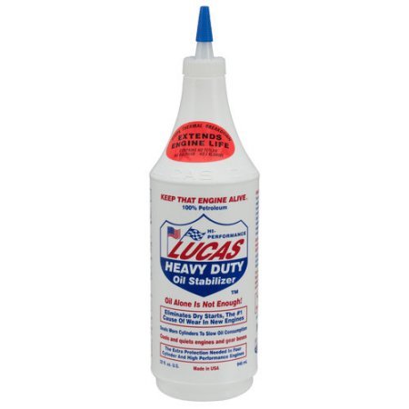

    If the above suggestions doesn't work, you can pull a spark plug out and if you find your spark plug is full of burnt things. That means your engine has serious internal problems like bad valve seals or worn piston rings and will cost a lot of money to fix that. You could try a quart of Lucas oil stabilizer to slow down the oil burning and could add more years to your engine.
