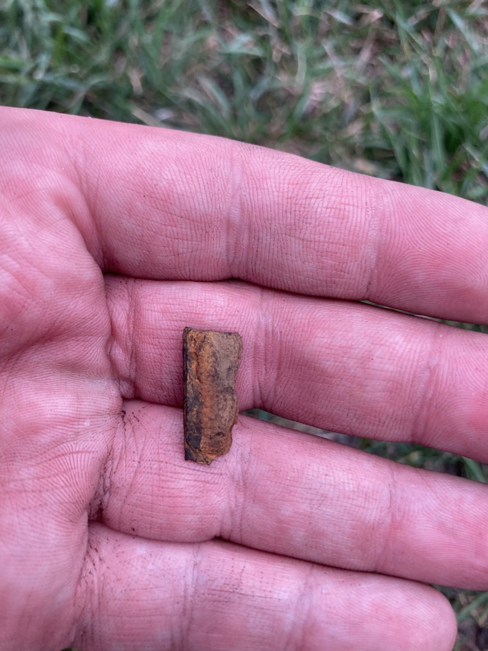

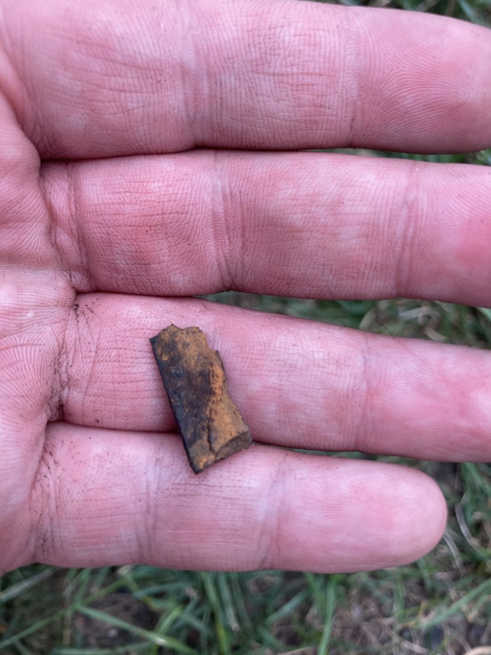

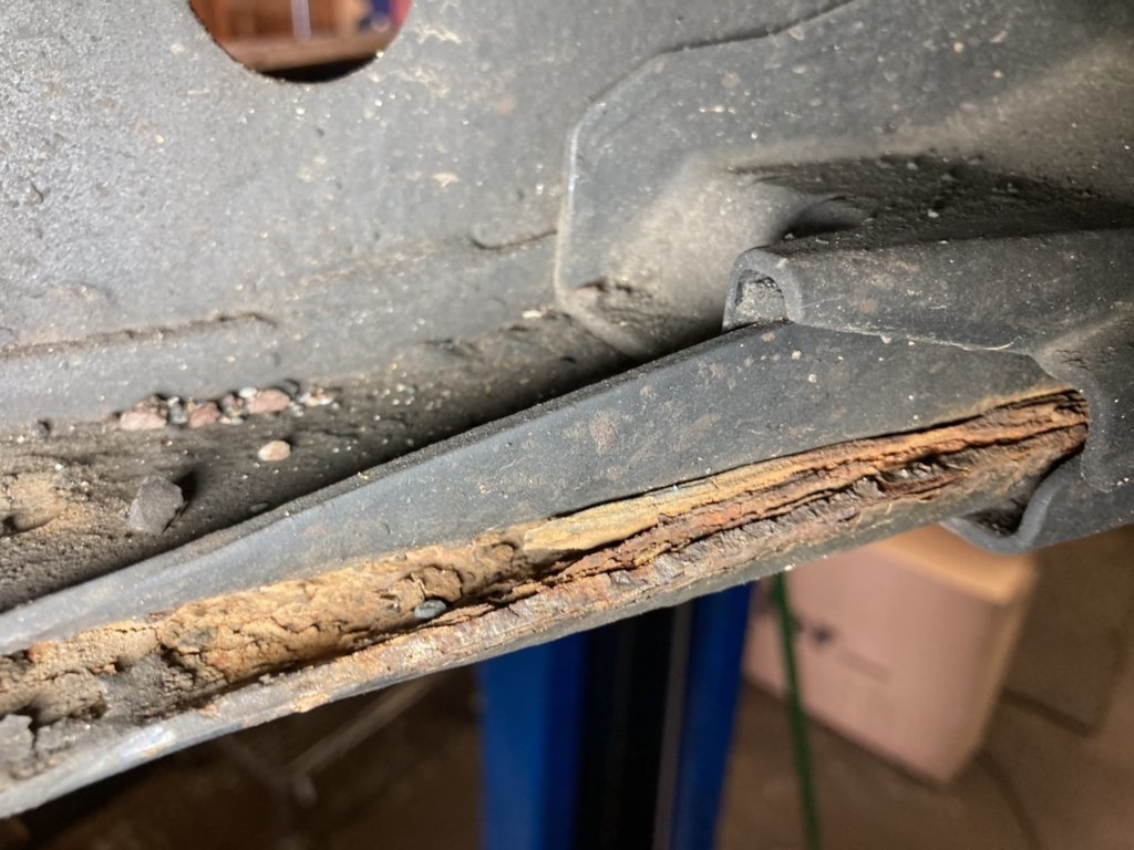

    This is the "trouble spot" on the driver's side that my independent mechanic Pete found when I brought the truck in for annual safety inspection and emissions testing; A chunk actually came off as you can see, but it did not qualify for a replacement...
    B556FCE2-B3C7-4701-B16B-7407944E75BC.jpg 630B3BD5-7685-46D6-9D49-BE86CA085824.jpg E1322502-677E-47CB-8B5F-C3179826D2B1.jpg 7D7B5BE0-54B2-4196-BF1B-B856E99B0E2F.jpg C6A17AD5-BC38-40D9-882B-9F7930E2C935.jpg

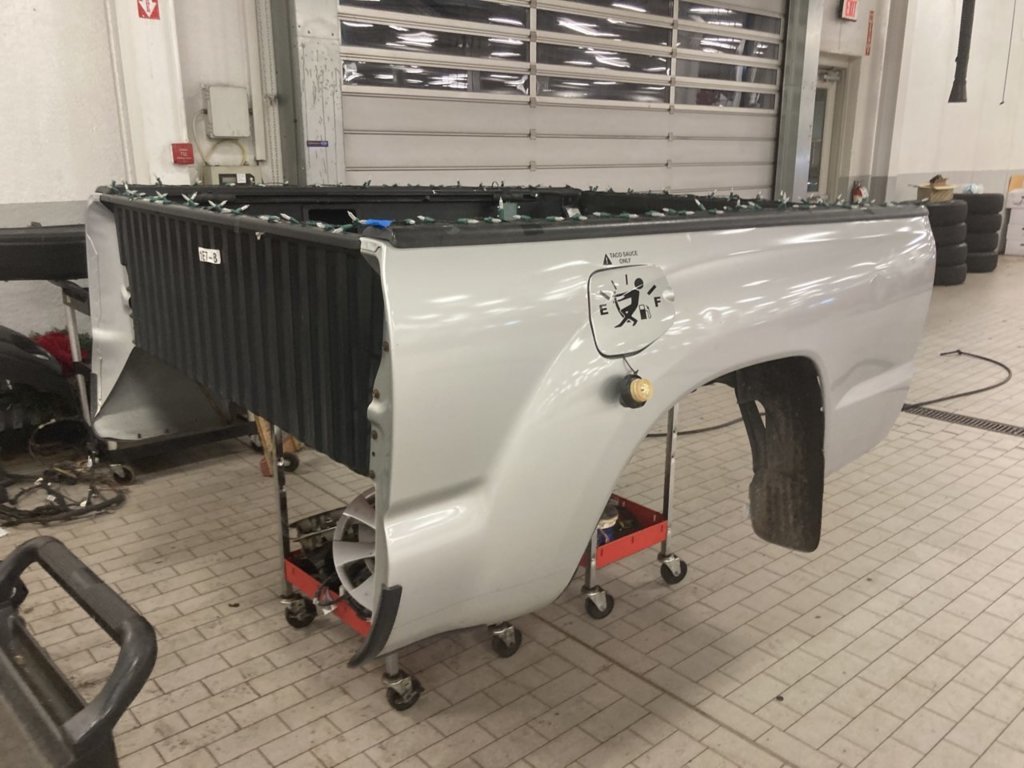

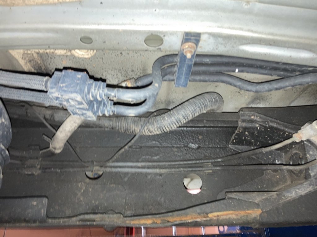

    Pictures of the carnage!
    81B7CF78-64B1-4CEC-98A0-8DF68CD94724.jpg 7225050A-1CB3-445F-B9D7-FF38367BEE4B.jpg EEC70FDA-2D1E-4F82-86BF-86CF2896F191.jpg 806C2C5C-4A6D-4D08-A942-6F8333384494.jpg

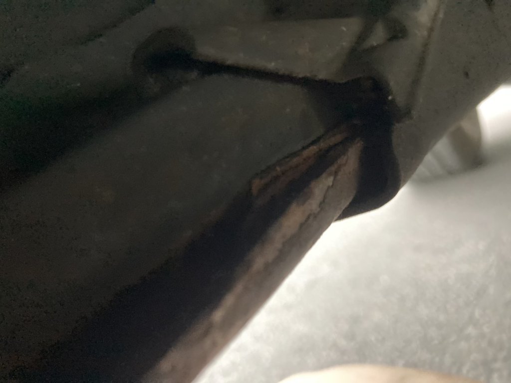

    You mean that spot? Yeah, it was rusted but it wasn't "perforated"...
    Chris2009[QUOTED] likes this.

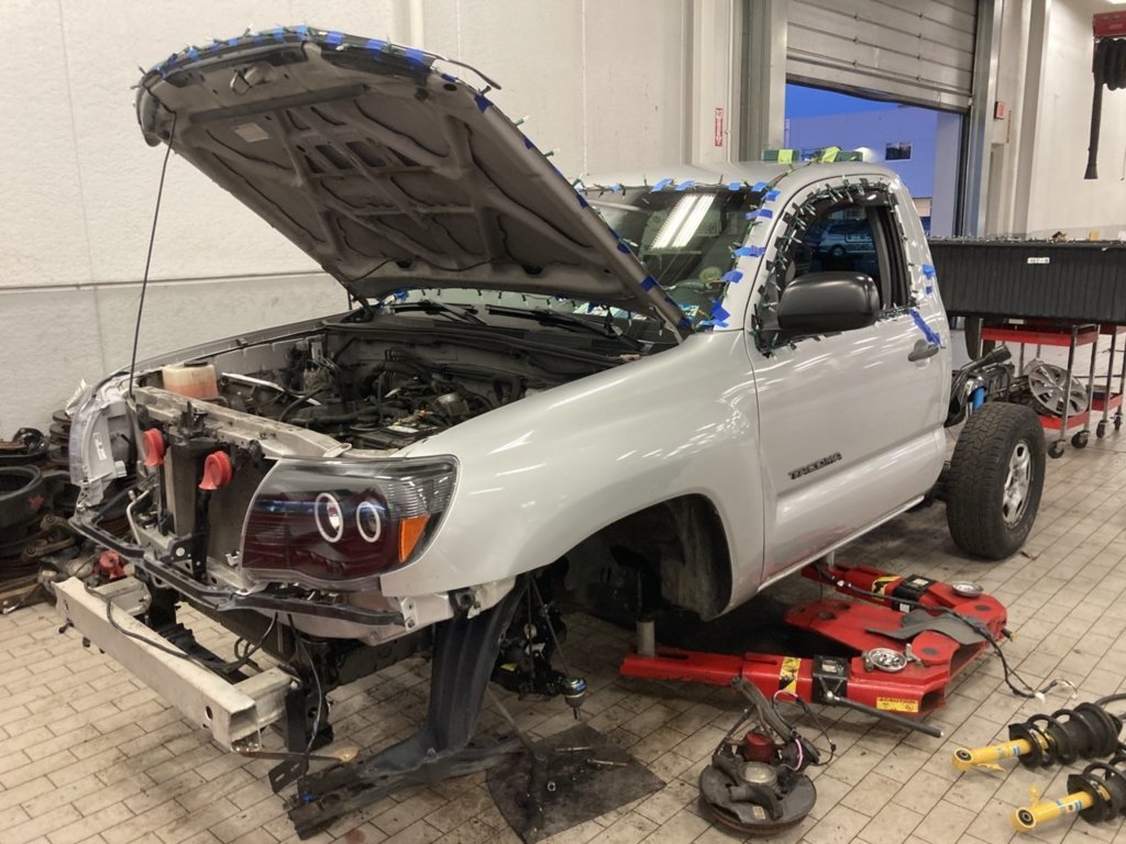

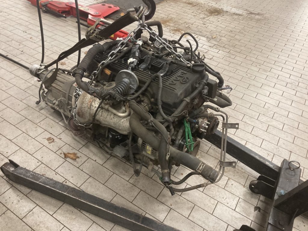

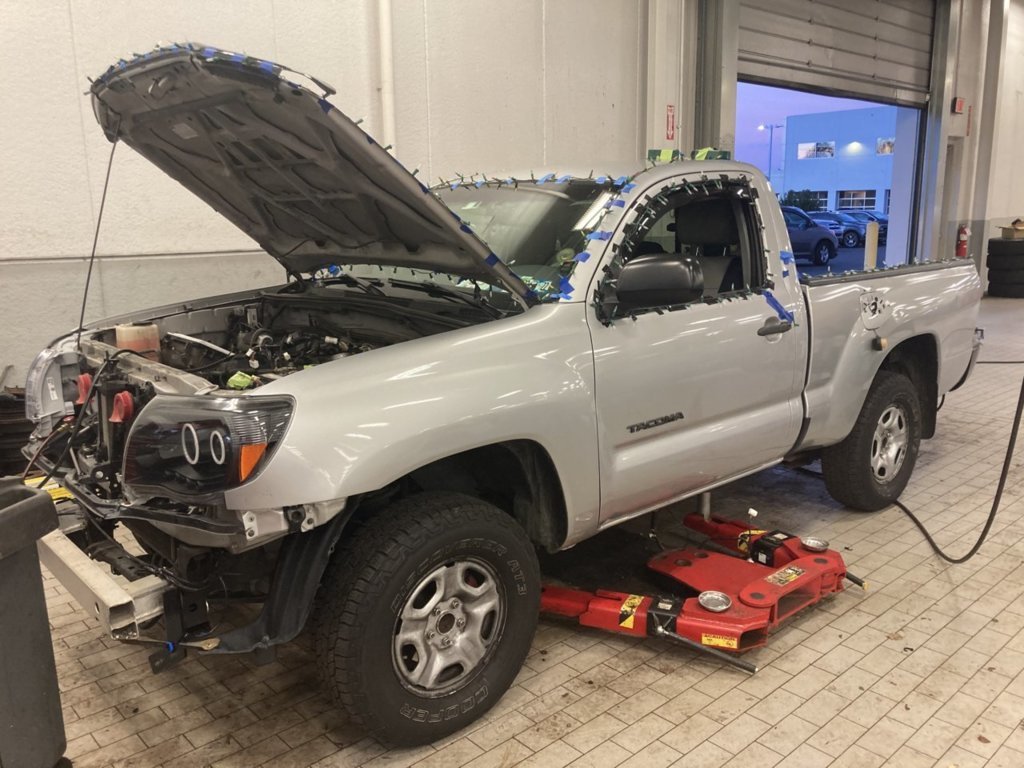

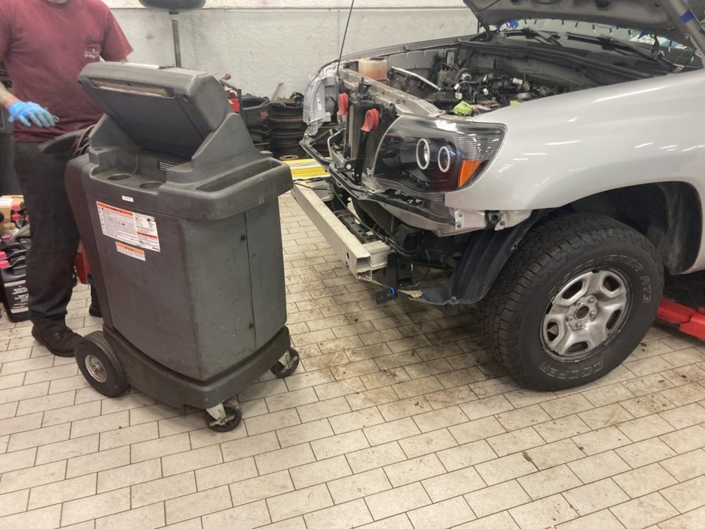

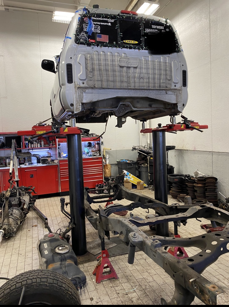

    Day one of the teardown; A/C system being evacuated of refrigerant...
    4C0649A1-3DE9-471E-9DF1-36A527170EF3.jpg DC78F907-EE5C-48FE-AB54-6567D4A23724.jpg

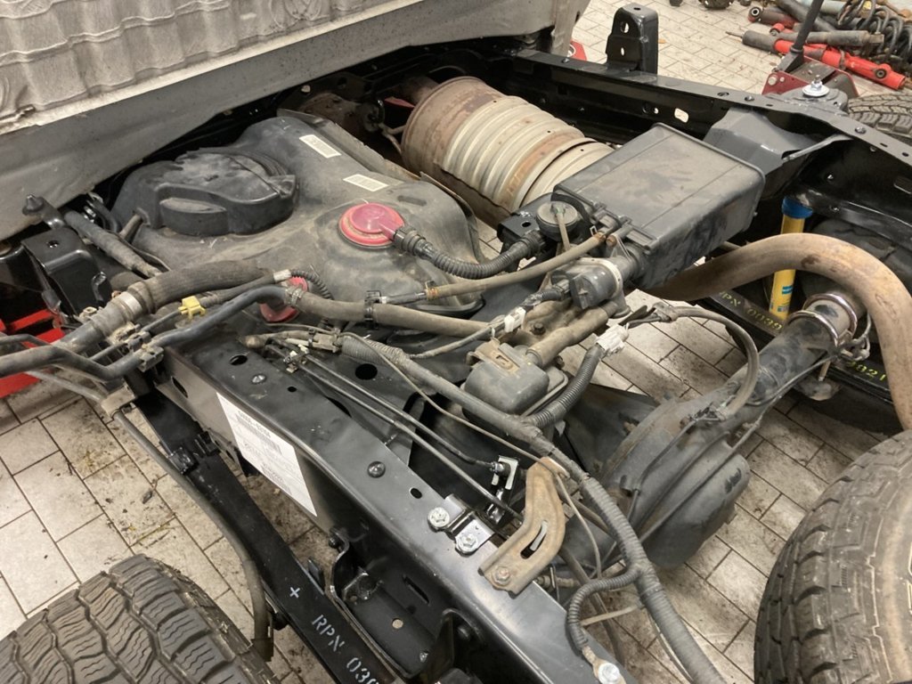

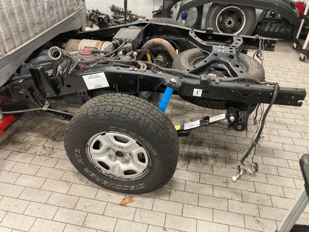

    After the body was mounted on the new frame; At this point, my truck was no longer a 2-ton jigsaw puzzle and actually resembled a truck again!
    78BDBFE9-6C99-4686-93D4-D3DD6773BAB7.jpg 4E81F870-76B4-48F4-AA2C-A9125732642A.jpg
    I paid a little under $1,100 out of pocket to get some stuff replaced that was easier to access when the truck was taken apart, including the engine mounts, water pump, and the rear shock absorbers; I went with Bilsteins, which can be seen here...
