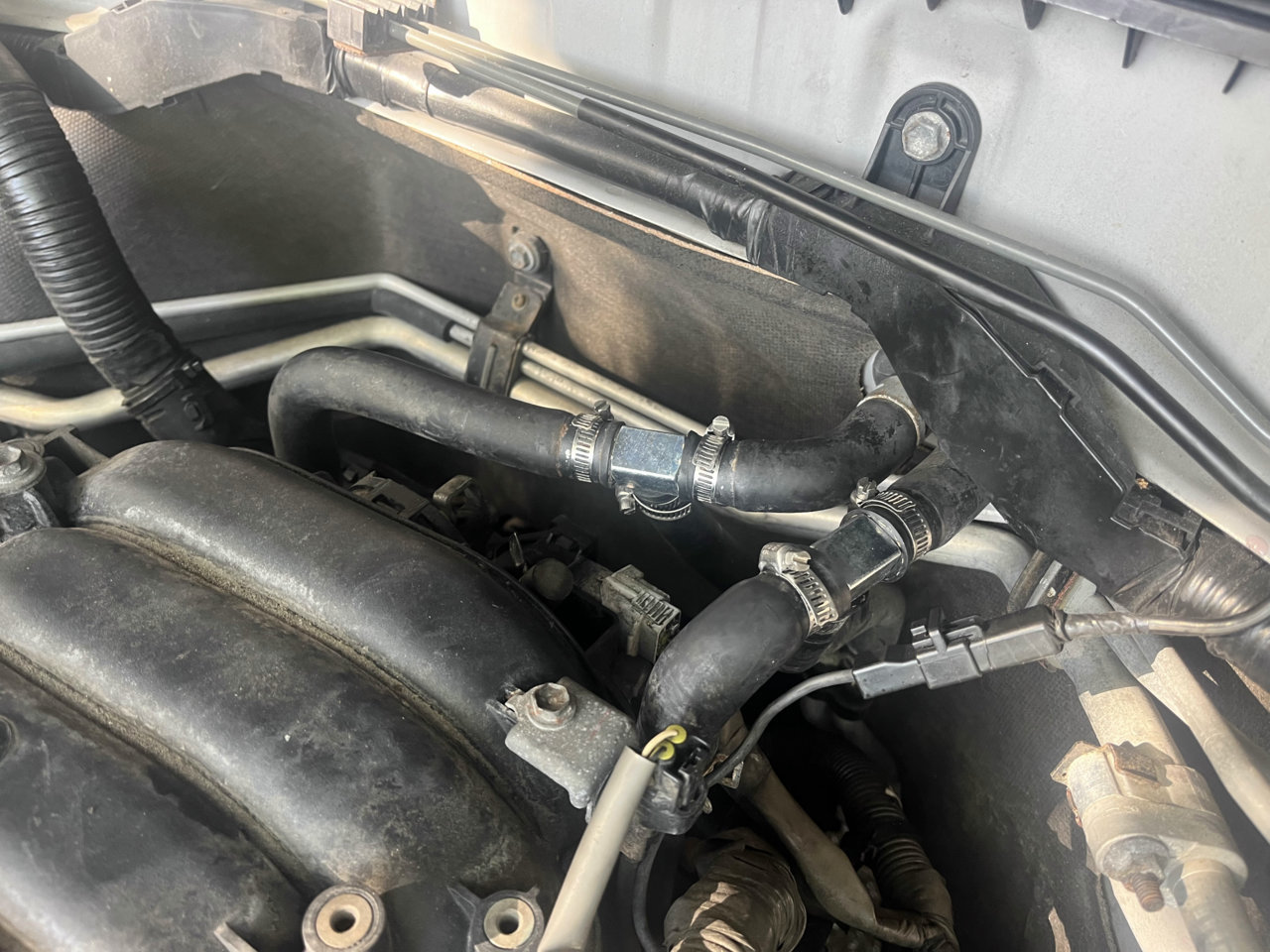

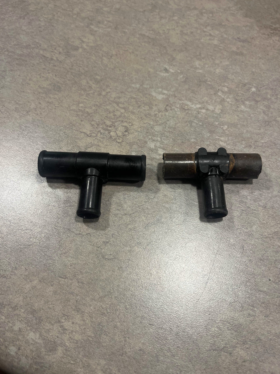

    Yesterday my Stainless steel heater T's came in and i swapped out the old plastic ones that were on. One of them had some coolant residue so i suspected that it was going bad. It was lol. Luckily caught it in time and got them swapped out. The OEM clamps dont work so some good ole hose clamps i had in the garage did the trick.
    It looks like the valve cover gaskets are weeping but when i detail the engine bay this weekend i'll confirm that.

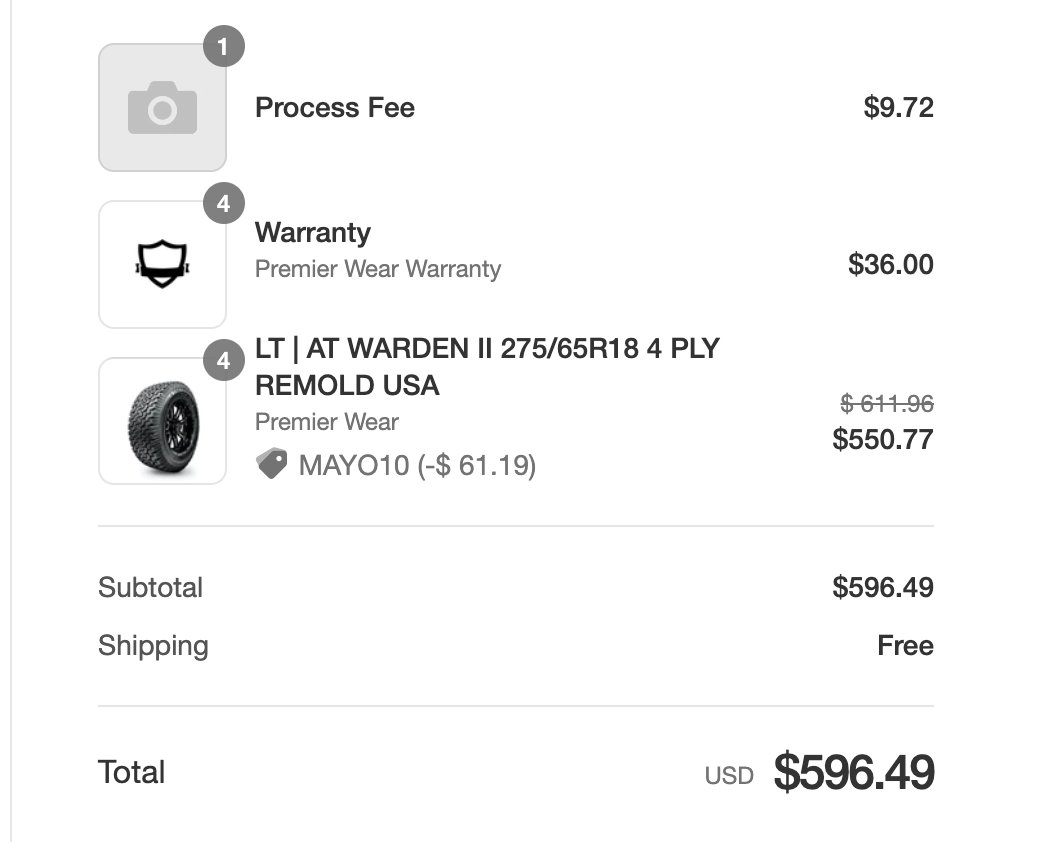

    Got some new rubber coming for the land cruiser. I hear nothing bad about remold tires and these will be warrantied so i aint got nothing to lose sending it. Also, this'll stop me from modding the LC since it'll be on stock tires still lol

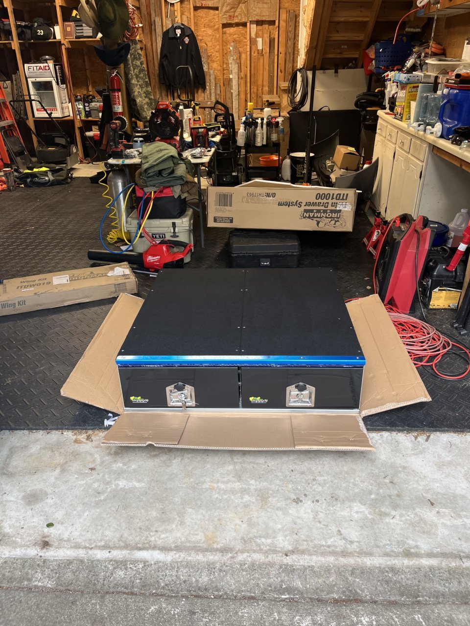

    Also: Drawers have arrived! im at work until saturday so it'll have to wait. Looks good tho

    our heater t's let go on the interstate going about 75..... good call changing them out. I had the normal hose clamps not work so I had to switch back to the OEM spring style. funny how that works lol

    Seeing how the Passenger (the one that normally breaks down) was already breaking into pieces with me taking it off the hoses was super cheap insurance.
    No leaks yet but i'll keep an eye on it for sure.

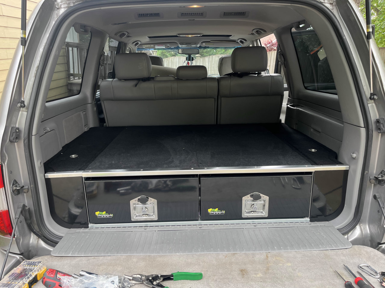

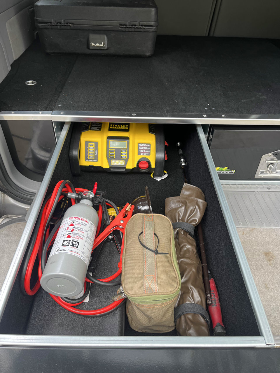

    Also got the Ironman 4x4 drawers in. If the instructions were clearer it'd be a 3/10. Instead it was a 5/10 lol. It was still easy enough and having everything organized is nice.
