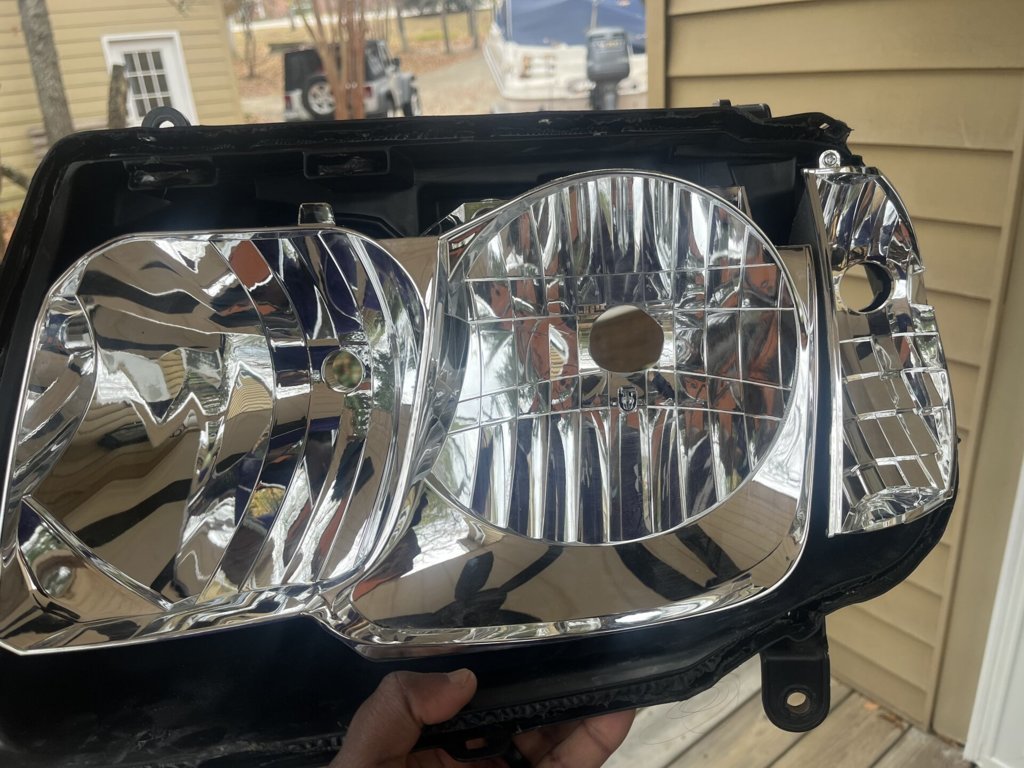

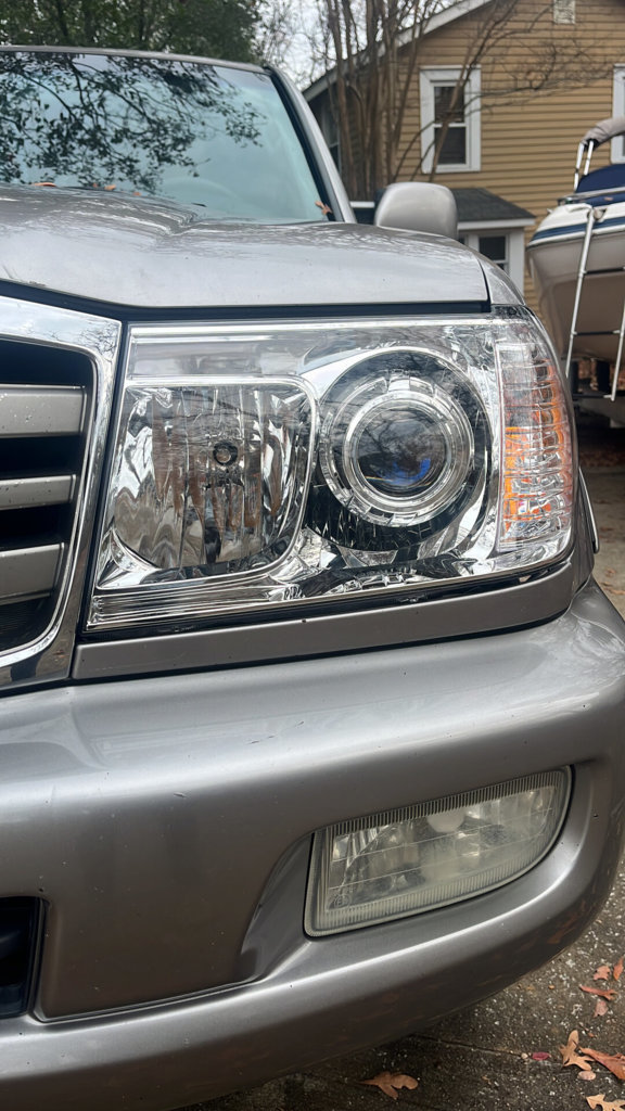

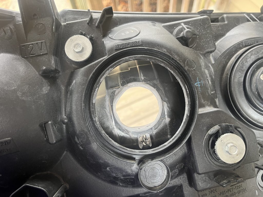

    Nothing too new with the build so far, been driving it, fueling it and thats been it. I decided i wanted to improve upon the awful output of the OEM halogens. I've done retrofits on everything i've owned so far so it was bound to be this rigs turn. I bought some spare headlights to run so i could take my time and knocked it out in a weekend. Love the OEM+ look and the output is night and day.
    I ended up running the Morimoto 2.0 Bi-Led Projectors as they were plug and play. Just have to make the hole bigger so you can fit the much bigger diameter projector inside
    After that you use the washers/isolators that come with it and slap her in. Wait til night fall to check the horizonal alignment before sealing it all back up. Final results

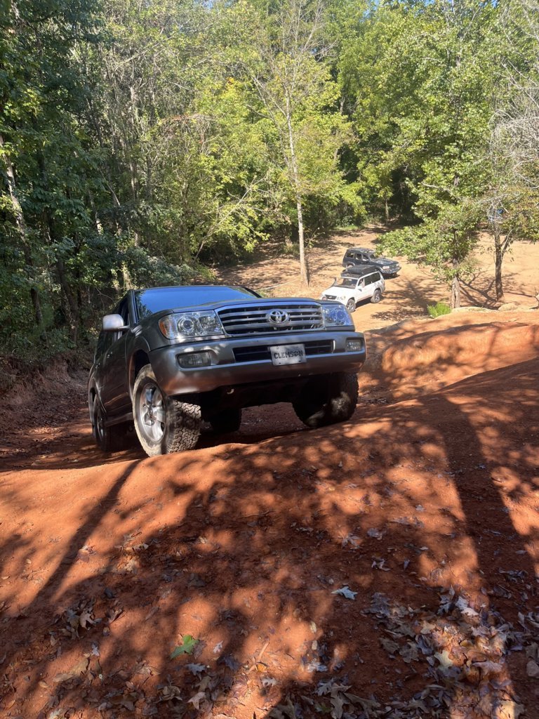

    This was back in september of last year btw,
    Went to Gulches yesterday with a few of the guys from the club.
    Bone stock rig and she did very well. Most of the blues were uneventful besides the Clemson Trail. Uphill with lots of holes that required me to give it the beans from time to time lol.Only damage was a broken 7 pin mount and the steps [​IMG]
    She did great and I feel confident I don’t need to mod this rig at all. ATRAC is absolutely goated.
    Next is URE sometime later this year hopefully

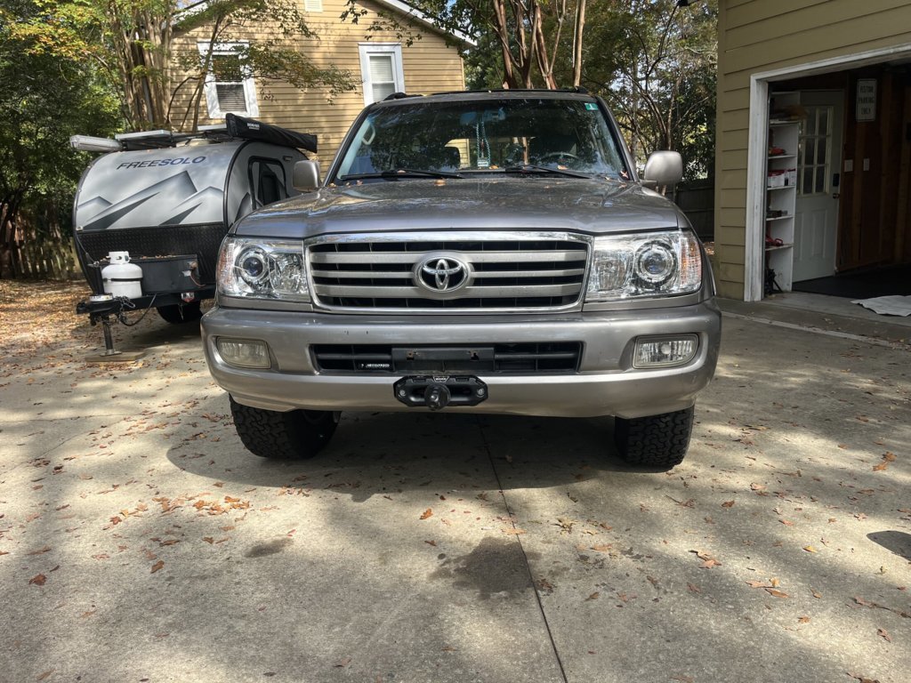

    Got a smoking deal on a warn winch from a buddy so i had to slap a winch on the ole girl.
    Got the TJM winch mount installed and some
    3/8” synthetic line from TRE (tactical recovery equipment)
    Factor 55 Thimble because why not and the Warn Fairlead for good measure.
    Everything mounted up easy and had to just cut the center out the crash bar mounts.
    Got it wired up easy enough and everything fits like the same.
    Next is some step sliders.

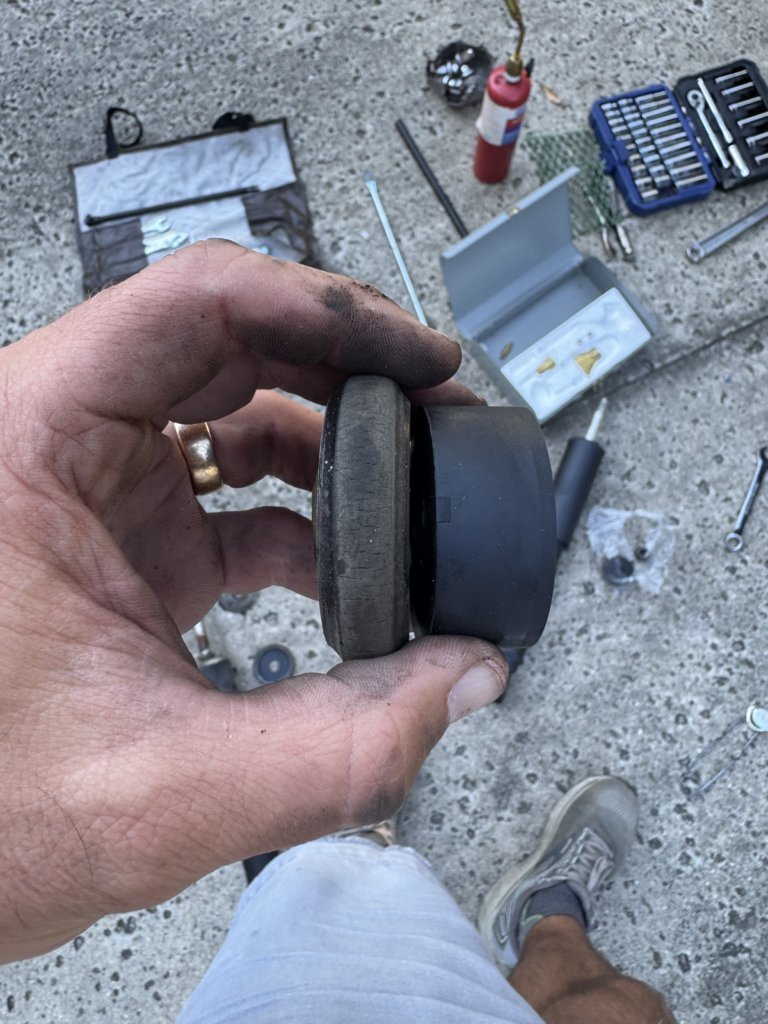

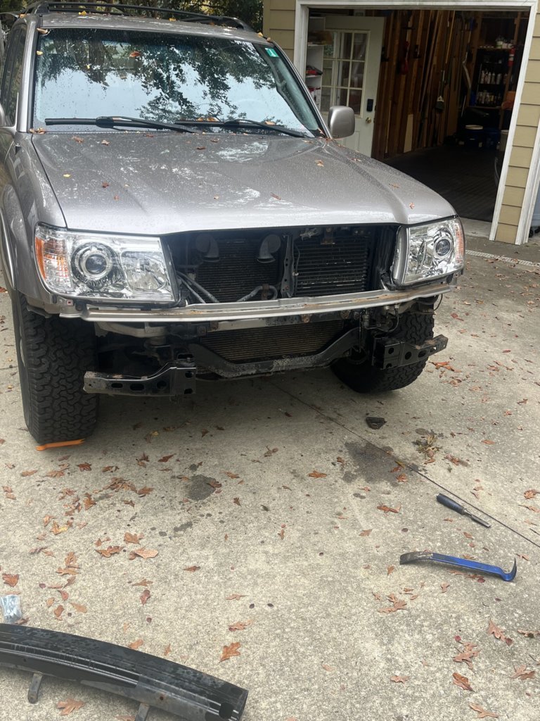

    A couple of days into the new year i noticed my power steering going out. Turns out a seal blew out on the passenger side and she was down for the count.
    Got it towed to a local shop, Ordered a brand new OEM rack (~650$) and an alignment later she was back on the road.
