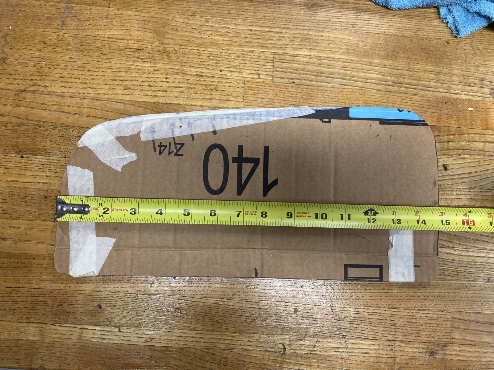

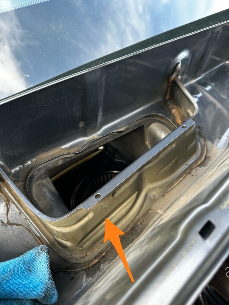

    Here is the template I used to cut sheet metal with. The fold is where I bent the metal and adhered to the firewall with "GE Sealants & Adhesives GE5050 Advanced Silicone 2 Sealant." I then used the two factory holes to mount the metal to the truck duct. If you look carefully you can see the matching holes in the cardboard. IMG_3701.jpg
