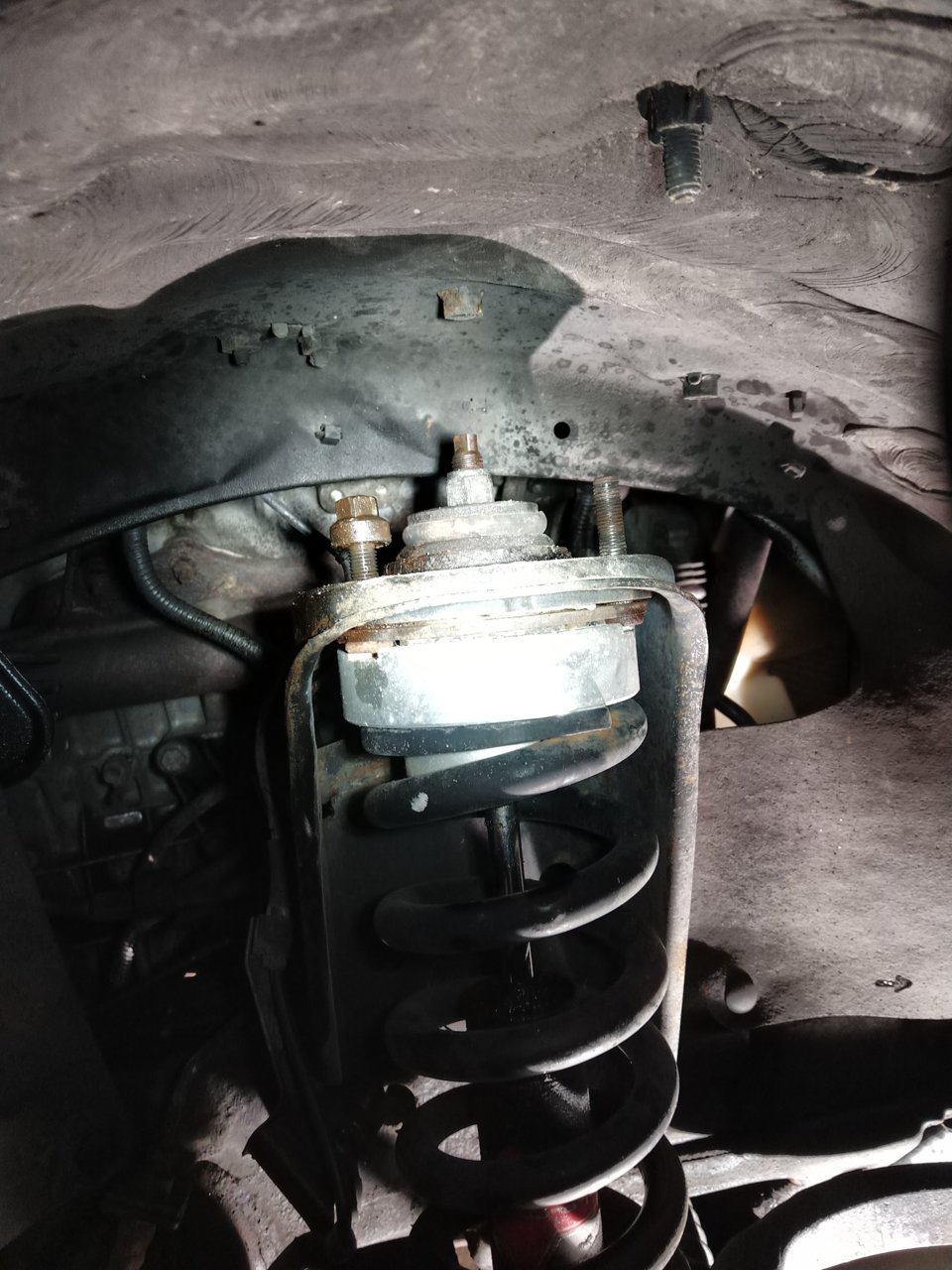

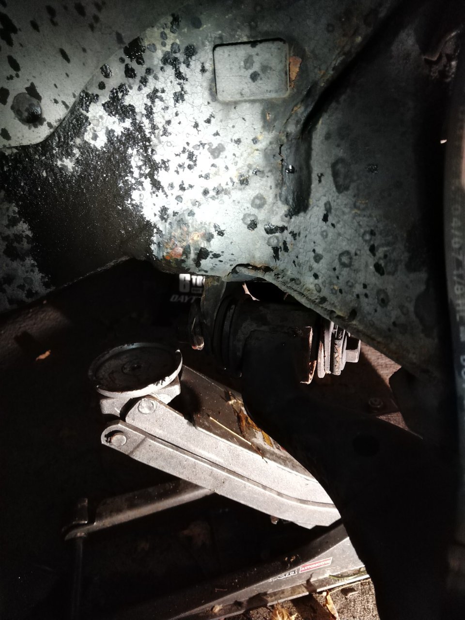

    I bought this truck in 2019 and it seemed very clean at the time. I have since moved to the northeast and the salt here is the worst.
    I was replacing my shocks (since it was still running the originals) - the rears were annoying but pretty simple...
    I went to do the fronts and I literally can't undo any bolts (I have impact tools, etc). everything is rusted solid from just 1 year of winter salty roads. on top of this, the rubber coating Toyota applied to my frame seems to have been applied over dirt and rust and is just flaking off... so I'm fixing that while I'm under the truck.
    what started as a shock replacement has turned into replacing the entire front end (including tie rods and axles). even the shock mounts have failed (the studs pulled out).
    marginally annoyed in both myself for lacking on the maintenance (I did the brakes in 2020 and they were like new - still shiny silver) and also annoyed at the dealership - they allegedly did an alignment when I bought it but there's no way as every ball joint is bad.
    sorry for bad lighting. been working on this all day (just the passenger side!) I'll take better photos tomorrow when I start again.

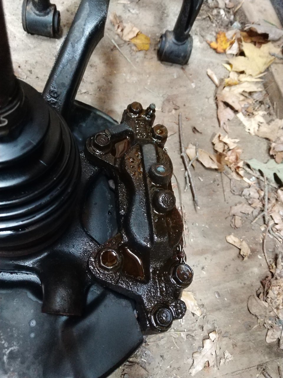

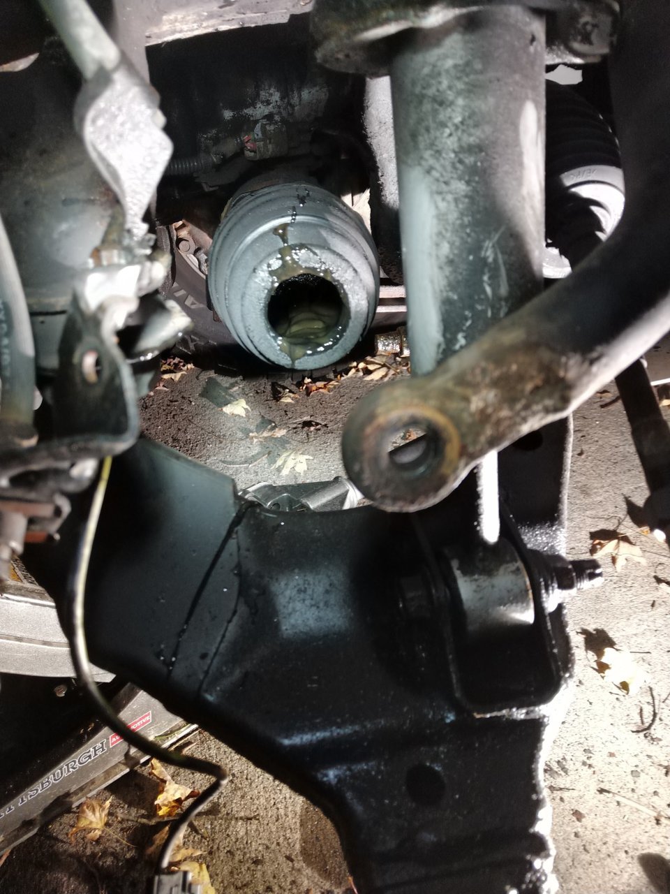

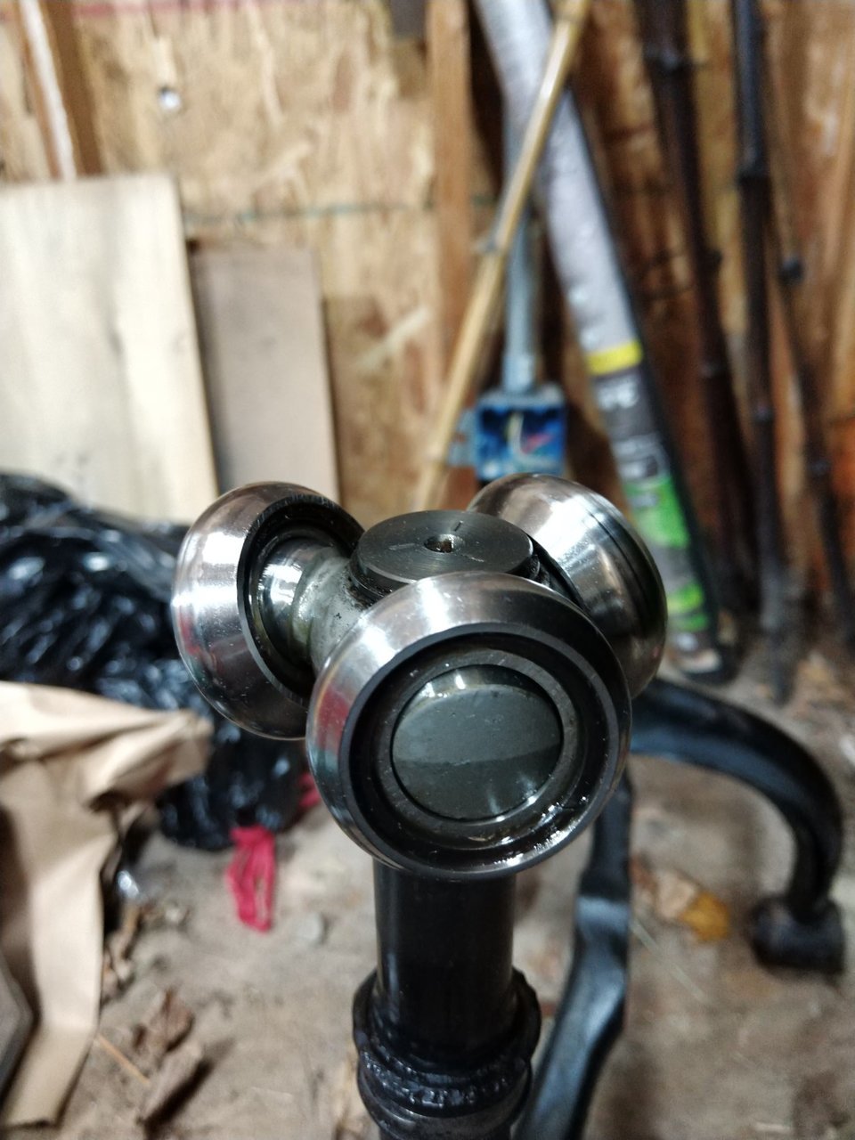

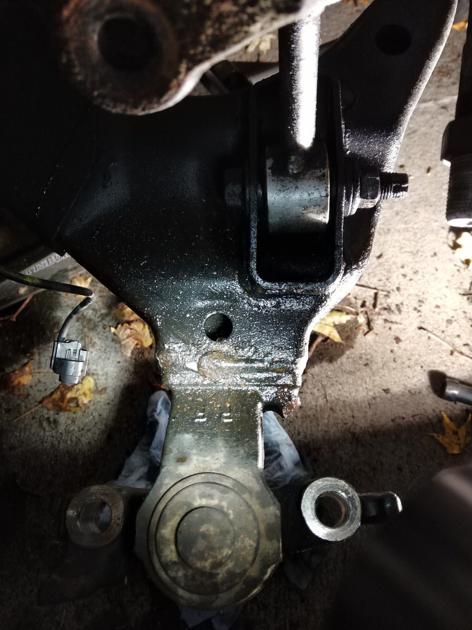

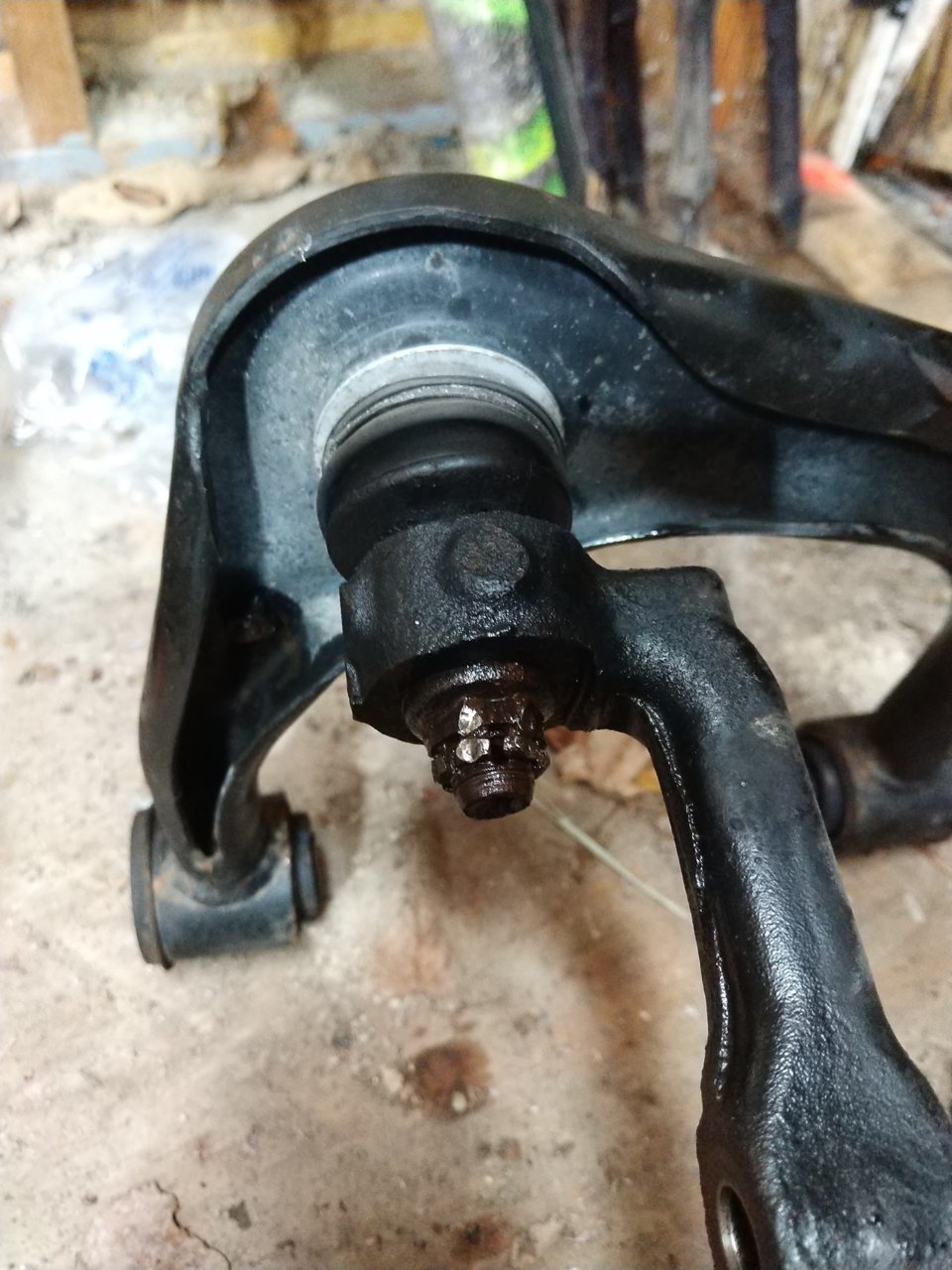

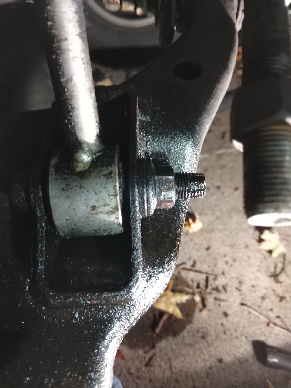

    here are some more photos of the carnage... I dragged the hub/knuckle/etc into my shed with bright lights. turns out the CV is probably fine and I can just rebuild it. I'm soaking everything in PB blaster overnight to see if that'll help. I will likely cut off the bolts/balls (since the only parts I'm saving are the knuckle and caliper).

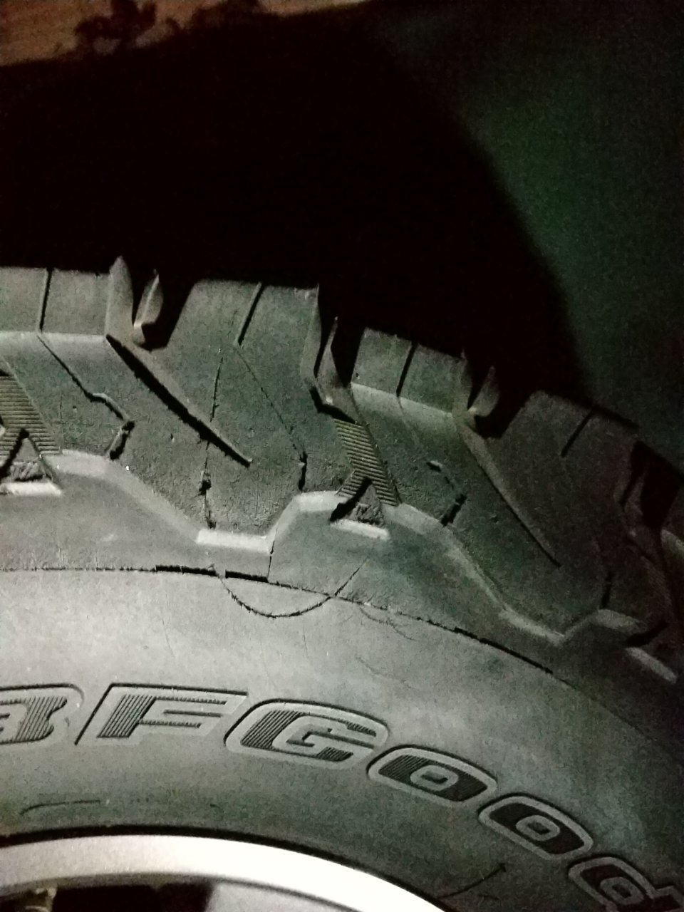

    another crazy thing I noticed is there's a big circular gouge in my tire. hoping it's just cosmetic! these are BFG AT TA K02 which have thick sidewalls.

    Thats a shitty discovery. Hopefully there is enough good metal left to salvage the frame as is. When i see any post that states the dealer applied undercoat is flaking off, I know whats coming next.....
    I was lucky. I had a tech that loved doing frames ($$$$$) and knew where to peel off the undercoat. One tap with a small hammer (his....not mine) and my new frame was on the way.

    What really sucks is I went to the dealership before the deadline on frame replacements and they said everything is good as it already had the undercoat applied in 2016. Sneaky!!

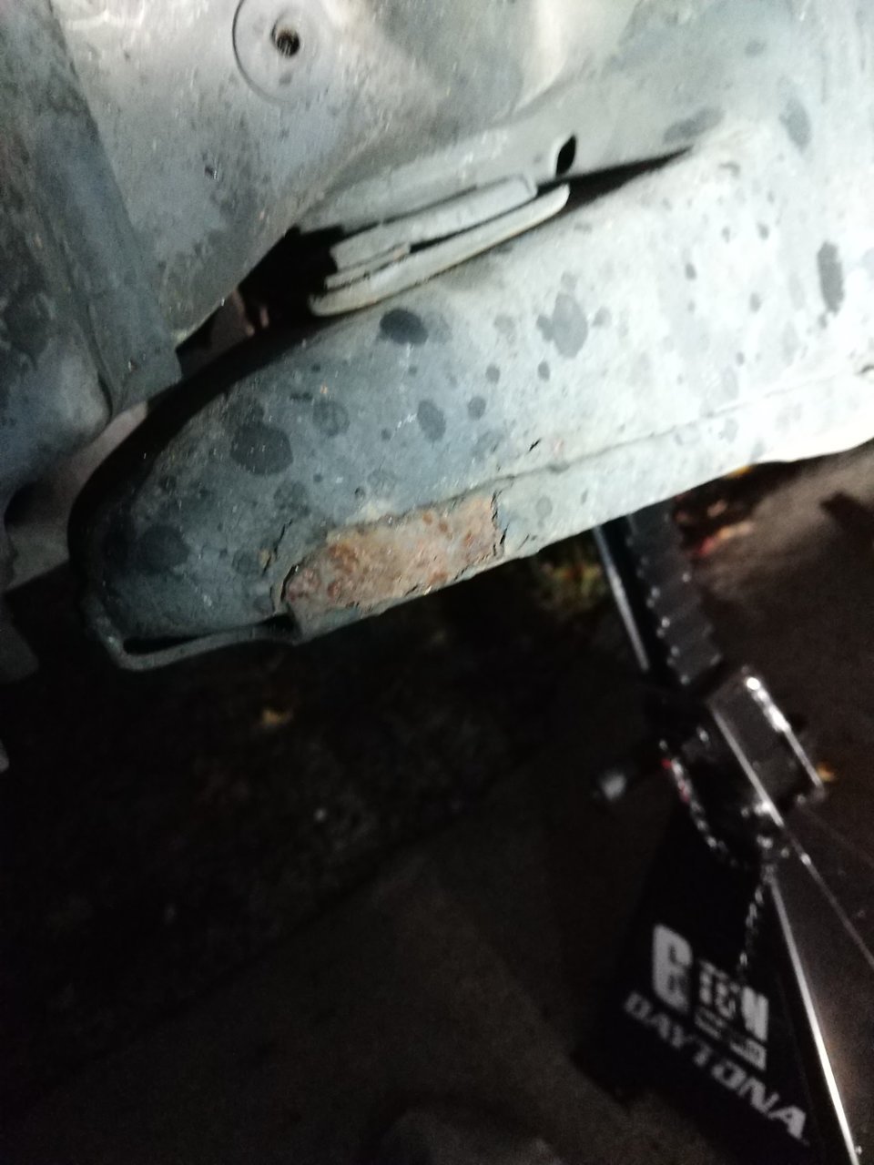

    Crawl under there and have a look at the INSIDE frame rail under the drivers side door.
    Next to the converter, that’s the spot that normal rust through first. A little tippy, tap, tap with a small ball peen hammer will let you hear about all you need to know.

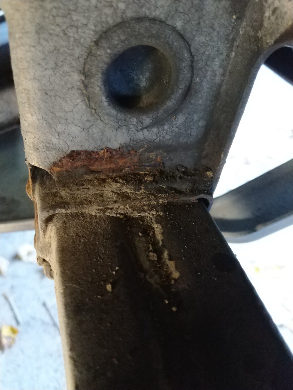

    I hate to say it, but as a lifelong resident of the rust belt, that truck is actually in very good condition - especially for a 2007! I've seen three- and four-year-old trucks up here that are not taken care of and they're in worse condition.
    As for you frame, unless you have a dime size hole completely through it, you would have passed you frame inspection. From what I could see in your pics, it would have passed. More pics would help though.

    I'll take better photos today... still trying to get things dis-assembled! and I still need to check the "bad spot" by the catalytic converter.
    about mid-frame (just in front of the rear wheels) the bottom lip of the frame is de-laminating with rust. I'm not sure if this counts for Toyota's standards, but if it were 100% up to me, I would have replaced this frame. I'm confident that it's structurally sound and I can weld if needed.

    - found a very corroded area by the catalytic converter on the inside face of the frame

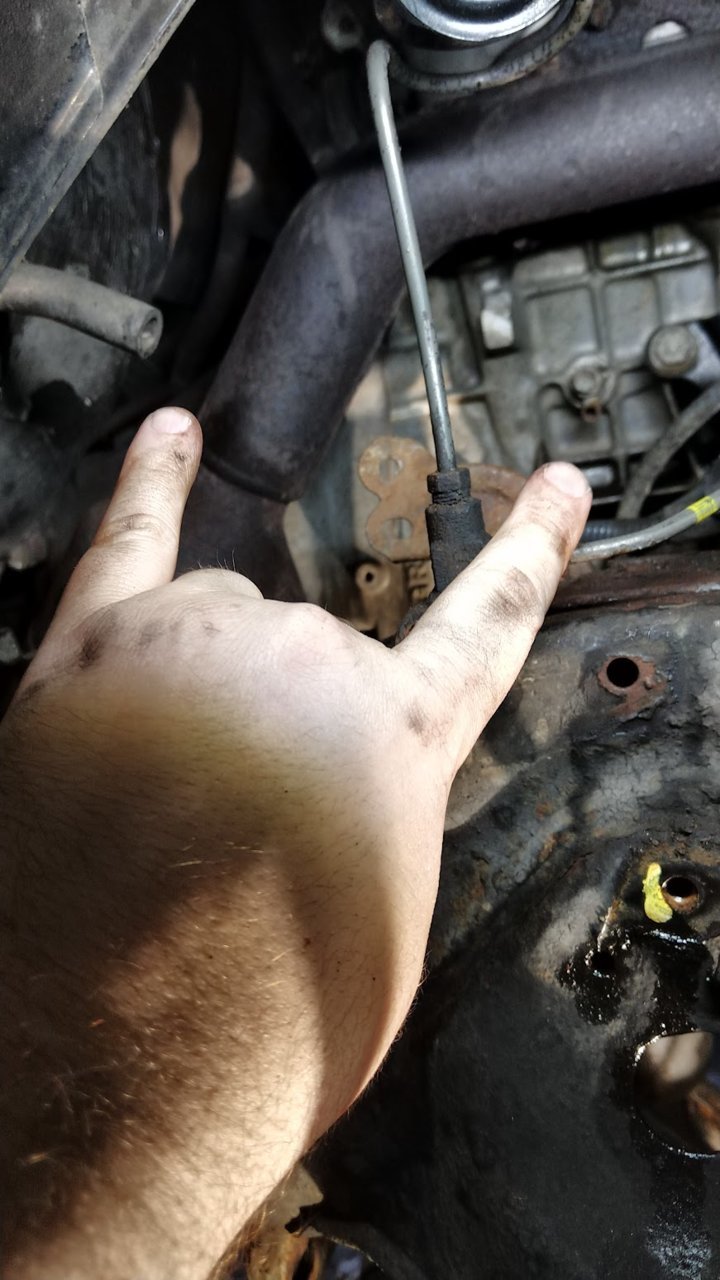

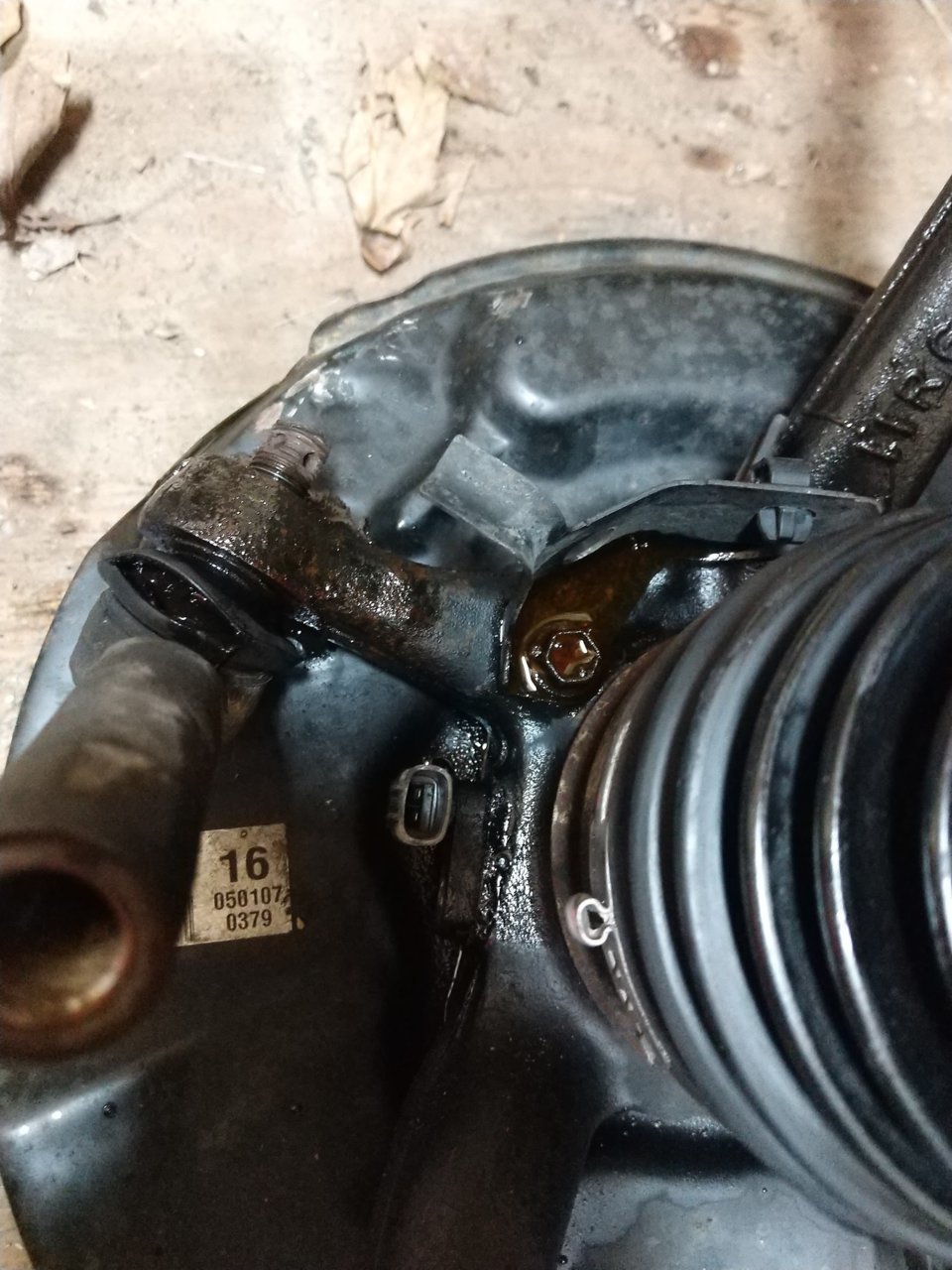

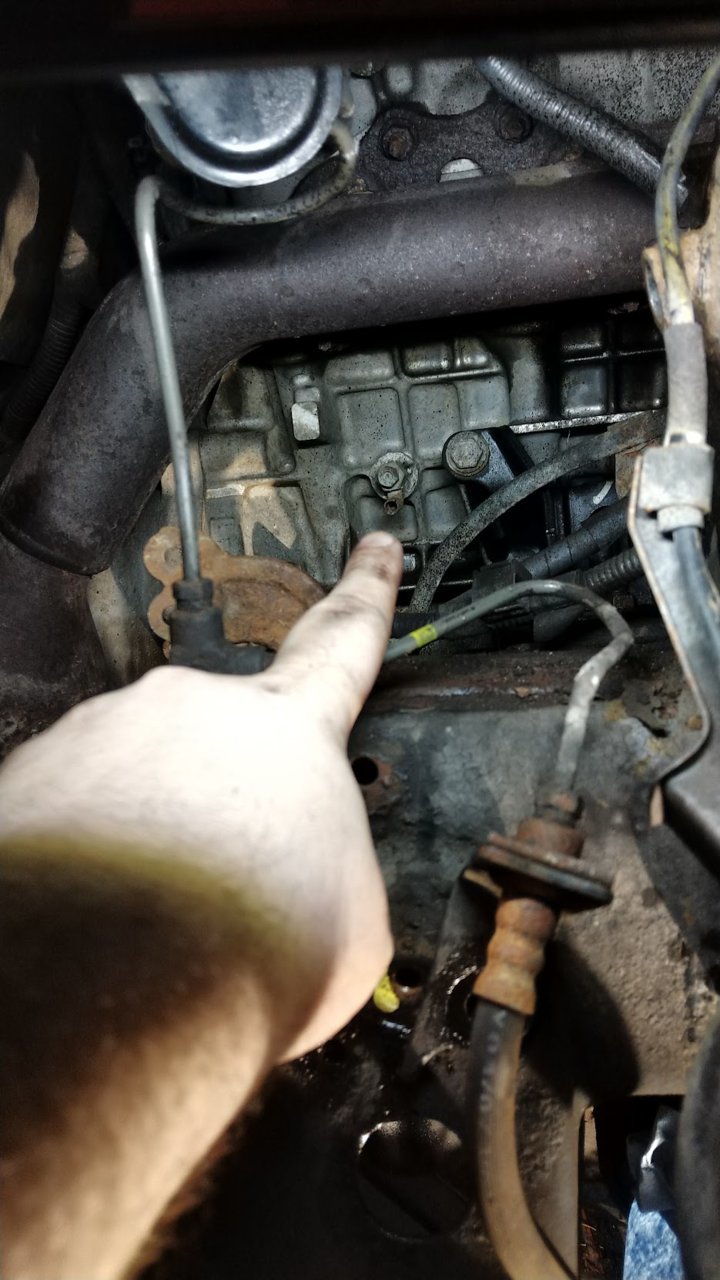

    - what are these things I'm pointing at? (photo below) this is the passenger side. I assume one is the AC water drip line - is the port in the engine block important?
    - how are you supposed to remove the left/driver side upper control arm bolt? it bumps into the frame and lines! do I have to remove the lines? my bolt does not face forward like the one in this video... my bolt faces the interior of the truck (the nut was facing forward) - I was going to cut it off and install a new one facing the other direction (installed from the front of the truck)

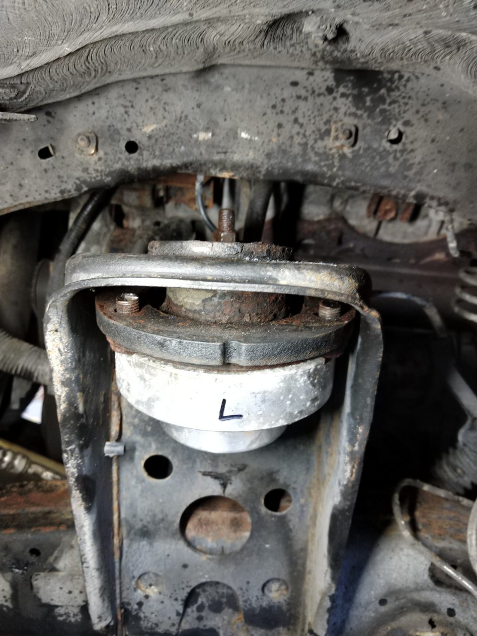

    More fun: top mount bolts popped their spot welds so I had to cut them off to get the shock out. Can't reach the back one without bigger cutting discs. Cut the top of the shock instead (it was shot anyway).

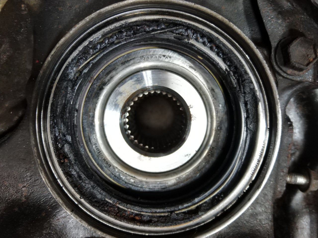

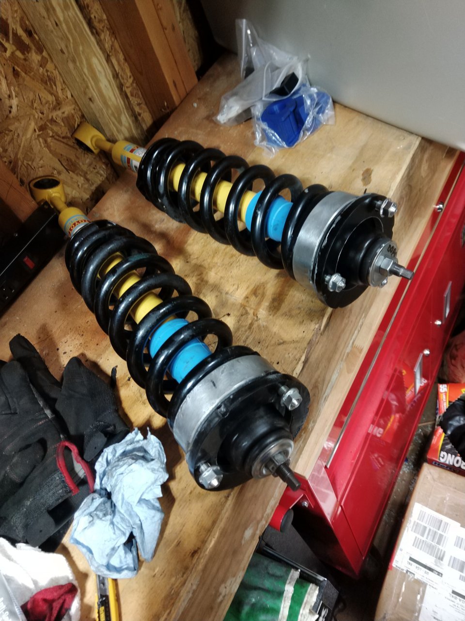

    rebuilt the shocks.

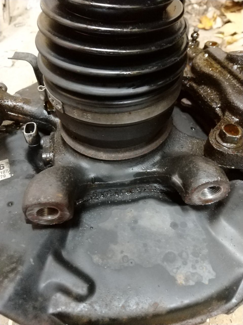

    the seals in the knuckles look like dookie! I ordered replacements (National #710573) but is there any weird trick to installing these?
    my wheel bearings are quiet/no play
