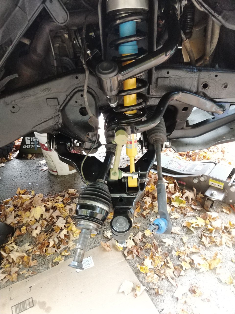

    The parts you’re pointing at are the AC drain (pinky) and coolant block drain (index; there’s another one on the driver side). Most people never use them but if you want to do a complete coolant flush (and not just the radiator), that’s how you get the rest of the coolant out

    AC drain line yes, most people extend it sop it doesnt drip onto the frame, the other engine thingie, Ill have to look tomorrow. Also, looks like your seal retaining spring is shot, helps hold the "cup" shape of your seal, but yours looks elongated...

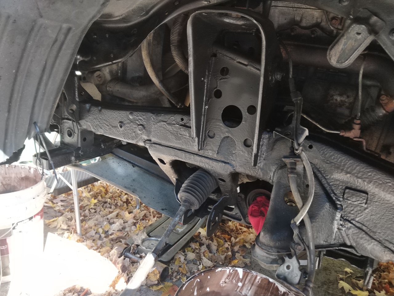

    I've fixed the worst of it, but chunks of the undercoat popped off to reveal badly rusted frame which I had to grind down and wire wheel. I've applied truck bed liner and will shoot a film coat inside the frame.

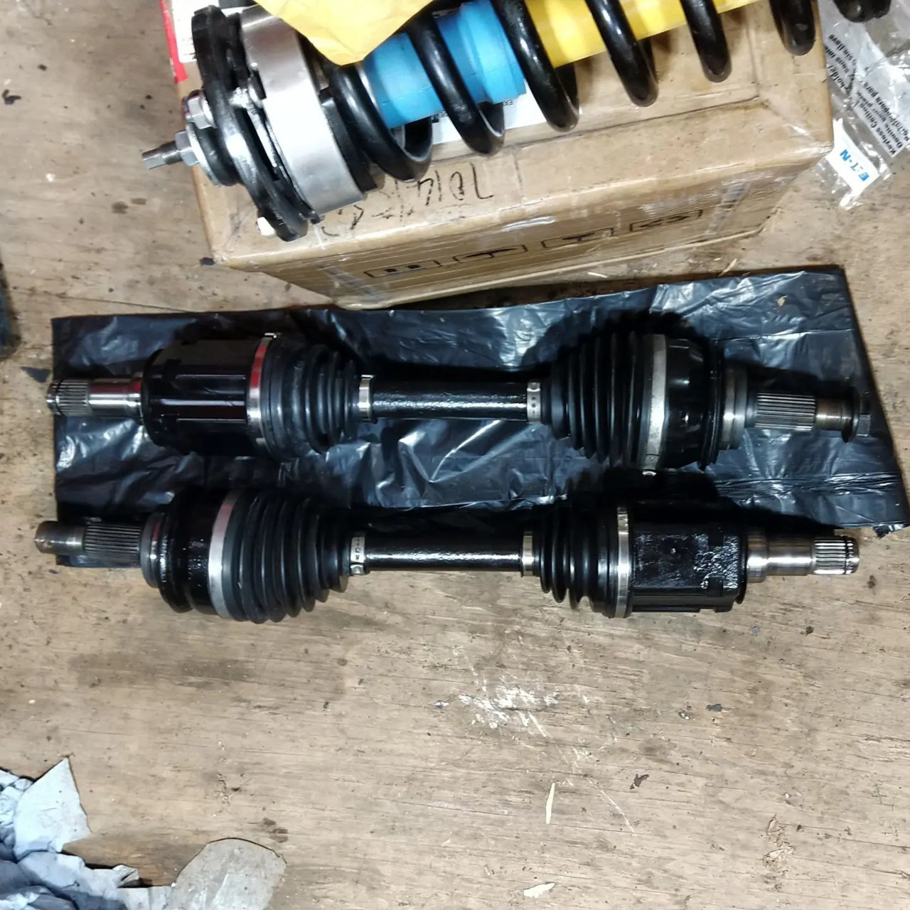

    Hoping I can get things put together tomorrow. Still need to clean and rebuild brake calipers but I rebuilt the axles today.

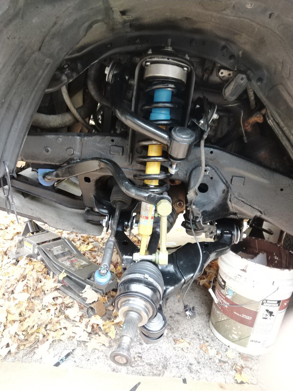

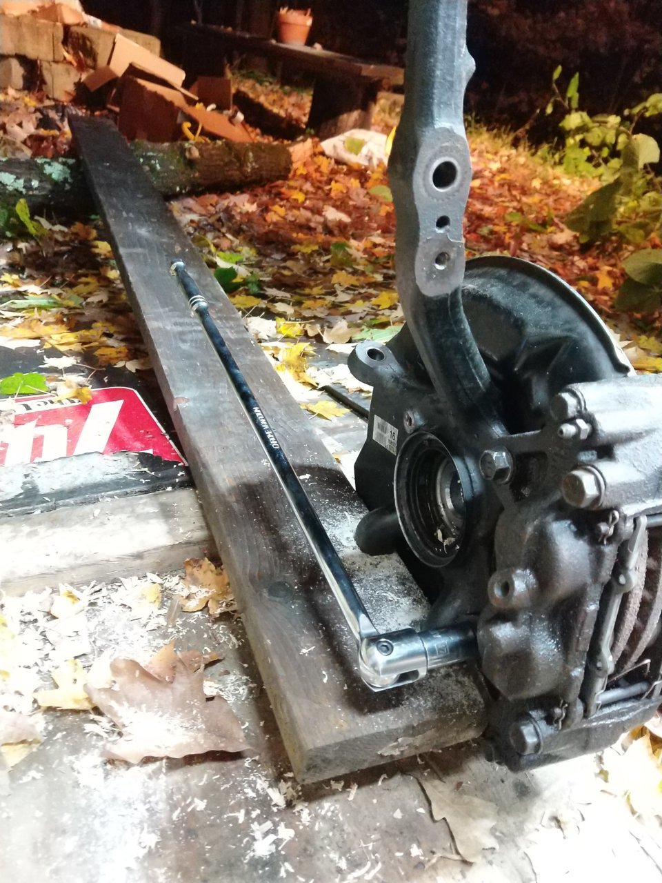

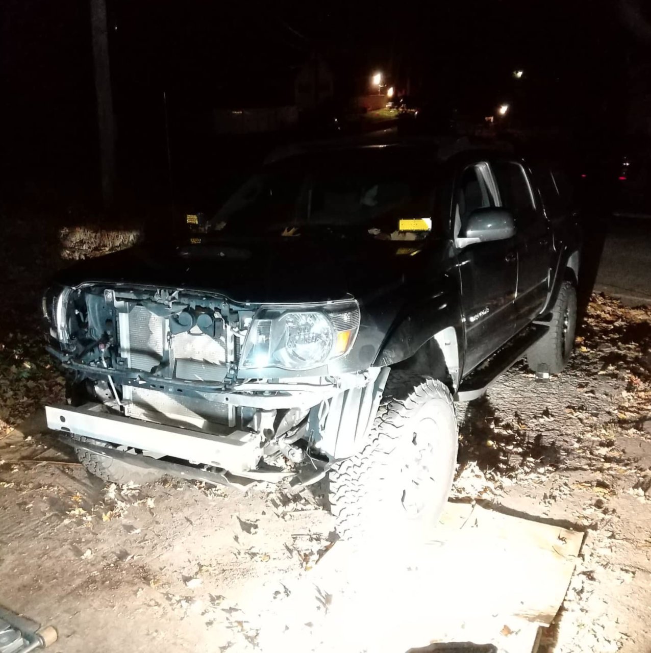

    Most parts installed. Repainting and rebuilding knuckles and brakes. The little junction on the frame was totally rotten. Going stainless steel.
    I did the sway bar relocation because two of the nuts broke off inside the frame... and I probably needed it anyway. Luckily Toyota put access holes right where the broken nuts were!
    Make fun of my spacer lift but it came this way!

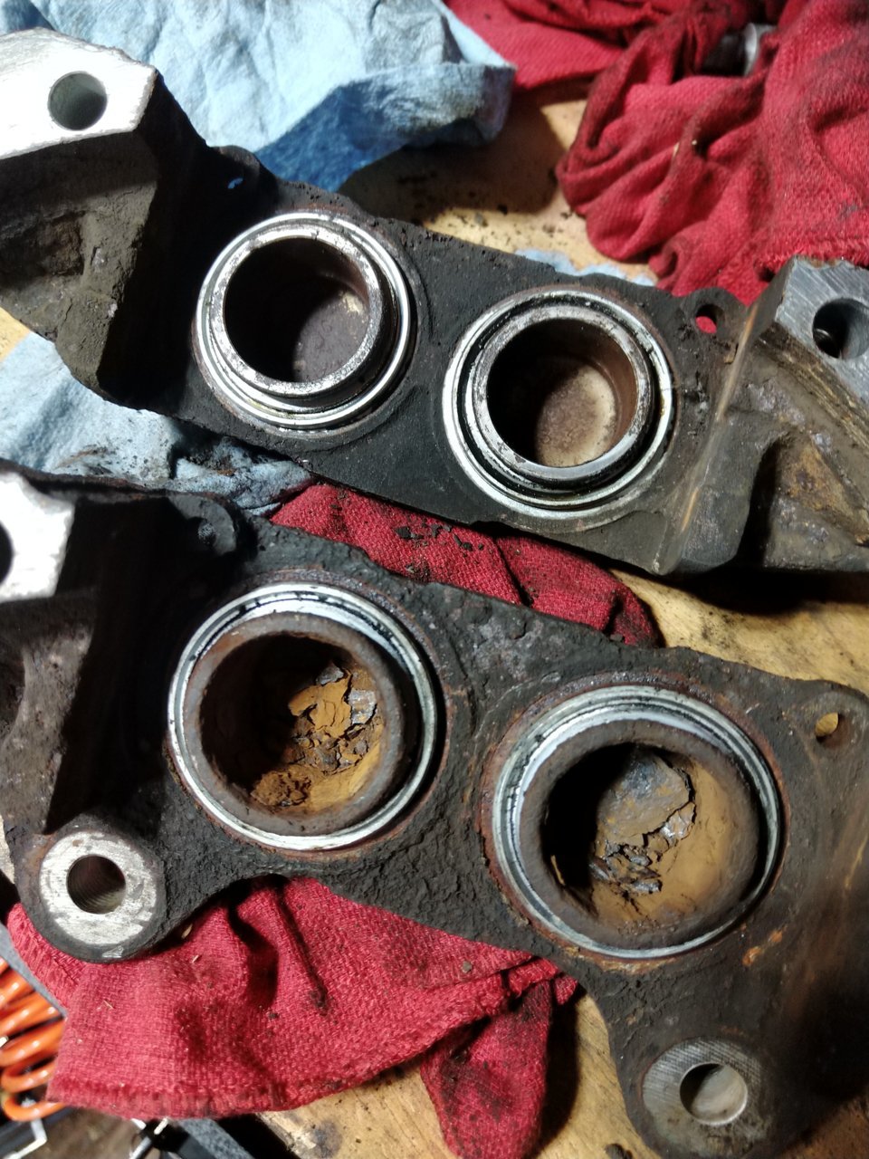

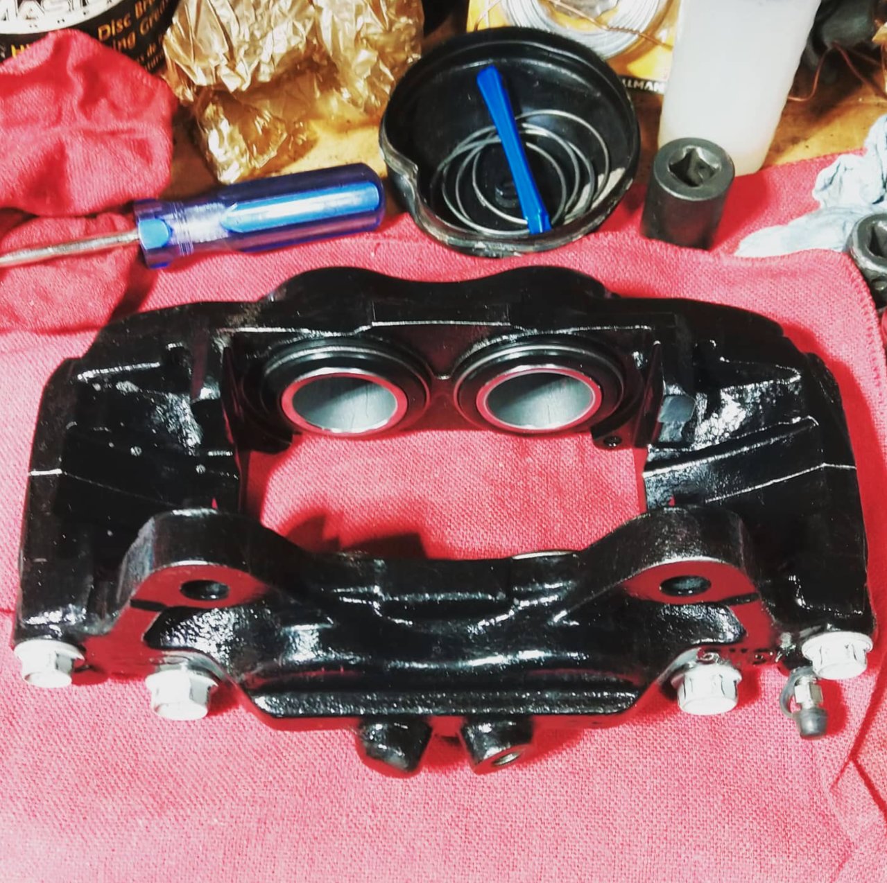

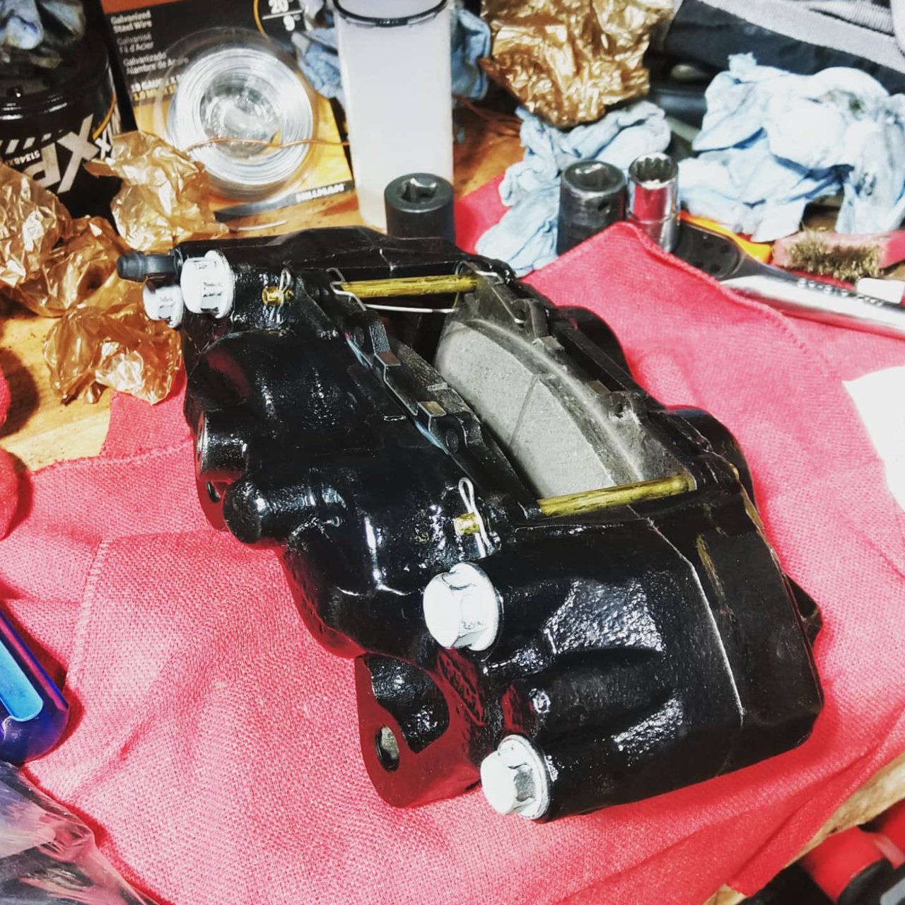

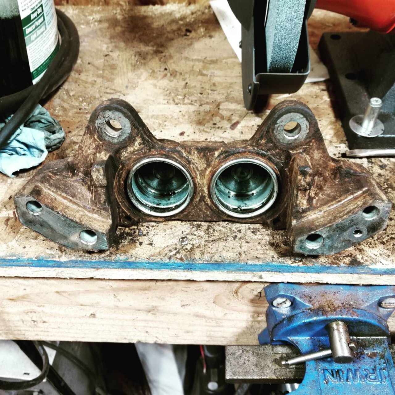

    went with stoptech/powerstop for the front brakes. refurbed my original calipers. huge pain in the butt with all the rust and grime buildup. used a combo of oven cleaner and naval jelly and a lot of wire brushing.
    got everything back together around 11pm.

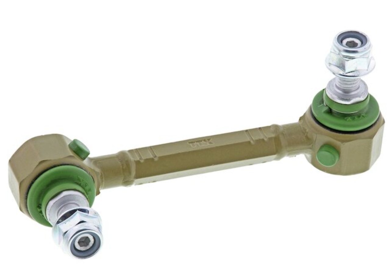

    Good work. Your 07 Tacoma looks about like my 2013 4Runner. It sucks more people don't bother coating these frames when they're new to prevent this nonsense.
    What sway bar links are those?o_O

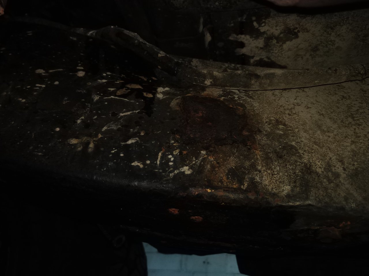

    This is the worst spot in that section. I can fix it.

    "Mevotech TTX" from RockAuto, I chose the highest quality part available which was these
