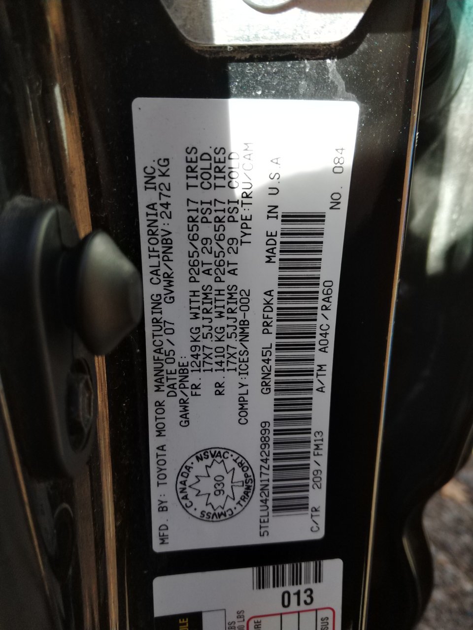

    Here's my door tag if it helps anyone decode what stuff I have

    I figured it all out: mine has the LSD and on-all-the-time A-Trac (no buttons to fiddle with it).
    I actually am having trouble finding oil locally so I picked up the cheap stuff at Walmart and will order nice stuff for the transmission and xfer case.
