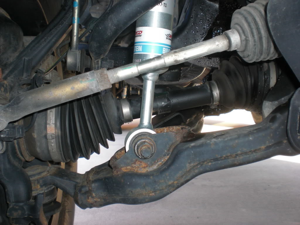

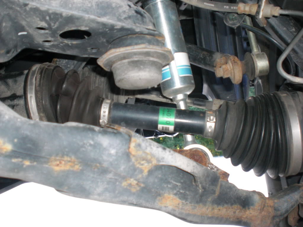

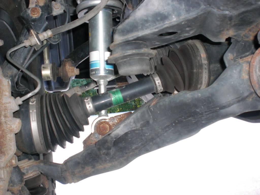

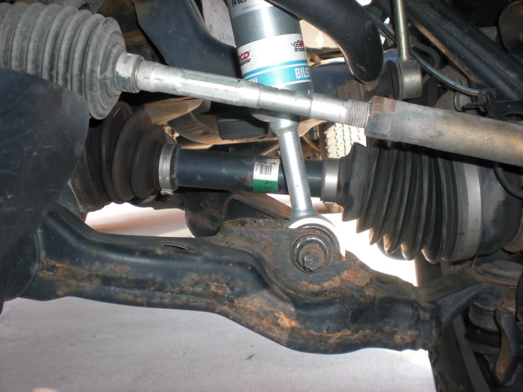

    Before:
    After:
    Not quite as good as stock, but happier than they were :)
