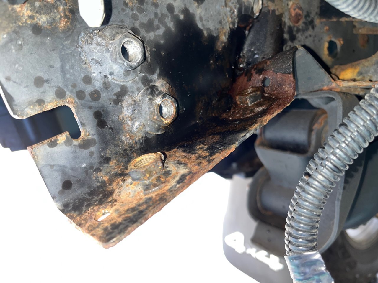

    Does anyone know what size these weld on nuts are for the hitch? They are welded on both the frame and the reinforcment plates.

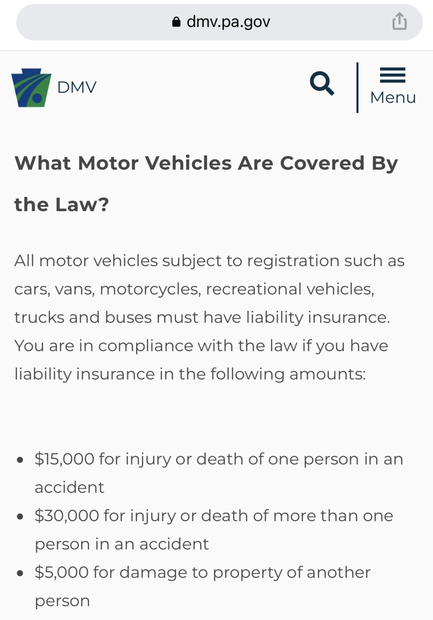

    Gotta hand it to the state -- figure out reasonable liability limits in 1927, and then just never update them again for the rest of time.

    I believe the bumpers are the same, but the mounting method is different. One mounts to a bar that's attached to the frame and the other mounts to the tow hitch assembly.
