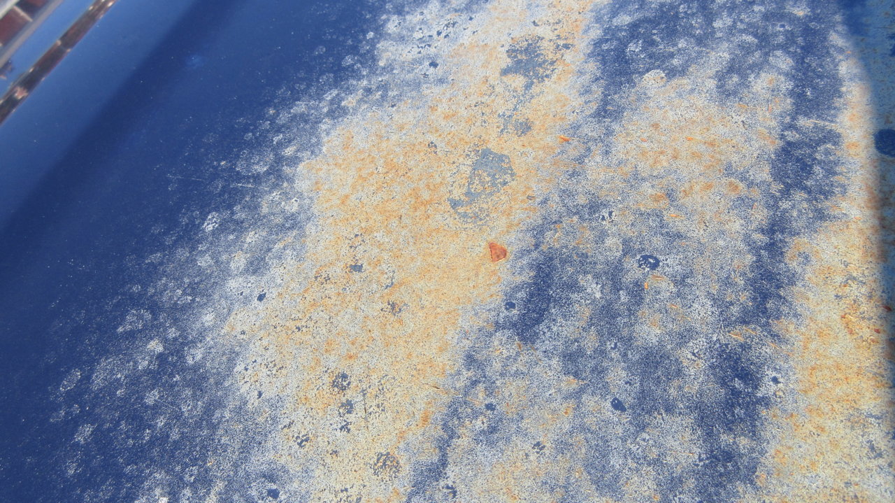

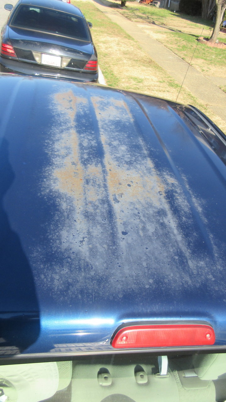

    I have a 2008 Tacoma double cab that is showing significant corrosion on the roof of the vehicle. Has anyone else experienced this? It's been a great vehicle with 155k miles so far. I hope it lasts another 155, but I am concerned that the corrosion will create a hole in the roof. See pictures.IMG_0027.jpg IMG_0028.jpg

    I had a less severe paint corrosion on my 2008's roof.. I ended up having it fully repainted.

    Happens a lot on many vehicles. The roof and hood are very exposed to the elements. They must be protected with regular washes and wax or they will get sun damaged. I would have it addressed so that it wont get worse.
    It could lead to a leak over time.

    Super common to see this stuff here in AZ with the sun being such a strong factor here... I suppose the only way to really fix it right would be new paint. I don't know much about painting but maybe a shop could sand it down, re prime and paint just the roof and blend it in to the pillars. Have no idea though.
    I suppose if you didn't care about looks you could always sand it down yourself and hit it with a couple shots of primer and call it a day.

    06 here with about the same mileage. I plasti dipped my roof.

    Roofs are thin, have it sanded down [or do it yourself] primed and repainted. Once it rusts through, you'll be fighting the rust monkey forever.

    Plastidip is a recipe for a small hole to allow water in. Sand the rust off and have a body shop paint it. Saw these on several 2nd gens I now wax polish twice a year and make sure to do necessary touch ups.

    I sanded mine before I covered it. Primed it, plasti dipped it with a few layers, put a clear coat on after that.

    Unless it’s a beauty queen trick or you plan on reselling it one day, I’d just sand it and paint it yourself eith color matched paint rattle cans
