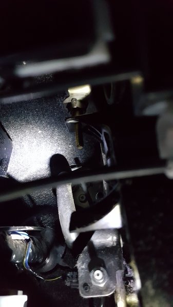

    A few years ago I lost the cruise on my 08. Coincidentally I found this green plastic piece on my driver side floor. The issue turned out to simply be a mechanical one located under the dash. I stuck a bolt in place of where this piece broke off and it has been fine since. It was located at a switch.

    Can you share more info about this? Where was this plastic piece located? Maybe send us a photo of the bolt replacement? Doubtful, but crossing my fingers that this is my issue. Haha.

    If you follow the clutch pedal assembly up under the dash, you come to a transverse process. It is there to engage with a switch that pushes inward. In the centre of that transverse process is a hole that the green piece covered over. With it snapped out the switch would fail to engage and the CC would not work.
    I stuck a long-ish bolt through the hole from the top to cover it so that switch would engage. It solved my issue, though I am not sure yours is the same. I believe my Cruise light on the dash was still lighting.
    Below you can see the bolt. This photo is taken up the clutch pedal. I am a 6speed manual, obviously(just noticed in your OP that you are an auto:oops:)
