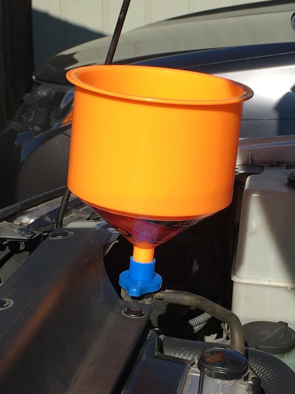

    Lisle 24680. Works great for radiators that have a cap (I also use one of those vacuum the sh*t out until all the hoses collapse then let it suck all the new stuff back in thingy).
    The Lisle is much simpler though. It's essentially a large funnel that seals to the opening and allows you to run the engine until the coolant starts overflowing without overflowing (because it's captured in the funnel). You keep running it until you see all the air get expelled (stops bubbling out). You then have a built in stopper so you can remove the funnel with the excess coolant without spillage. Close the cap (with engine still running). Done.
    Works great, and it's so cheap that I wasn't compelled to make my own.

    It starts overflowing as the engine heats up - mostly because of expansion. The funnel allows for capturing that expansion as it heats up without having coolant dump all over the place. Once the thermostat opens, it will drop in level. How much depends on how much air is after the thermostat at that point. Sometimes a lot, sometimes hardly anything.
    The extra coolant in the funnel acts as a reservoir when this happens, so it may drop to the point where you have to add coolant (into the funnel).
    You WANT the funnel to have some coolant as the engine starts flushing the air out as the coolant circulates to keep the radiator completely full. You will then likely see periodic burps/bubbles as the engine runs and flushes air out. Revving the engine a little can also help in this process.
    Once the bubbling stops, use the stopper to seal the funnel, pull it out, and cap it. You can use what's in the funnel to fill into the overflow tank.

    A5693C14-0A1B-4067-B4BD-DDBC90E91643.jpg This worked great for me when I did a complete drain and fill. You can see the level of the coolant just above the angled funnel part. It give plenty of room for the coolant level to rise without overflowing.
