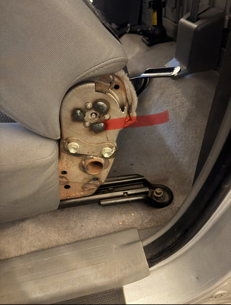

    I fixed the recliner part. Now I'm able to recline it about 2 plus inches further back and its tolerable to my back. Also, I'll be raising the rear brackets about 3/4- 1" higher so that’ll make a huge difference too (See link below). I'll report back later.
    I got two seats and I tried to install them but there were issues with the harness, airbag and seat belt on, blah blah.
    And the huge space in the middle, so I wasn't too exited about the bucket seats.

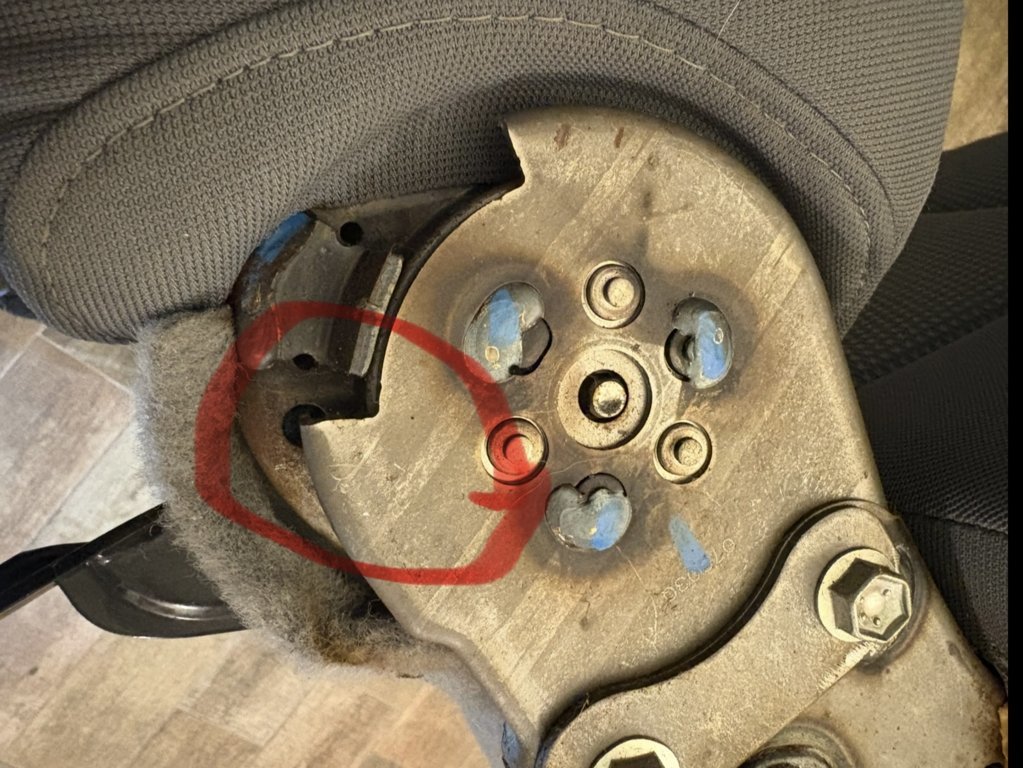

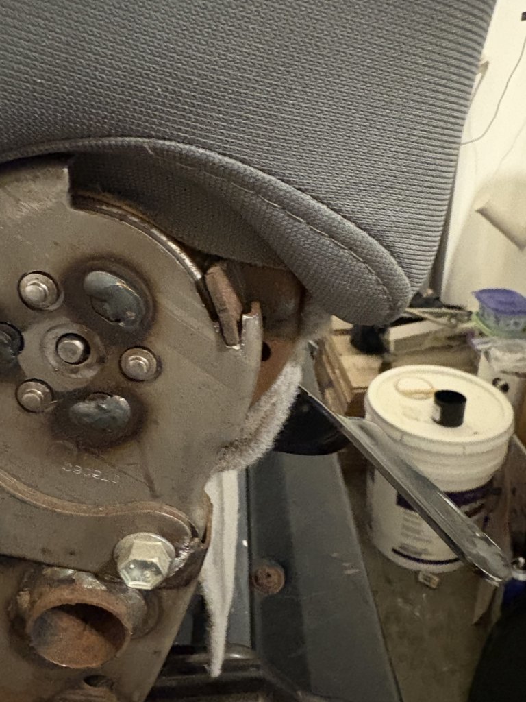

    So I made the decision to installed the original seat back on, BUT this time I look at the mechanism for about 2 minutes and I figured out a solution.
    I modified it and I got an extra 2 inches back, a huge difference.
    I used a grinder, drill, hammer and a crowbar. I was able to shimmed about 5/8 off the part that stops the recliner.
    See pictures attached, when I get a chance I’ll report back and add more information about it.
    If anyone else needs to do this, you won’t have the need to removed the seat at all either.

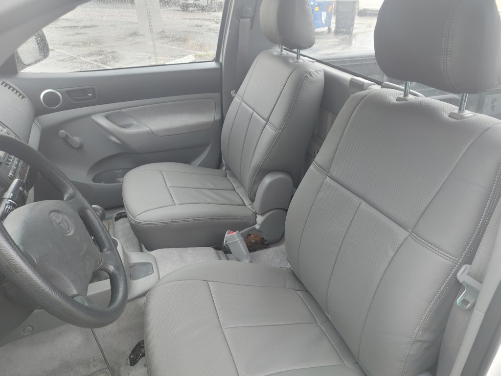

    Yes, they will fit. I put a set of 07 bucket seats in my 05 and it all fit fine. You will have to do a little cutting and splicing of the seat pressure sensor harness to make it work with the split seats. I choose to leave my stock seat belts and latches. They are at a slight angle but work fine and I didn't have to source all new seat belts and latches, since the buckets used a smaller buckle and tang. I did end up putting a 1" spacer block under the rear left of the driver's seat, but I suspect that was more due to seat sag and wanting a better seat angle for me than any actual need to mounting. I also added seat cover just to freshen everything up.

    The seat covers are from Clazzio. Those are their basic PVC ones.
