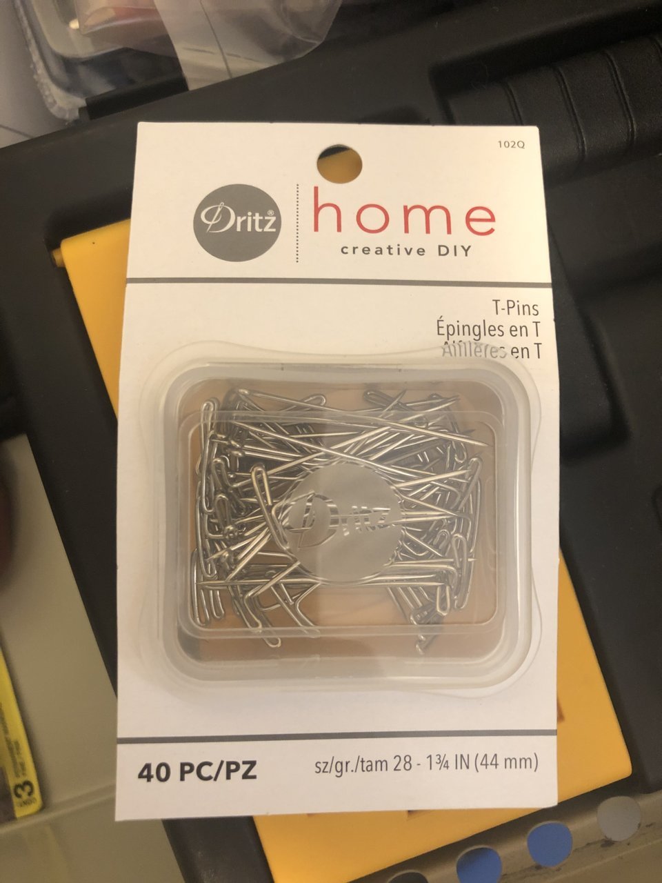

    Go to Wal-Mart and buy these
    They work good for back probing.
    TRCKTRK likes this.
