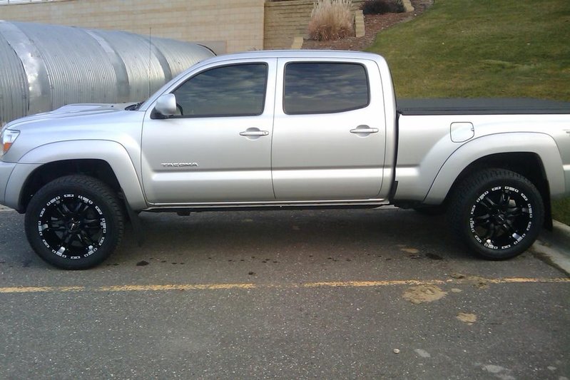

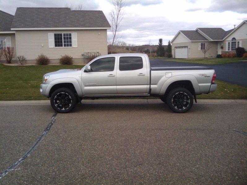

    I just got my truck setup with new rims and tires and things worked out great. I owe all of you a big thanks for all the info that is out here! It was a great help while doing the research on what the best lift options were and what wheels/tire sizes work best.
    I ended up going with the Bilstein 5100's set at 1.75 up front and a set of Ballistic Wizard wheels (20x9, 0 offset). The tires are Cooper Zeon's 285/50/20.
    The fit is perfect but will require me to trim the little nub that sticks down under the bumber. It just barely rubs so its nothing to really worry about. Overall, I have to say I am pleased with the results. I know the "what will fit with what lift" is a huge question out here so here is one that works.
    note: the tires do extend outside the fender by about 3/4"
    I almost forgot, the allignment was all messed up after the lift but things went back to normal without issue.
    Truck with 5100's installed and no lift in the back.
    Truck with the 5100's and the 2" AAL.
