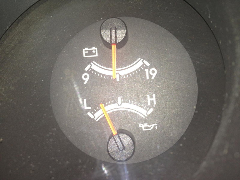

    So the 1GR-FE V6 in the tundras have a functioning oil pressure gauge? Any potential to carry that capability over to the tacoma 1GR? Are there any other major differences between the engine depending on what platform it was placed in?

    The simplest way do do it is to remove the OP sensor, install a brass "T" fitting, then thread the sensor back into the T, and a gauge type sensor into the other leg on the T.
    That's what I did on my motorcycle. Works like a champ.
    I didn't trust the fairly heavy sending units hanging horizontally on the brass threads, so I attached a stainless oil hose to the engine and moved the cluster of sensors to a mount on the crossmember up out of the way.
    I soldered a brass bolt and nut to the brass T fitting to provide a connection to ground the system, even though the stainless hose showed good continuity.
  5. Aug 19, 2012 at 2:54 PM
    #205
    ggms16
    ggms16 [OP] Well-Known Member
    Aug 2, 2012
    #83980
    126
    There you go
  6. Aug 19, 2012 at 3:04 PM
    #206
    Rich91710
    Rich91710 Well-Known Member
    Feb 23, 2012
    #73470
    16,331
    Rich
    Los Angeles
    08 Base
    Satoshi with FJ badge, factory cruise, factory intermittent wipers, Redline Tuning hood-lift struts, Hellwig Swaybar, Rosen DVD-Nav
    That's sweet.
    Hopefully we see something like that in the next generation Tacoma... but your experience underscores the need for a warning light as well, which is exactly why I did the mod shown above on my Vulcan.

    I don't rely too much on the oil pressure gauge either, but is a nice gadget.
