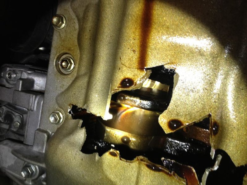

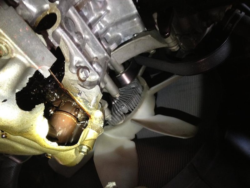

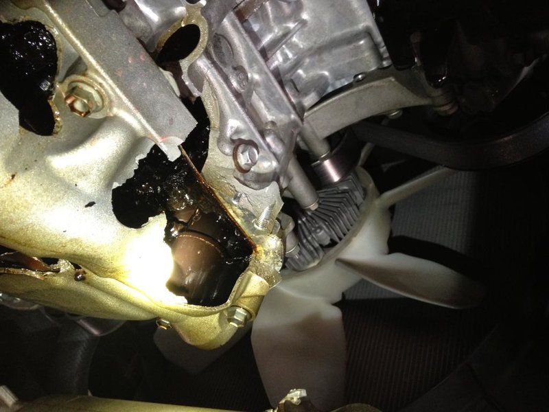

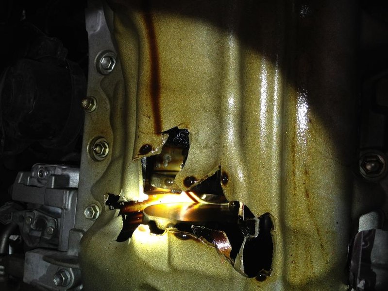

    Hard to see in the picture, but it looks like oil sludge inside the broken block. If so it looks like oil starvation from sludge buildup. Can you get a closer picture or wipe your finger inside the block hole? It sure looks like sludge from the picture you posted.

    I'm just a bit confused, no offense to the OP but as you said you have "above average in mechanic" so shouldn't you have realized the first LOUD thunk, clank sound you heard was VERY WRONG, and stopped/shut engine off immediately?
    But you continued to drive and scratch your head wondering "wus dat"?
    I think your "mechanic knowlege" is a bit sub-par to what you say.
    To the video you posted sounds like a combination of piston meets valve with a side of snapped rod.
    Good luck too ya though.

    here are more detailed pictures of the inside of the engine. No serious sludge to what I can see. just some irregular surfaces caused by the blown piston.
