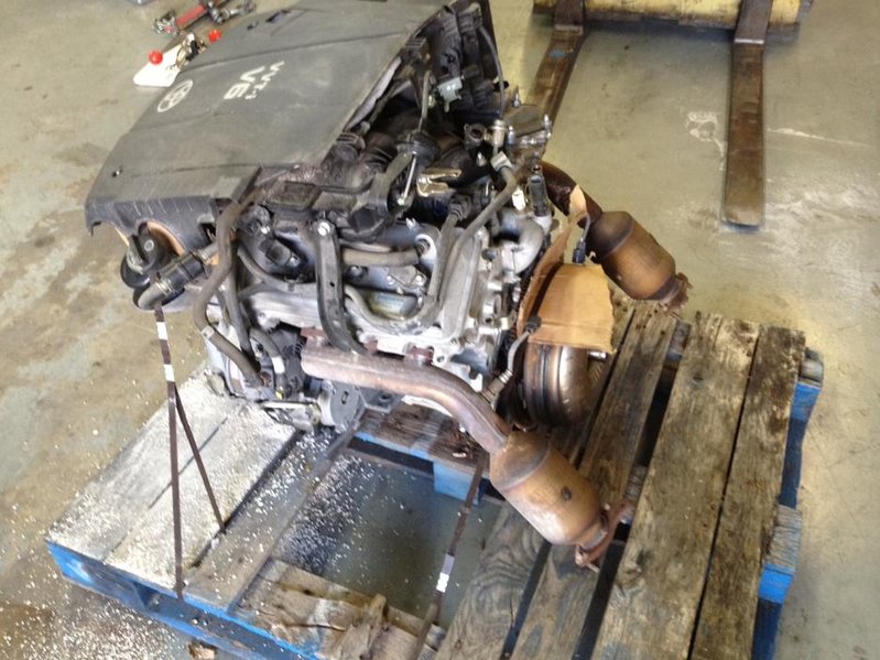

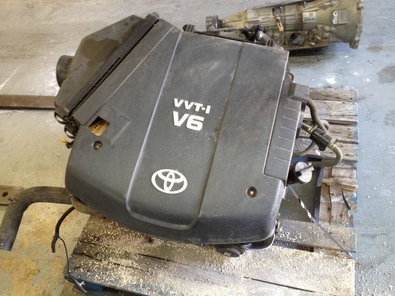

  20. Aug 7, 2012 at 8:30 PM
    #160
    ggms16
    ggms16 [OP] Well-Known Member
    Aug 2, 2012
    #83980
    126
    Pictures of the engine I got
