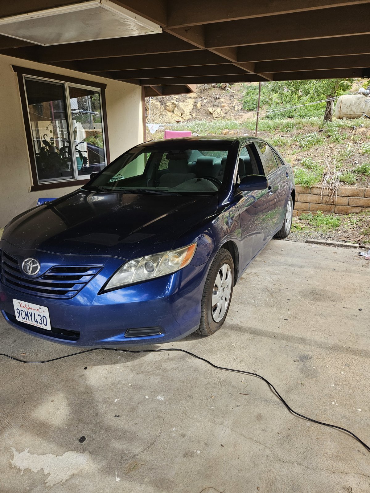

    2008 Toyota Camry V6 Automatic. 317K miles Regularly maintained by me, Oil changes by my dad every 5K miles. Does not burn oil at all.
    Great car has alway ran great untill last year.
    I keep getting Error code P0420 - or Catalyst System Efficiency Below Threshold (Bank 1)
    80% of the time the car runs fine with this code, but maybe 3-4 time a month it will stummble to the point were you want to pull over then like a switch it will be back to normal. WTF
    So far I have changed (All the spark plugs-Coils- Both PRE CAT O2 sensors.) This weekend I changed the downstreem (after Cat O2) on Bank1.
    My dad said it drove great this morning and was a LITTE better however on the way home the Check engine light came on and ran kinda rough.
    So this weekend I will change the last O2 sensor after the cat on bank 2 and see if that helps.
    Whats next if that doesnt work? It doesnt seam like a plugged Cat and @317K plus miles I'd hate to waste the money, Is there somthing else that could be giving me this code?
    Thanks for any input and the Mods can Move this if I'm in the wrong place.

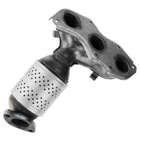

    I think you may have a cat built into each exhaust manifold, plus the one(s) in the exhaust tubing.

    The exhaust manifold on the camry has the cat built onto it like this picture..

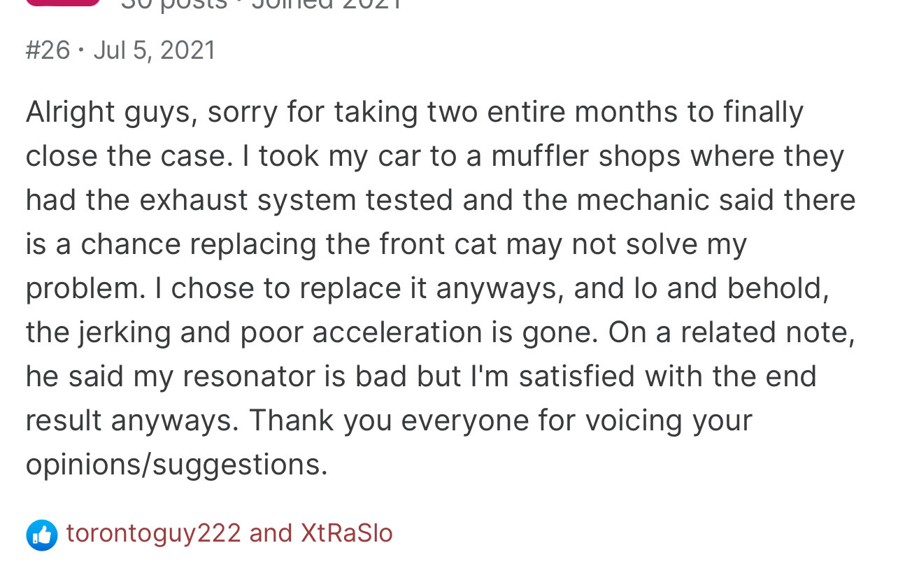

    Read this after doing a bit of good ole “googling” and figured I’d post it. This entire thread spoke about exactly what you are speaking of and a bad cat seemed to be their culprit, after basically trying everything else. I believe theirs was in a corolla around your year Camry. Not saying it is a bad cat but may have a good chance at being your issue. :typing:
