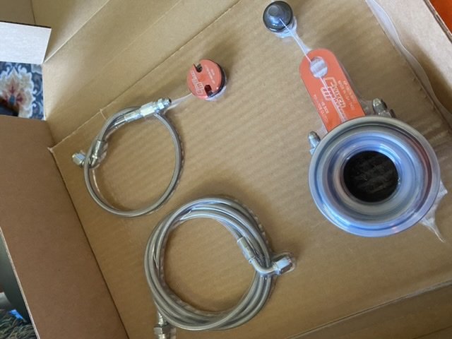

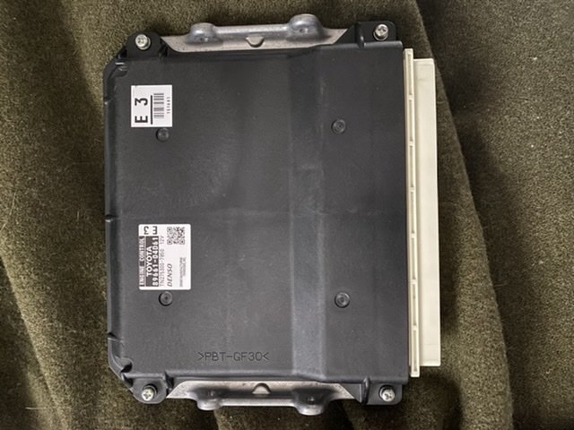

    Clutchmasters HydroBearing has arrived and the ECM has arrived today from @JustDSM. Got an ETA from Toyota today, my final parts should be here on Friday. Install should get underway next week.

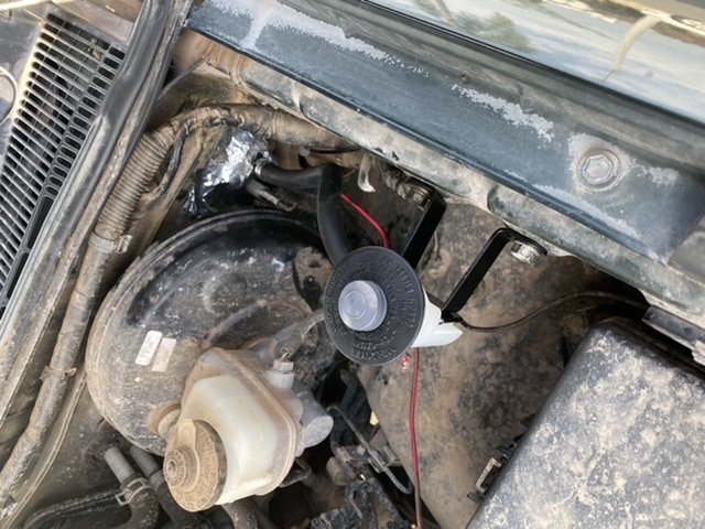

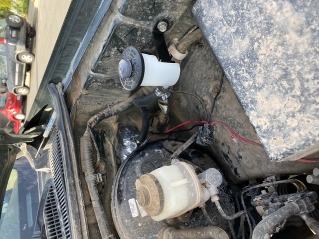

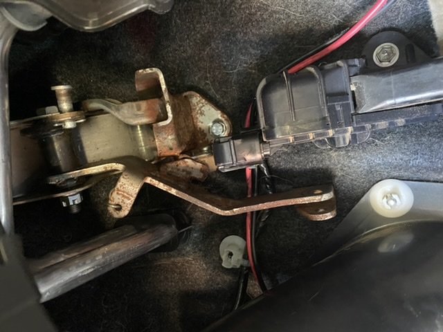

    Took some time and mounted up the clutch fluid resi and connected the rubber hose to the clutch pedal.

    This thing was fun. (Not really) my drilling was a bit off and you can tell by the pictures.

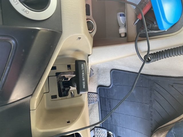

    MT E-Brake assembly is in and mounted.

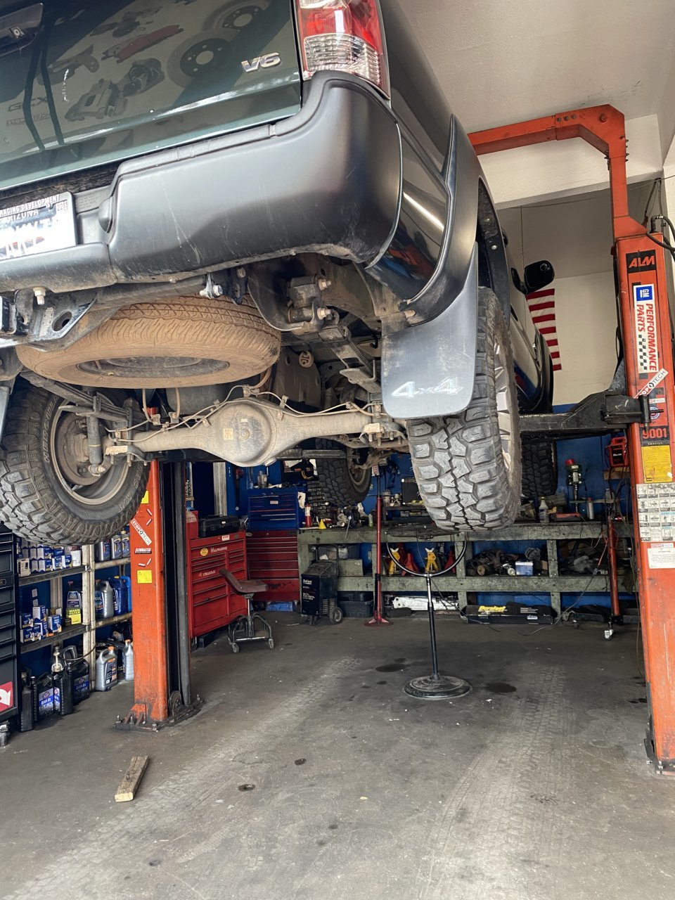

    Ladies and Gentlemen. It is now, the moment you’ve all been waiting for. Install day, its Showtime.

  14. May 18, 2020 at 4:48 PM
    #34
    SparkyIX
    SparkyIX [OP] Well-Known Member
    Dec 3, 2016
    #203916
    223
    Anthony
    Tonopah, AZ
    2009 TM 4x4 DCSB 6-Speed Swap
    It did for the most part. I have a few kinks to work out but I did get it from the shop back to the house.

  15. May 18, 2020 at 5:03 PM
    #35
    SparkyIX
    Dec 3, 2016
    #203916
    223
    Anthony
    Tonopah, AZ
    So, the swap is mostly done and I have driven the truck with the auto ECU. Usually there is lag when you shift. Well, if you shift casually. About 1,2,3 seconds total process. Truck runs great but has a check engine. (Auto ECU still in truck) truck would not start with the clutch depress switch. My wiring may be off. So I jumped the starter with it in neutral and it fired
