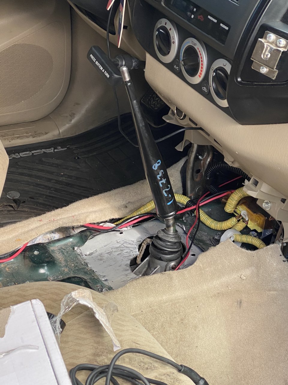

    Photo dump.
    Today I underwent the task of swapping the ECMs and setting the Immobilizer.
    Thankfully I installed the under shift boot mount and it dosent look entirely bad. I’m waiting for the console to arrive sometime this week and the truck should be complete. And hide all the mess where the shifters at.

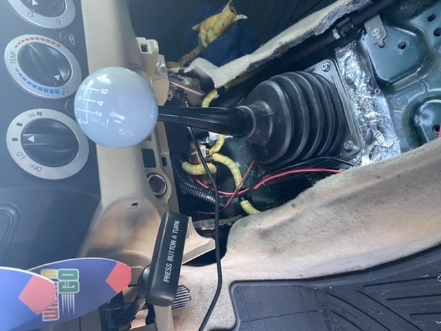

    Can’t wait for the console to show up so I can hide this mess.

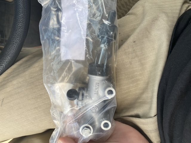

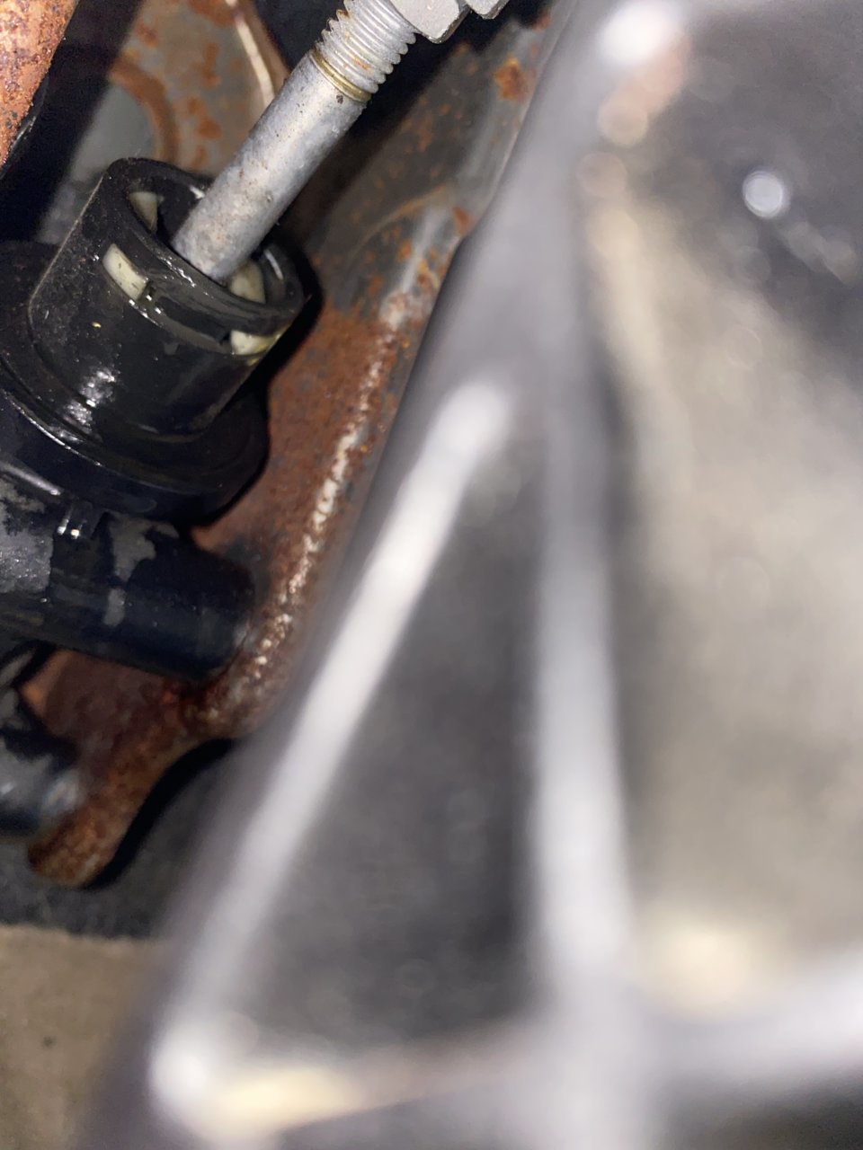

    Note to everyone. If you are going to do this swap. Don’t be lazy. Change the clutch master cylinder before you install the pedal assembly in the truck. If not, you’ll be like me with a leak dripping on the carpet. Gonna get the new Aisin one installed today.

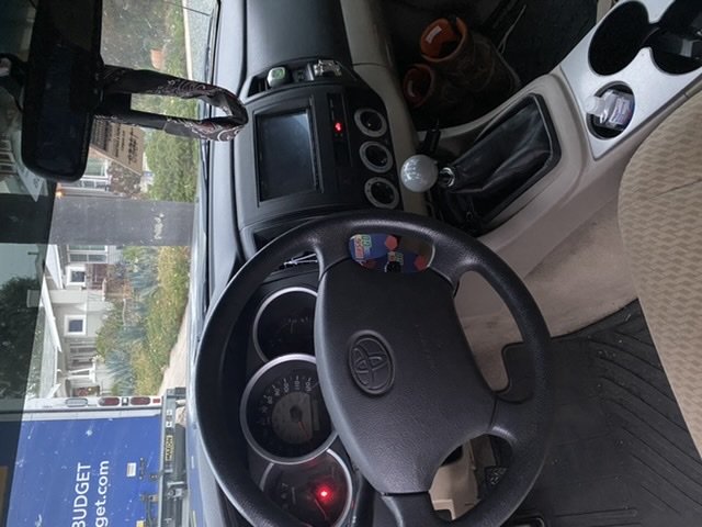

    My shifter is pretty sloppy, And my shifter is broken. I have ordered the TRD QuickShifter kit and the Marlin Crawler White Shift Seat.
    I also installed the MT console. Trucks about done with the conversion.

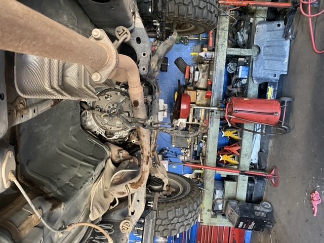

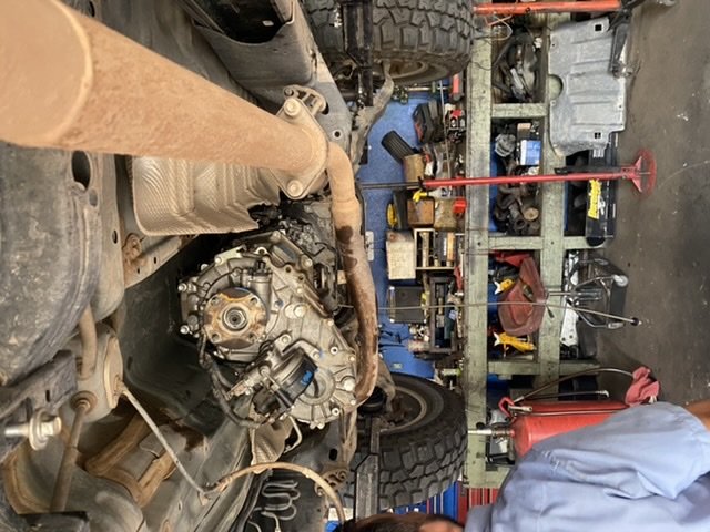

    Update. 500 miles and I have bearing noise in neutral. Thought the HydroBearing was suppose to cure that? Also my 4low dosent want to engage. Thoughts? I haven’t tested after the swap. 4high works, 4low dosent.

    Figured out the 4Low issue.
    The truck has to be in “neutral” on the auto harness to send power to the 4Low circuit. So I tapped ignition power to the neutral circuit and I now have working full 4wd functionality.
    I also finally tapped into the reverse circuit and now have working reverse lights and rear camera that worked when I shift into reverse.
