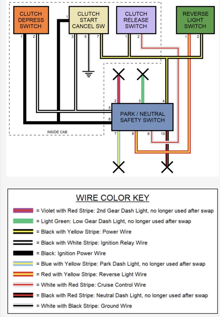

    Hello everyone. Trucks been running great, but I’ve decided to try and clean up my wiring for this swap. I’ve found a similar write up from a T4R that someone did, and I was wondering if I change the wires to my color codes etc it could be applicable.

    Wich one is the wire neutral circuit? The one you have to tap to the +? Where he is and what color thabk you

    Blue with white tracer is to powerte neutral circuit. Yellow is power. Red is reverse lights. This is off NSS under vehicle.

    Correct, sorry for the late response. Blue with white stripe connected to the yellow. I believe the yellow is IGN power. Only reason I did that connection, is with the Auto wiring, your truck has to get power through the Neutral circuit to engage 4wd Low

    Well final update on this swap, I officially got the cruise control working.
    Ign power to pin 1 of the upper clutch switch, and pin 2 ran down to the PCM Connector E9 Pin 27.
    After a brief test drive, all is working as it should be.
