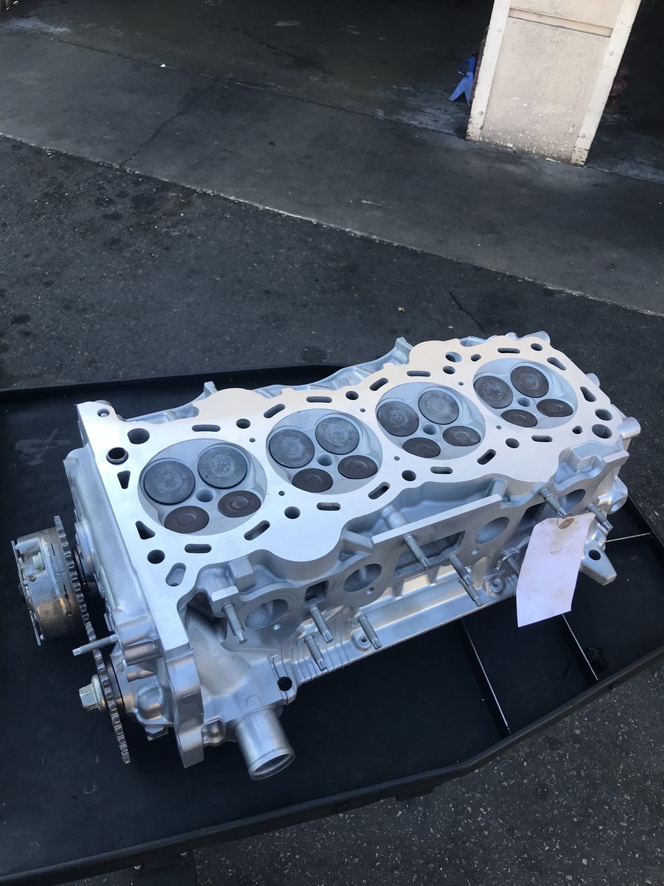

    We are now 95% sure head gasket. Now the question is replace with a jasper or overhaul existing for $1800?2C7474D9-B22C-48C1-B584-78BB7AF5B56B.jpg

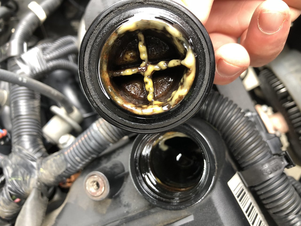

    I've had condensation under my oil caps over the years. Just short drives can cause this. I'd get the compression test.

    Yeah the mikyness under the oil cap is normal

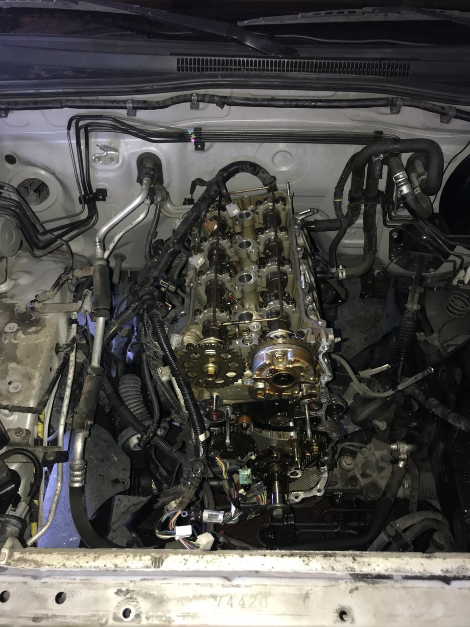

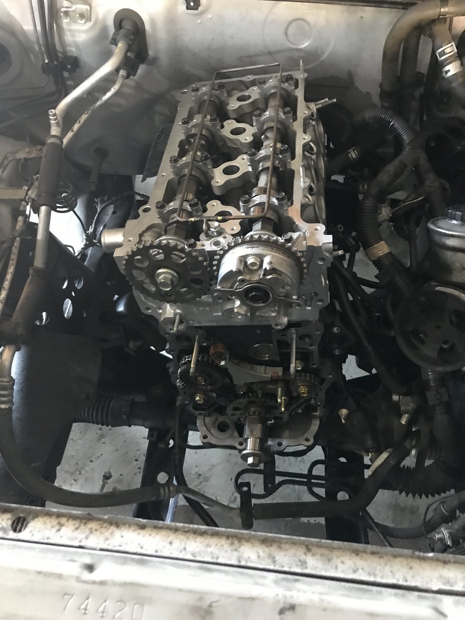

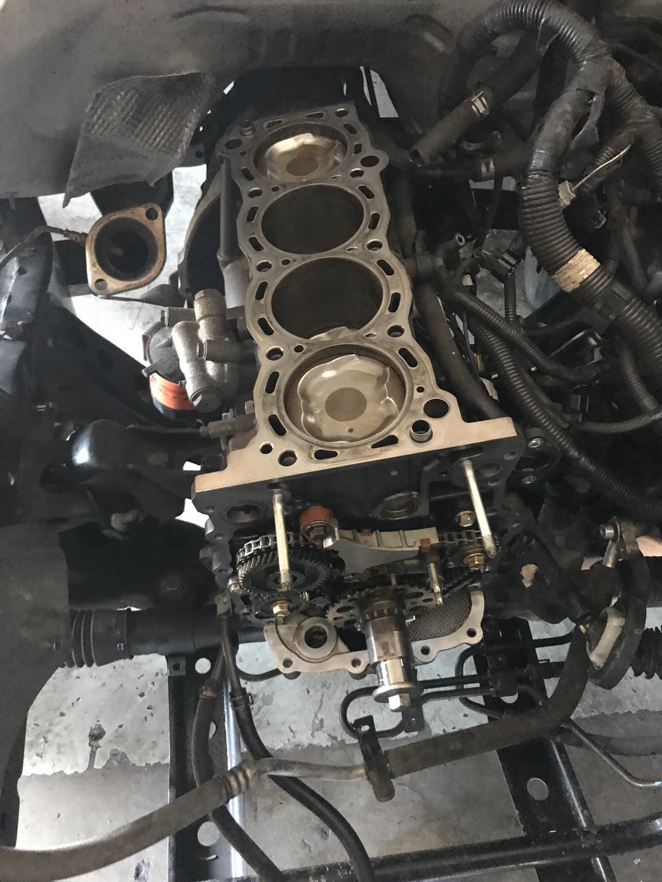

    OK so here are some progress pics of the head which just got installed today. Turns out I had a water pump leak as well so he's charging another $127.00 to replace.

    Nice Pics! Thanks!. Do you actually find the leak??
