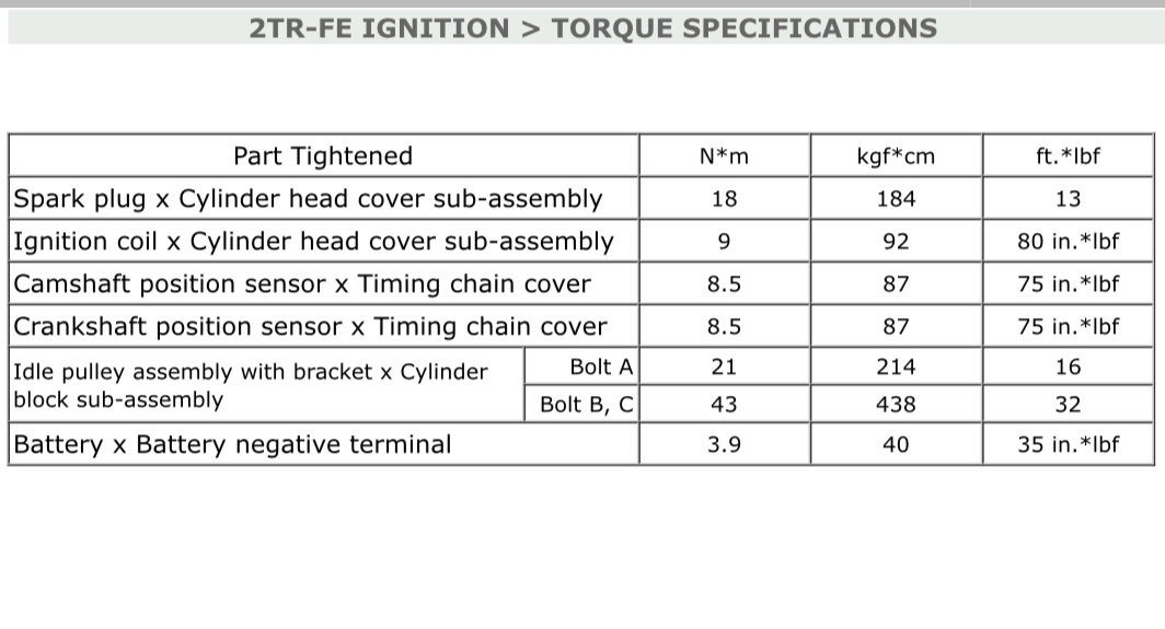

    Going to change the spark plugs this weekend. Does anyone know the torque specs or is it the regular hand tighten to a dead stop and then 1/8 more of a turn?

    My 2nd Gen V6 recommended 15 foot pounds.

    13-15 lb/ft
