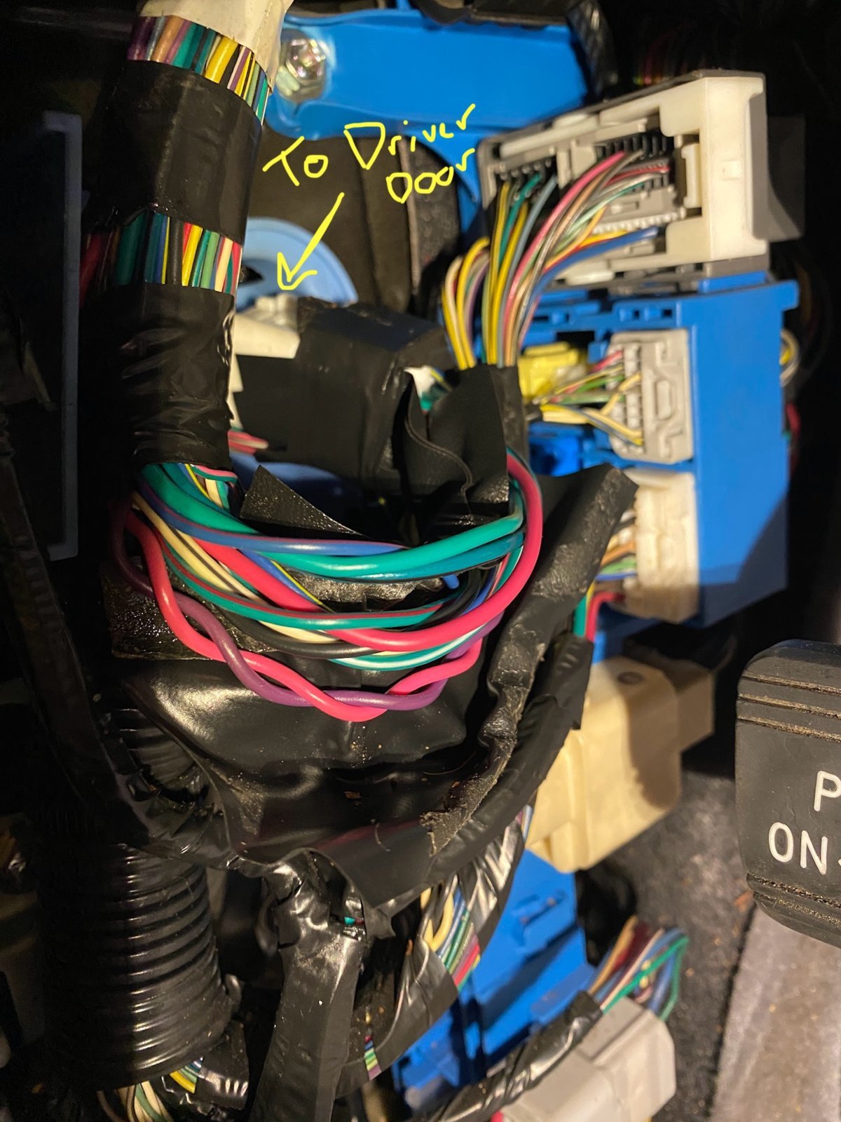

    2009 Toyota Tacoma 4-Door 4L V6
    Hey all, I'm trying to connect my PopLock PL8521 to the driver's door wiring harness, but I can't figure out which wires I should be splicing. The instructions online talk about the blue/pink wire which I can see, but I cannot find either a blue/red or blue/black to connect the other wire from the PopLock to.
    Does anyone know which 2 wires are the lock/unlock for the door? The picture is of the wiring harness going out to the driver's side door.

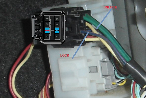

    I used a pace Edwards brand and I tapped into passenger side harness. Main reason I did passenger side is that i liked that i can unlock the driver door with my key fob and all the other doors stay locked. If you want the tailgate unlocked just double press.
    Let me look and see what colors I tapped into:edit purple and gray if you want to go that route

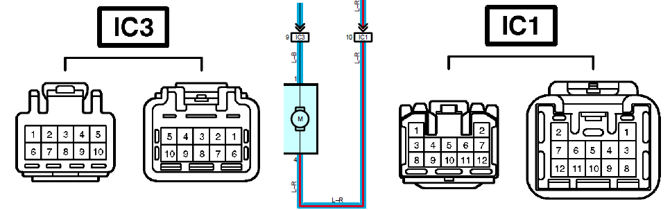

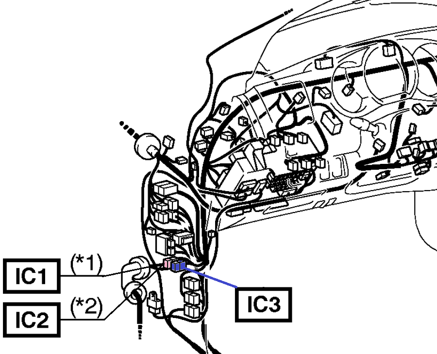

    Passenger's side, behind kick panel.

    Awesome thanks for the picture!
