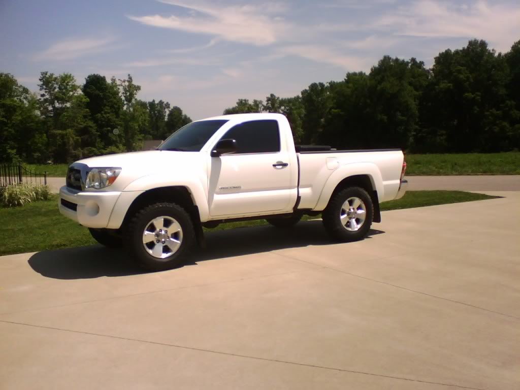

    Hey, just a small build/update thread here.
    Current "Mods"
    Bilstein 5100 adjustables front and rear
    OME 885 coils
    rear AAL
    shackle flip
    diff breathers extended
    lockright rear locker
    UWS low profile toolbox
    tint
    V6 tacoma hitch
    foglights
    downey offroad front skid
    CB
    truck bed tent for camping/exploration
    TRD sport wheels with BFG MT KM 255/75/17
    stock steelies with BFG MT KM2 255/85/16
    Planned "Mods"
    ARB air locker front
    front winch bumper
    rear high clearance bumper
    more skids
    armor
    crawlbox, possible regear to 4.88's
    Truck was purchased October 5, 2008, the day before I left for training.

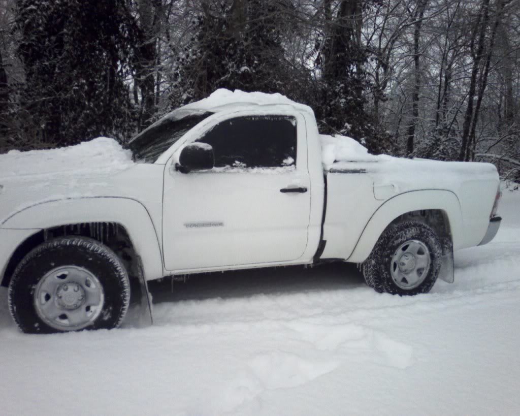

    First snow of the season.

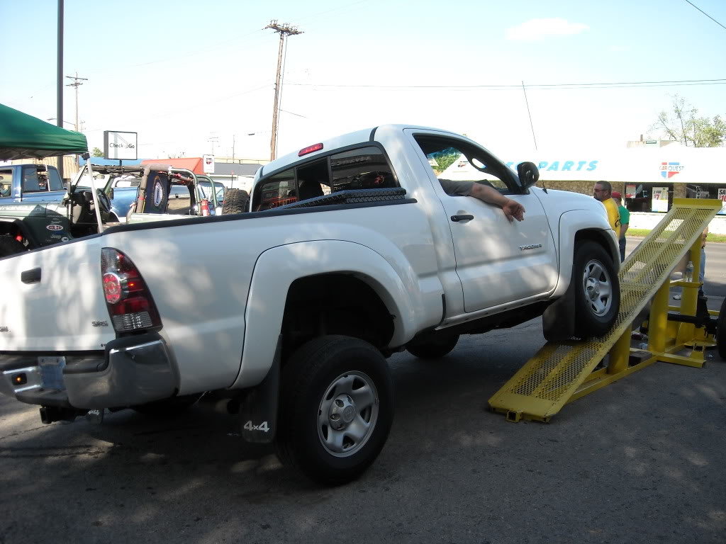

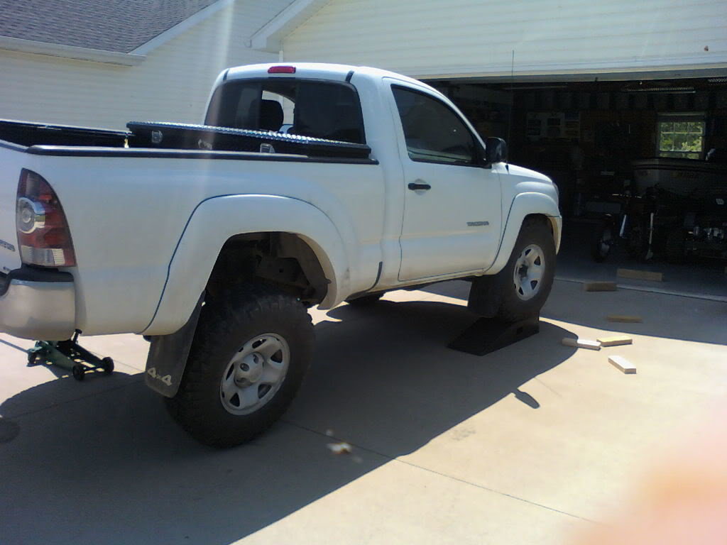

    Stock on RTI ramp. combined average of 527.

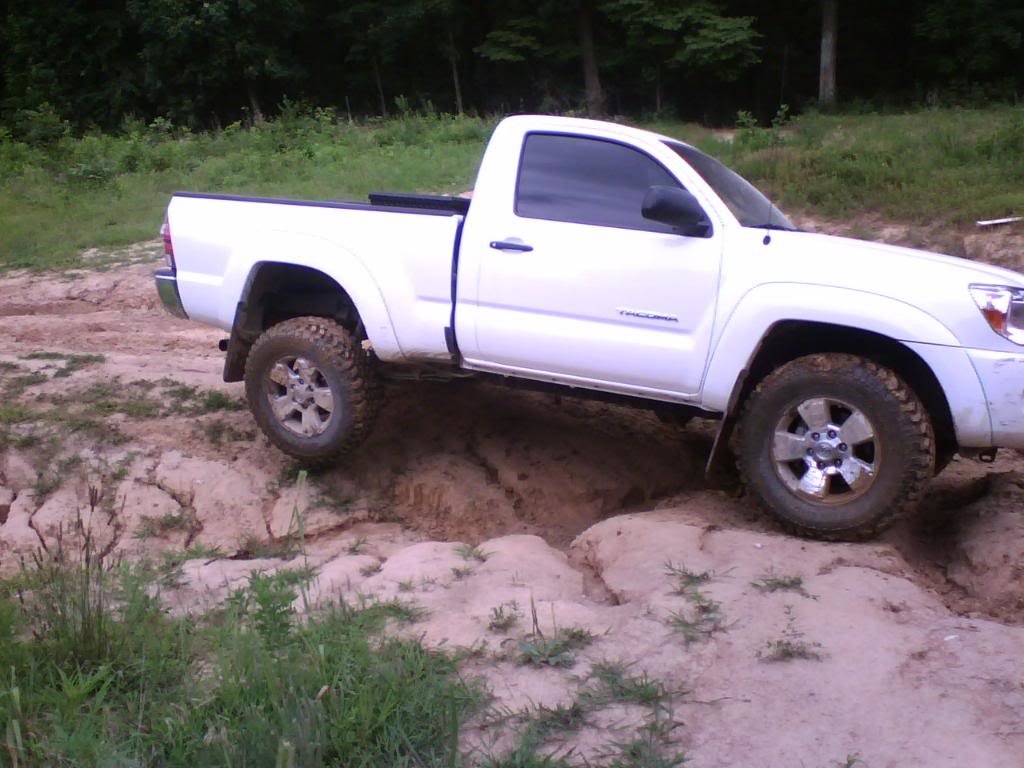

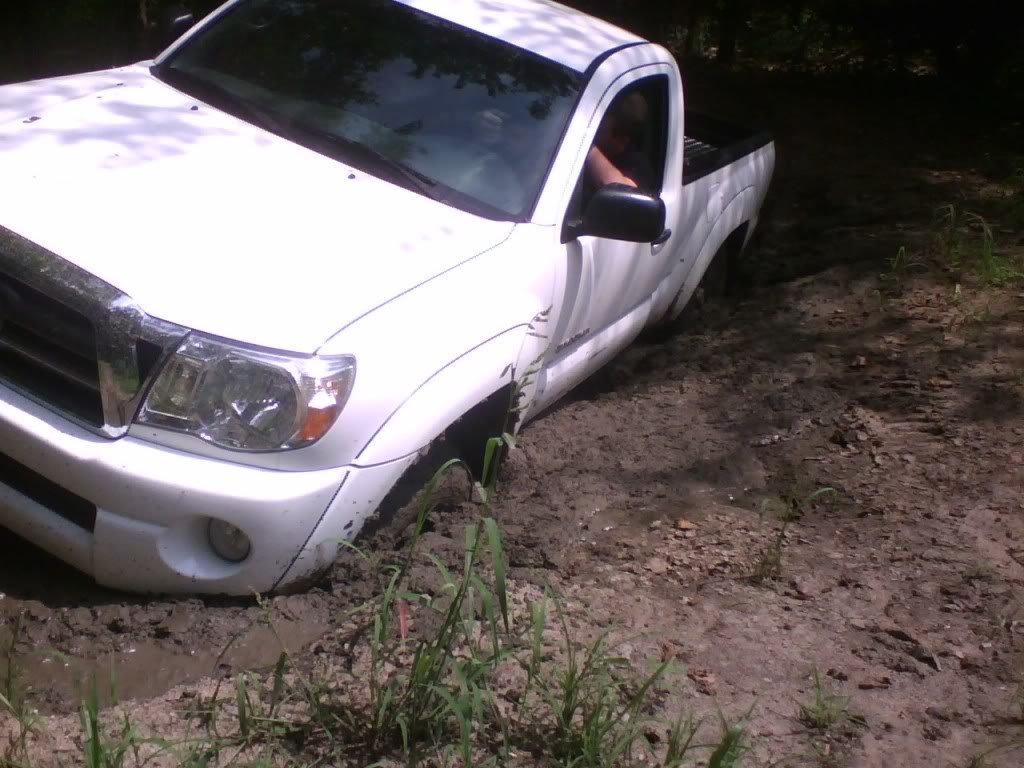

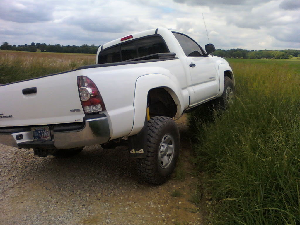

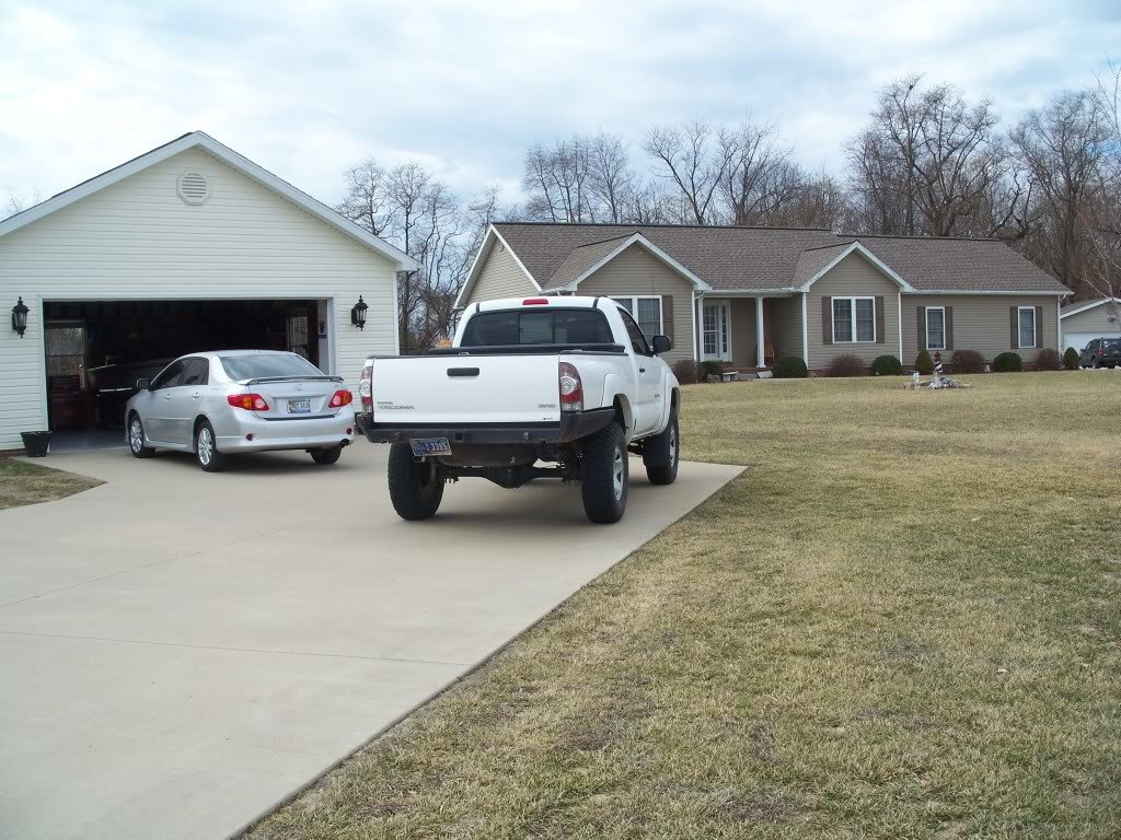

    Front lifted on the KM's, amazing difference offroad.

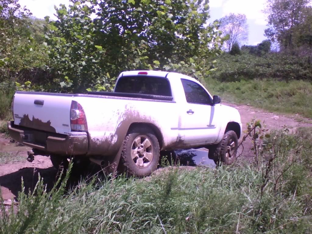

    I got a little cocky...
    Random wheeling.

  4. Mar 8, 2010 at 9:19 PM
    MarineTacoDriver
    MarineTacoDriver Well-Known Member
    Jan 22, 2010
    #29836
    342
    Brian
    Cherry Point
    09 SR5 4x4
    ARB front bumper, Warn M8000, ATO front/transmission/transfer case skids, Icon ext travel coilovers, Total Chaos UCA's, OME Dakar leaf springs, Bilstein/RCD 5100 3-4" lift shock, extended stainless brake lines, DrewFab shackle flip, rear ARB Airlocker, ARB air compressor
    A little cocky would appear to be a bit of an understatement. :eek: How'd you get out of that mess?
  5. Mar 11, 2010 at 2:36 PM
    gtrotter
    gtrotter [OP] Well-Known Member
    Mar 1, 2010
    #32351
    394
    Interlake, Indiana
    2009 Regular cab 4x4, ARB's, 4.88's, bumpers, 2017 DCSB SR5 stock
    locker,mud tires, lifted, toolbox
    A strap, another vehicle, and lots of wheelspin. I could have made it, were it not for a ledge at the end of the mudhole that I was hitting with my bumper.

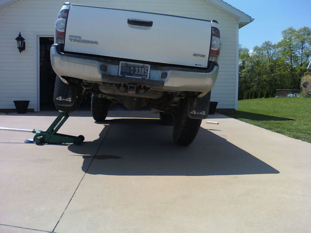

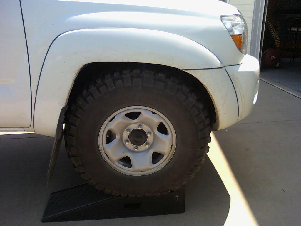

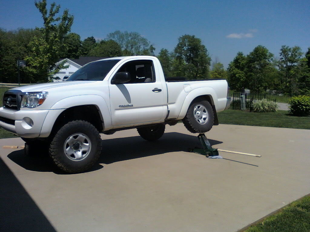

    Update, new tires.
    255/85/16 BFG KM2's, also I tore up the downey skid, will be getting a new one.
    Here are some flex pics. Poor mans RTI ramp, scored approximately a 678- went to 25.5 inches lift, could probably go up another inch or two. 110 inch wheelbase.
    The front will stuff a tad more, but not much. Pretty satisfactory performance for such an inexpensive setup. The rear flex is limited by shocks. I will be possibly getting some longer travel Bilstein 7100's with remote reservoir soon, along with extended brake lines and new leaves.

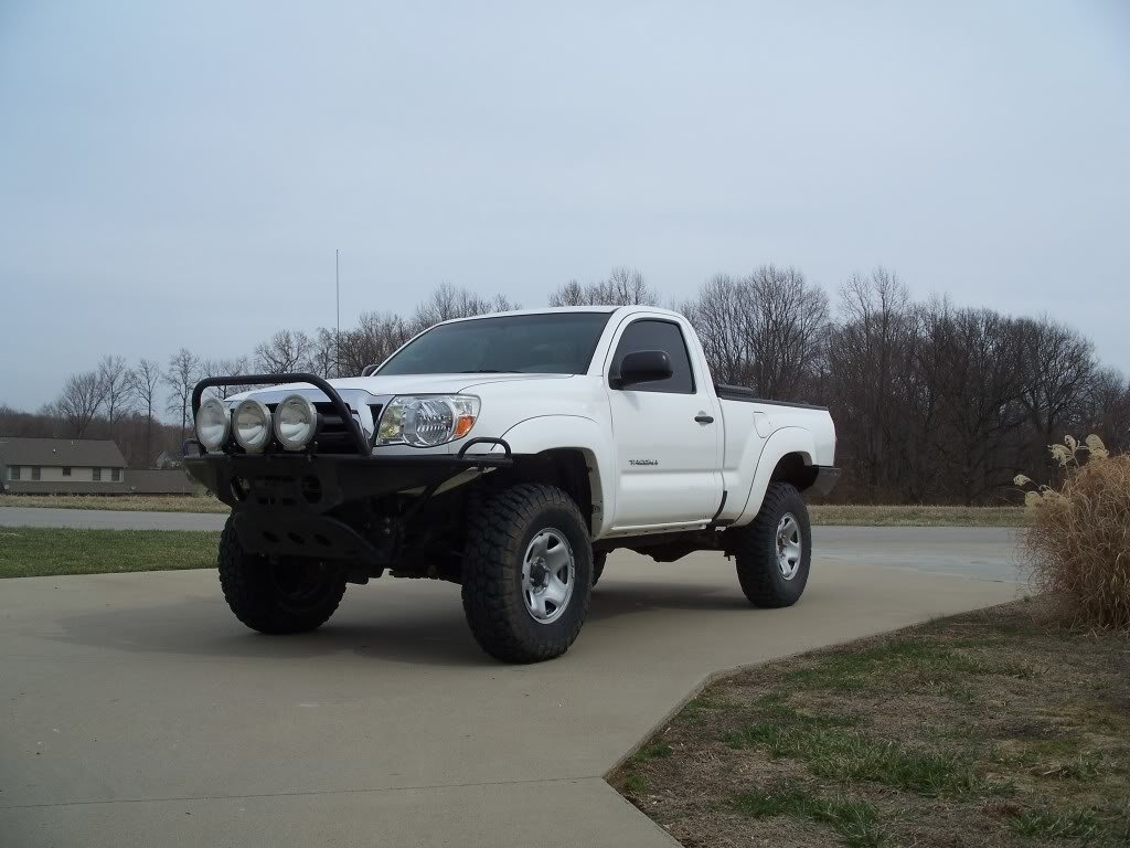

    I've got a few small updates.
    1. Sliders are in garage, will weld on this week. 4xinnovations 68" DOM with kickout
    2. All-Pro Hybrid front w/ 3 lights-in mail, hopefully here this week
    3. Pinion bearing is toast, need to replace
    4.I am winch shopping, thinking maybe warn m8000 with synthetic rope?
    and finally, I got an armortech high clearance rear bumper. This is the original prototype. A friend(NWitaco) bought it off of his truck(literally) and I bought it off of him.

    update, got my all-pro hybrid bolted up with 3 procomp lights, gotta wire them up. Also, ordered ARB's and 4.88 gears, should be here soon.
