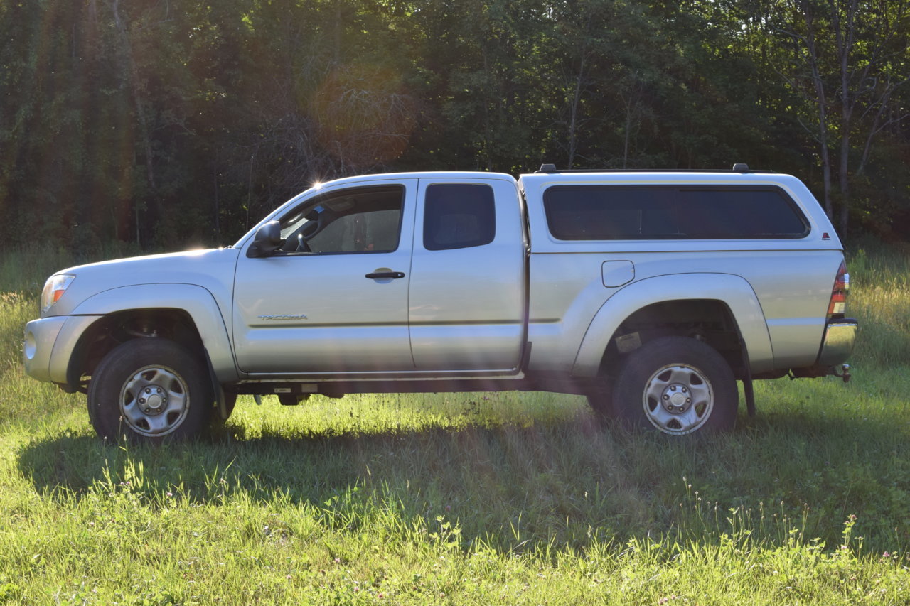

    I bought the truck with 105k with a brand new frame, lca’s, and recalled leaf springs. It already had the leer cap. Picked it up and the next day brought it for a 8 day hunting trip. I discovered the new leaf springs weren’t going to cut it. And so it began. I wanted to keep it as light as possible.8849E740-0C11-4D12-AF2A-DF7DFBC14F8C.jpg

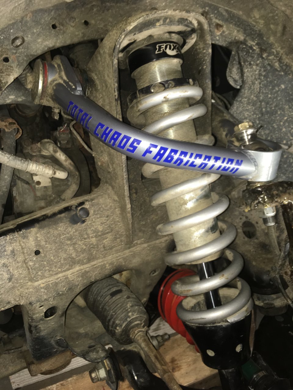

    I replaced the springs with Wheelers off-road 5 leaf HD packs (minus the overload), U bolt flip kit, and Fox 2.0 shocks. Both factory front struts broke just about the lower mounting eyelet, so I put Fox 2.5 coilovers in with total chaos uniballs UCA’s with the ride height set about an inch over stock. The sway bar was a hassle so now it lives permanently in the shed.498F0F07-EFC9-4AE7-8999-8BE33A2F7905.jpg

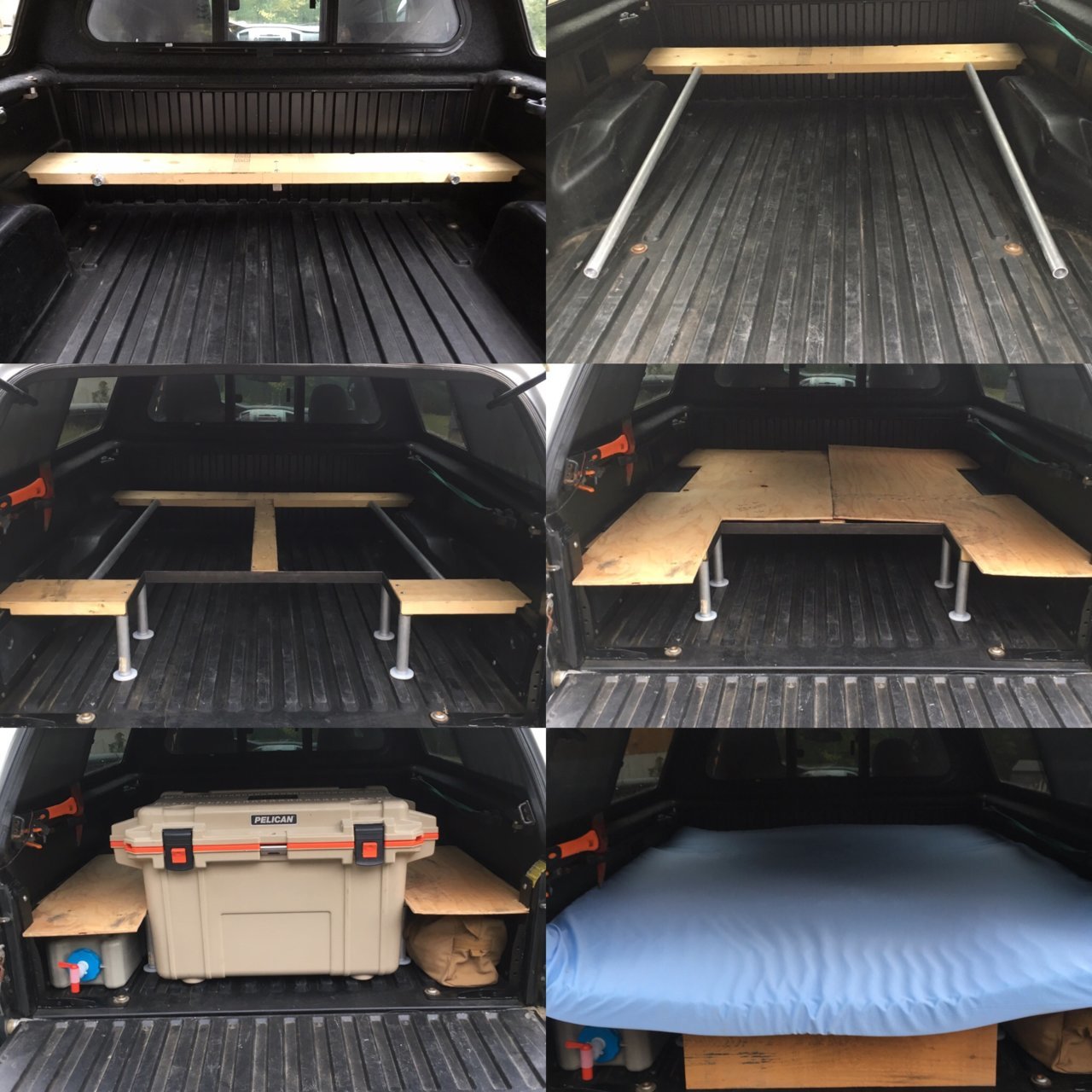

    We love to get out and camp and hike, so I made a sleeping platform for the bed. I wanted to keep the platform level with the tops of the fender wells, to utilize headspace. I notched 2x8s to fit down into the pockets formed on the bedsides and tried to use aluminum wherever else to keep it light. I also needed to fit my cooler with the platform in place so I made a bracket with a removeable panel. Panel in the sleep, panel out for cooler transport

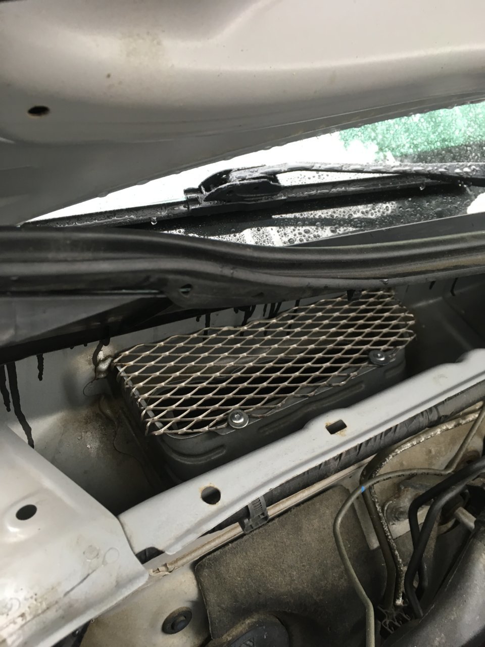

    A few other little things like window tint, LED’s for the dome lights, WeatherTechs, mudflat trim, and anti mouse mod.

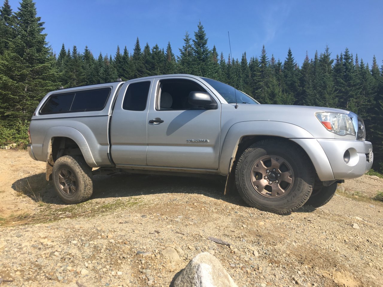

    I wanted a taller tire but as close to the same weight as the factory tires and wheels, so I went with 16” TRD rims and 235/85/16 Cooper discoverer AT3s. I sandblasted the rims and painted them bronze

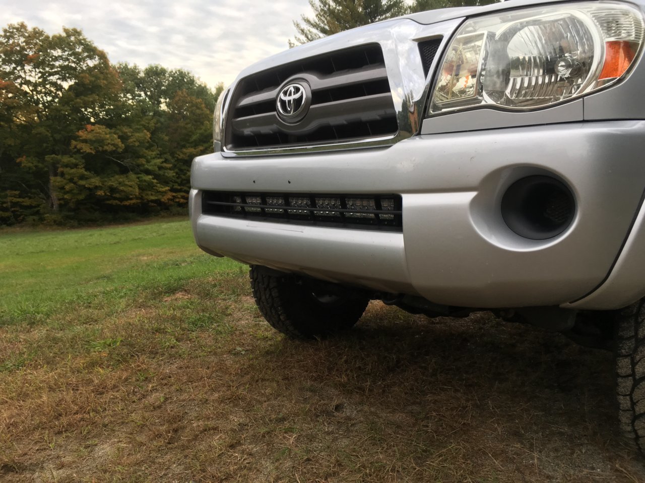

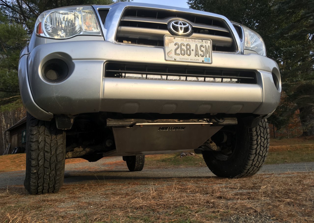

    Where I hunt at times is anywhere from 13-25 miles of dirt road and I was wanting more lighting, so I put in a Caliraised 32” combo bar as low as I could mount it to help in the snow

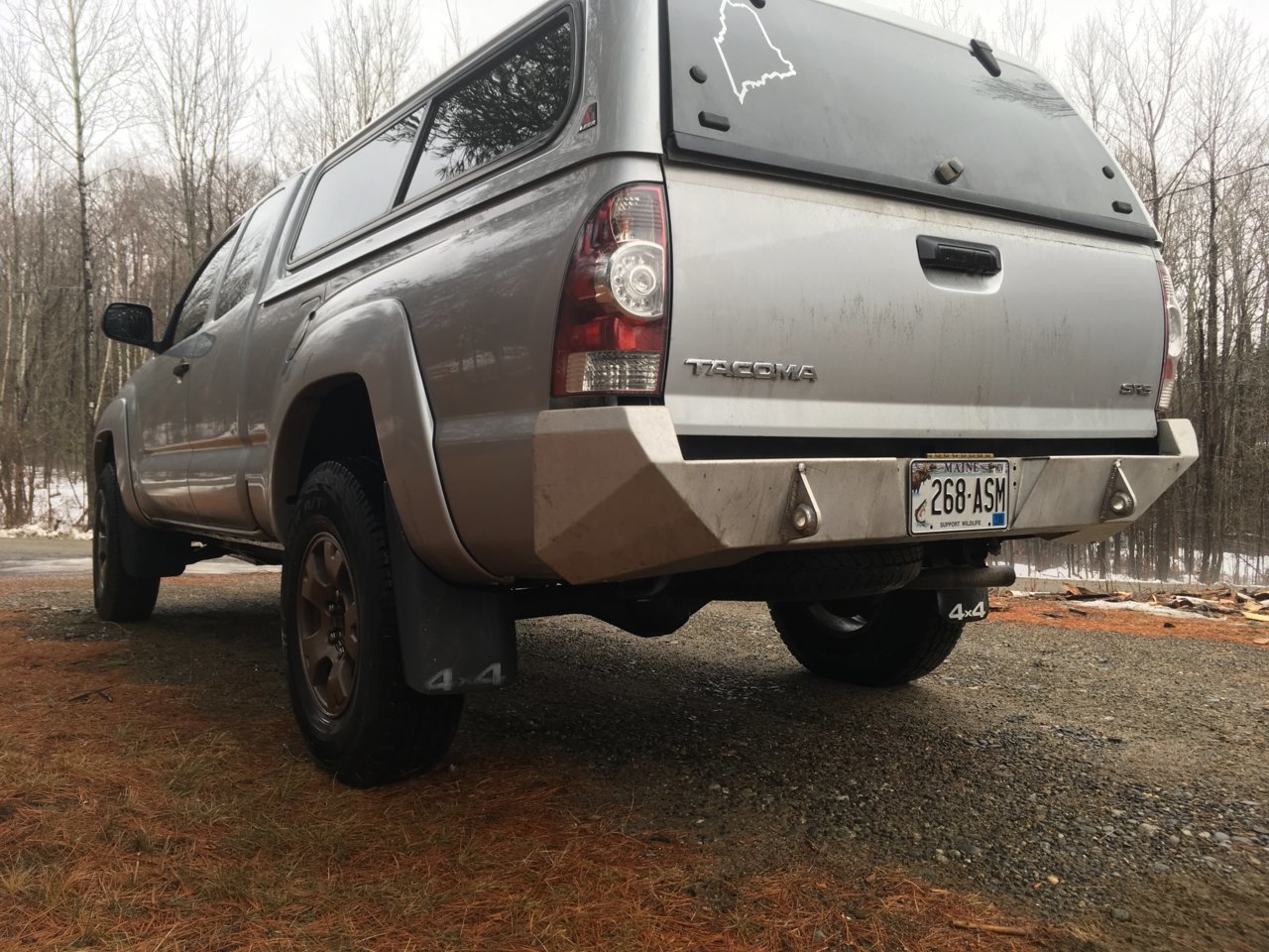

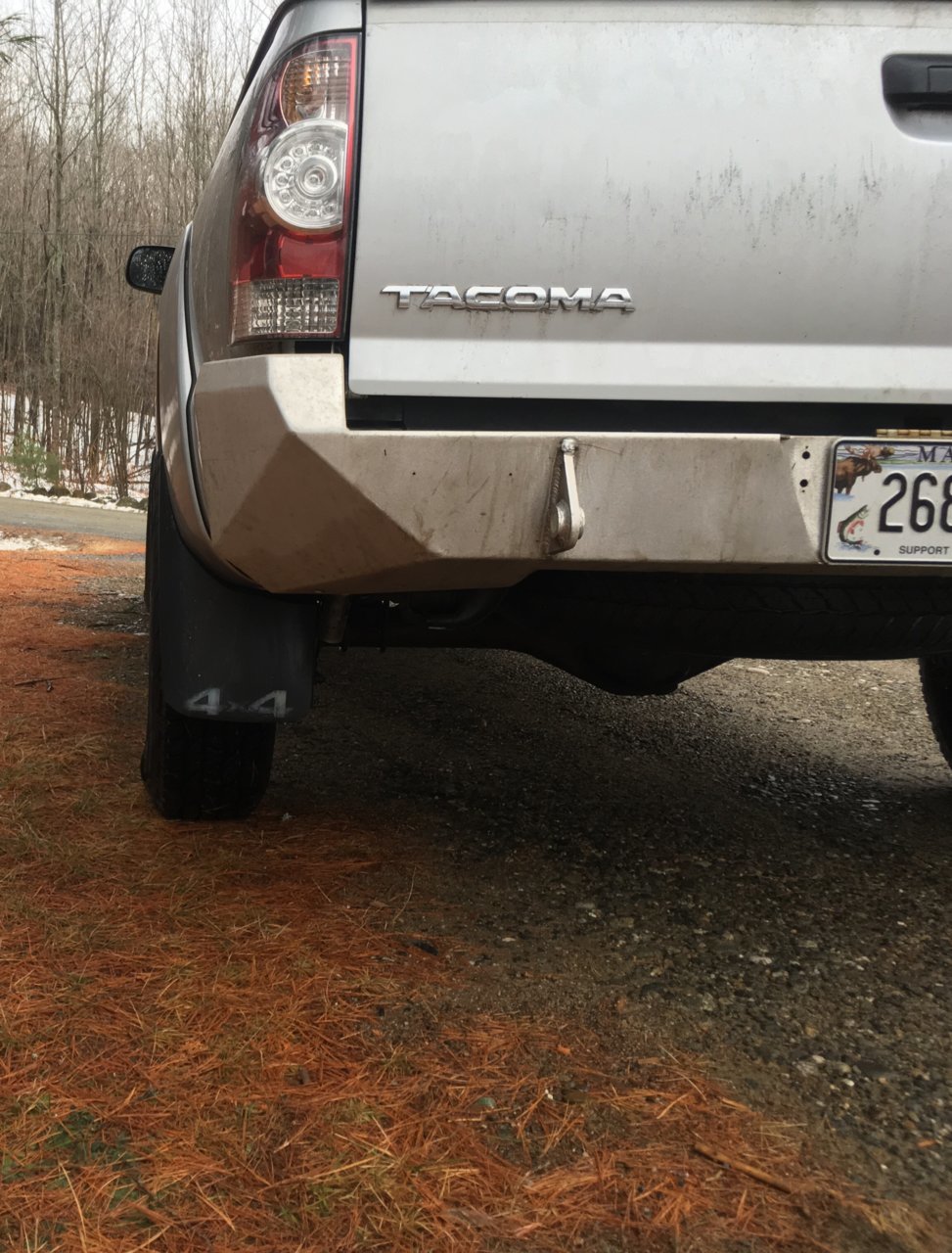

    Next was protection. Mobtown aluminum skid and an Allpro aluminum read bumper6A2BF5C3-CC32-456D-9D01-26A6E8E25F08.jpg
    The tires set inside the fenders about an inch and a half and I scored a set of new in the box 1.5” wheel spacers from a guy I work with for $40, which brought the tires right to flush

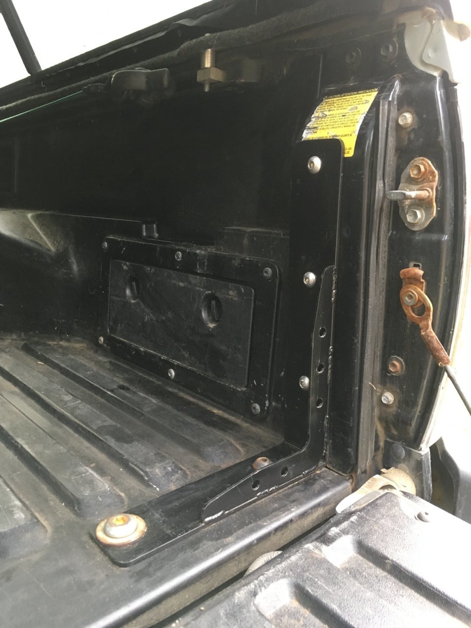

    I ended up making my own bed stiffeners to help with the weight of the cap54A1CFF7-0A50-4BD2-8540-B0353C19C902.jpg

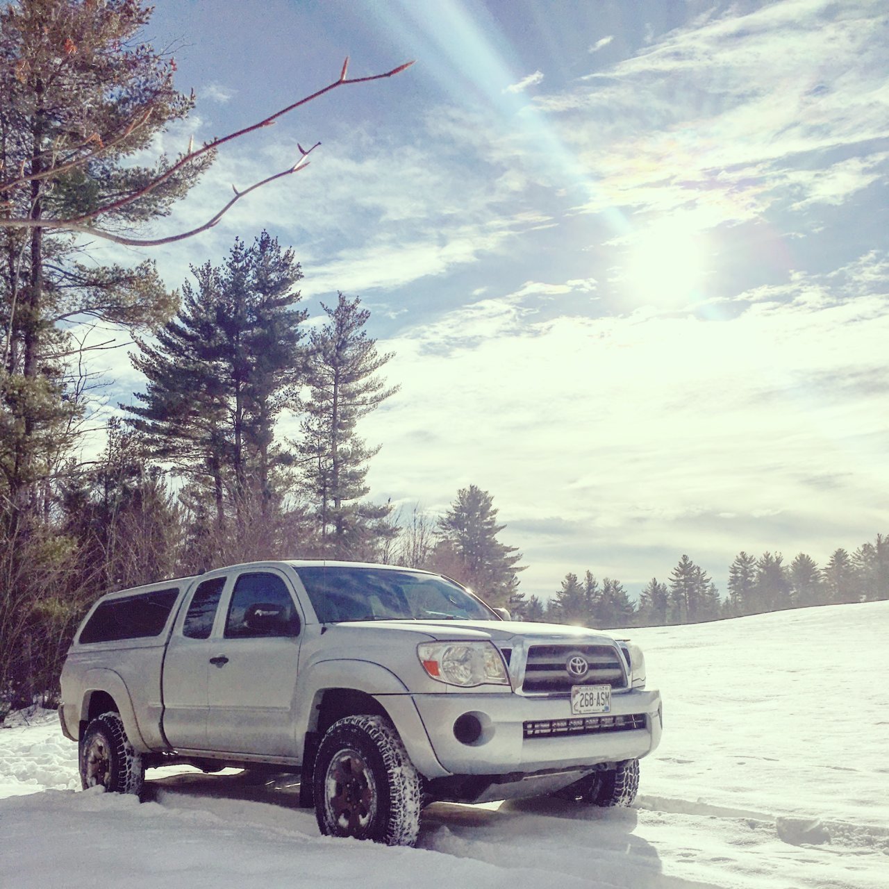

    That’s pretty much wraps it up. Now I let it take me to awesome places 3E97B7E9-B59D-49B2-832C-DB45EC82E57E.jpg 14E17EA8-DEC1-4F21-B83F-476EE185A124.jpg

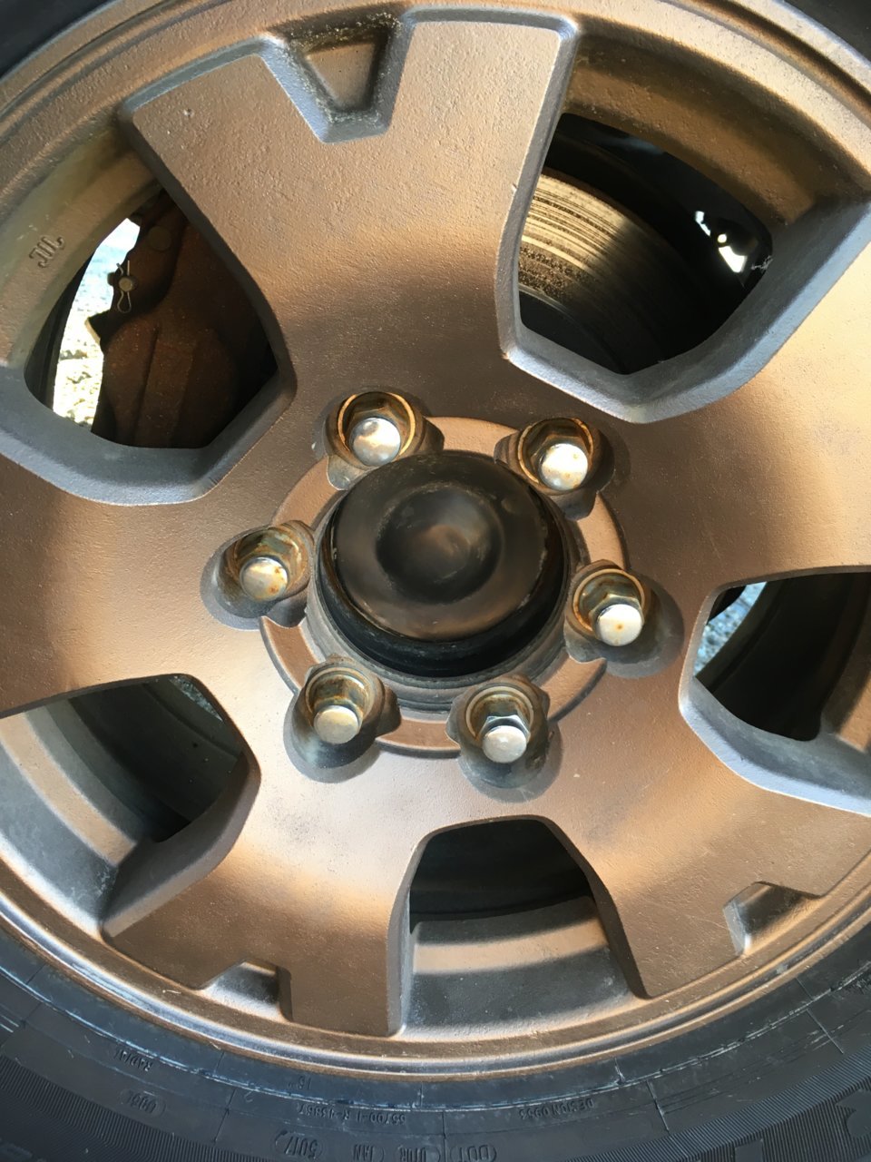

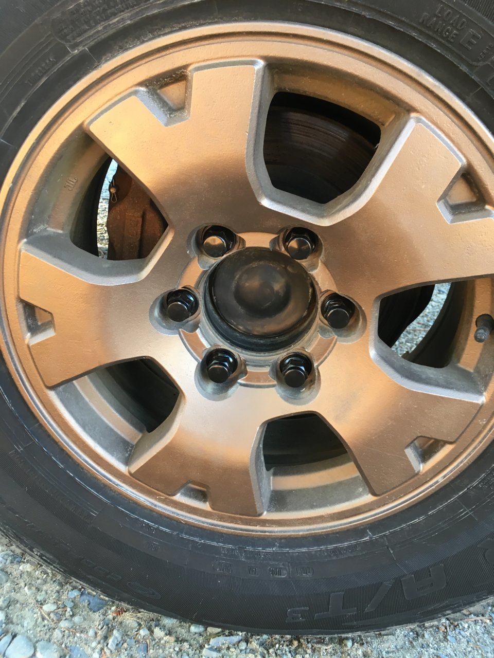

    To ease the stress on my OCD, I also changed out the rusty chrome lug luts to black.
    Ahhh, much better

    Dang man! What's your OCD have to say about that trashed brake rotor! Lol

    Touche, sir
