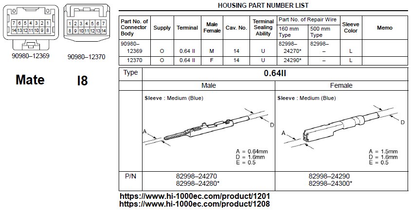

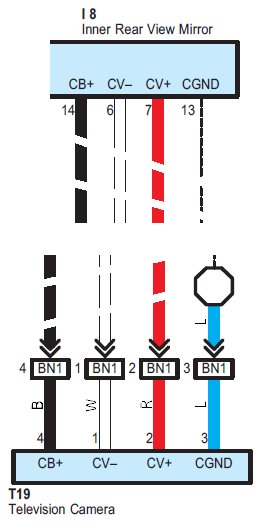

    Since you now found that the wiring is in place, you can do as Bret has stated. It be a larger investment, but a better view. There's mating connector to the one you found that can be used to divert the camera signal to a new head unit.

    I8 also has Fused Battery & Fused Ignition source, ground that can be re-purposed for other features: Dash Cam, Mirror with Compass/Garage Door opener type, etc.

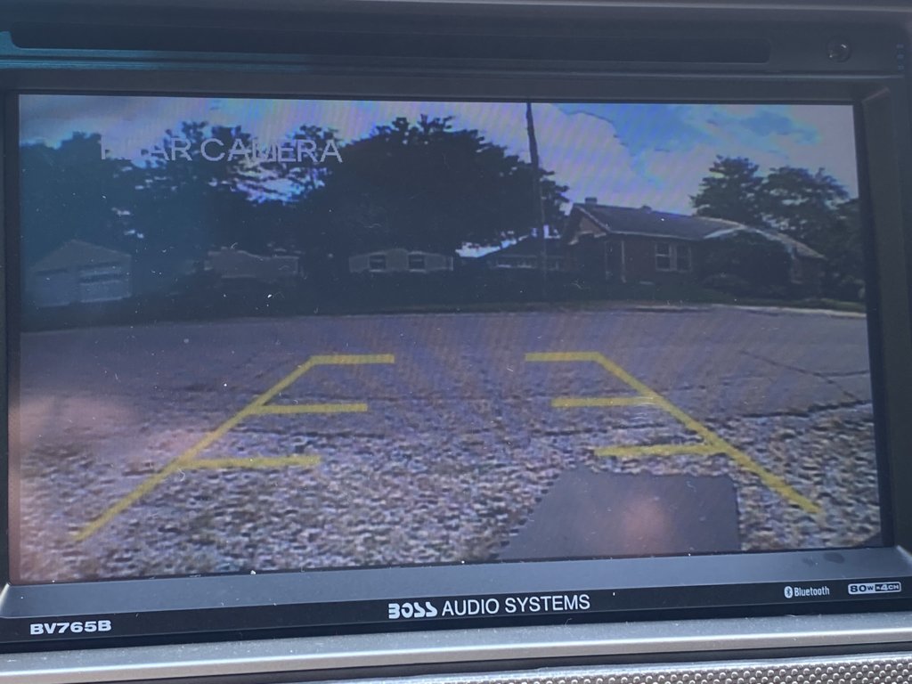

  6. Aug 24, 2024 at 3:31 PM
    #26
    Knudsen
    Knudsen Well-Known Member
    Aug 8, 2024
    #454753
    399
    Jon
    2008 Access Door TuRD
    To bet installed: bling grill, headlights, fog lights.
    The one I installed has an RCA plug input. Comes with a license plate cam with long enough wire for a Taco. RCA is a better connection for video, but automotive likes square plugs with lots of pins :D
    I think it’s unlikely the stock wiring uses an RCA connection. But you could look.
    Backup cam is awesome:
