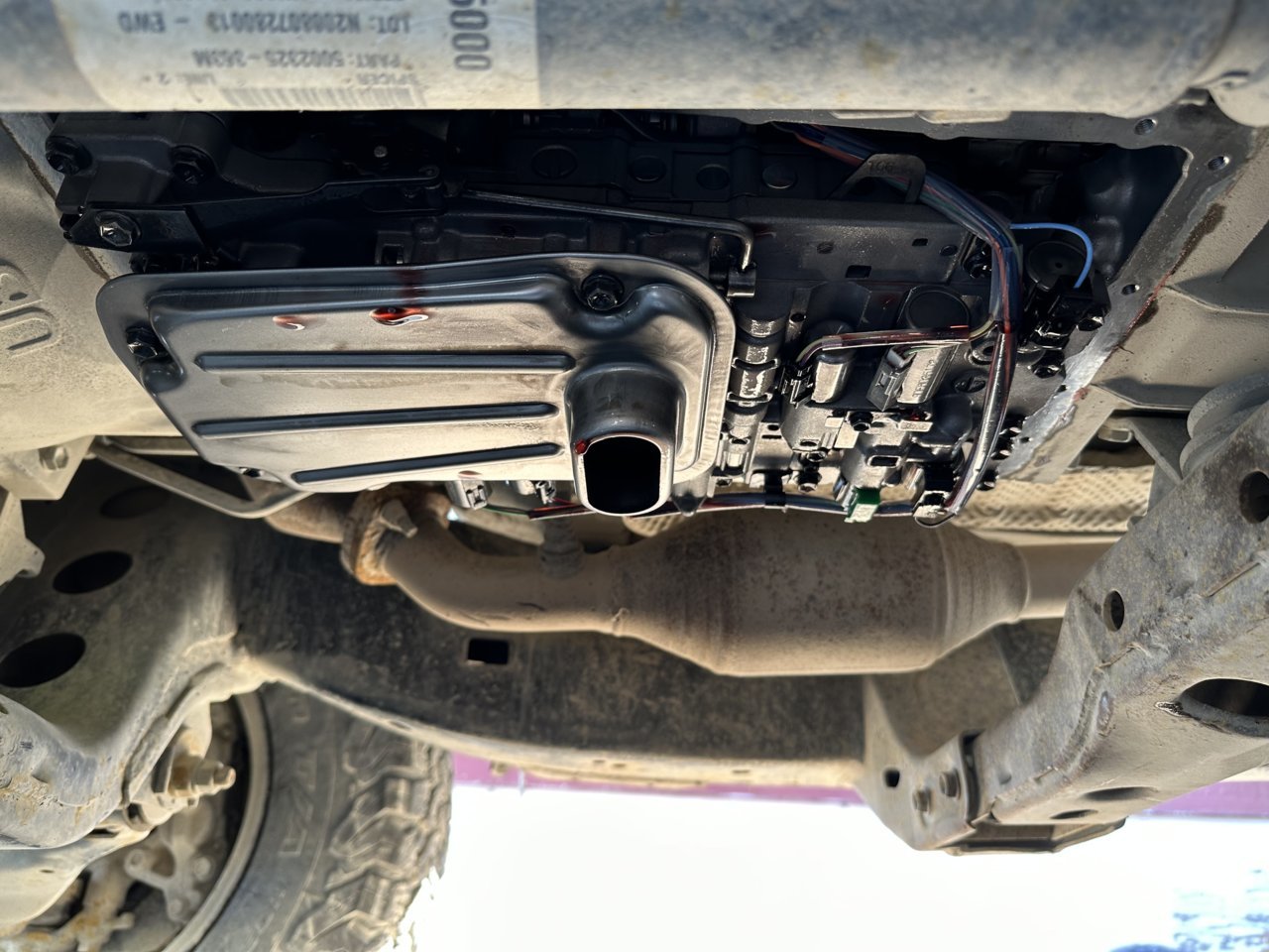

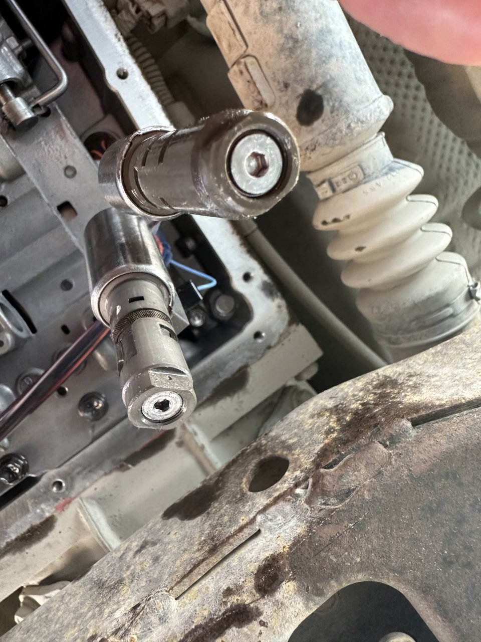

    Finally nice out today, have taken the pan off, I am thinking I take that middle piece out to check the filter? Also I think the solenoids, I do have a diagram handy to help point the solenoids out. I’m just wondering if I take the valve body off for this.

    Hello, yea I did, it was still not getting anywhere in fwd. do I take the valve apart?through these screws with the Allen key?

    You do not have to take the solenoids apart . I would suggest splashing them with brake clean before you put them back in though .

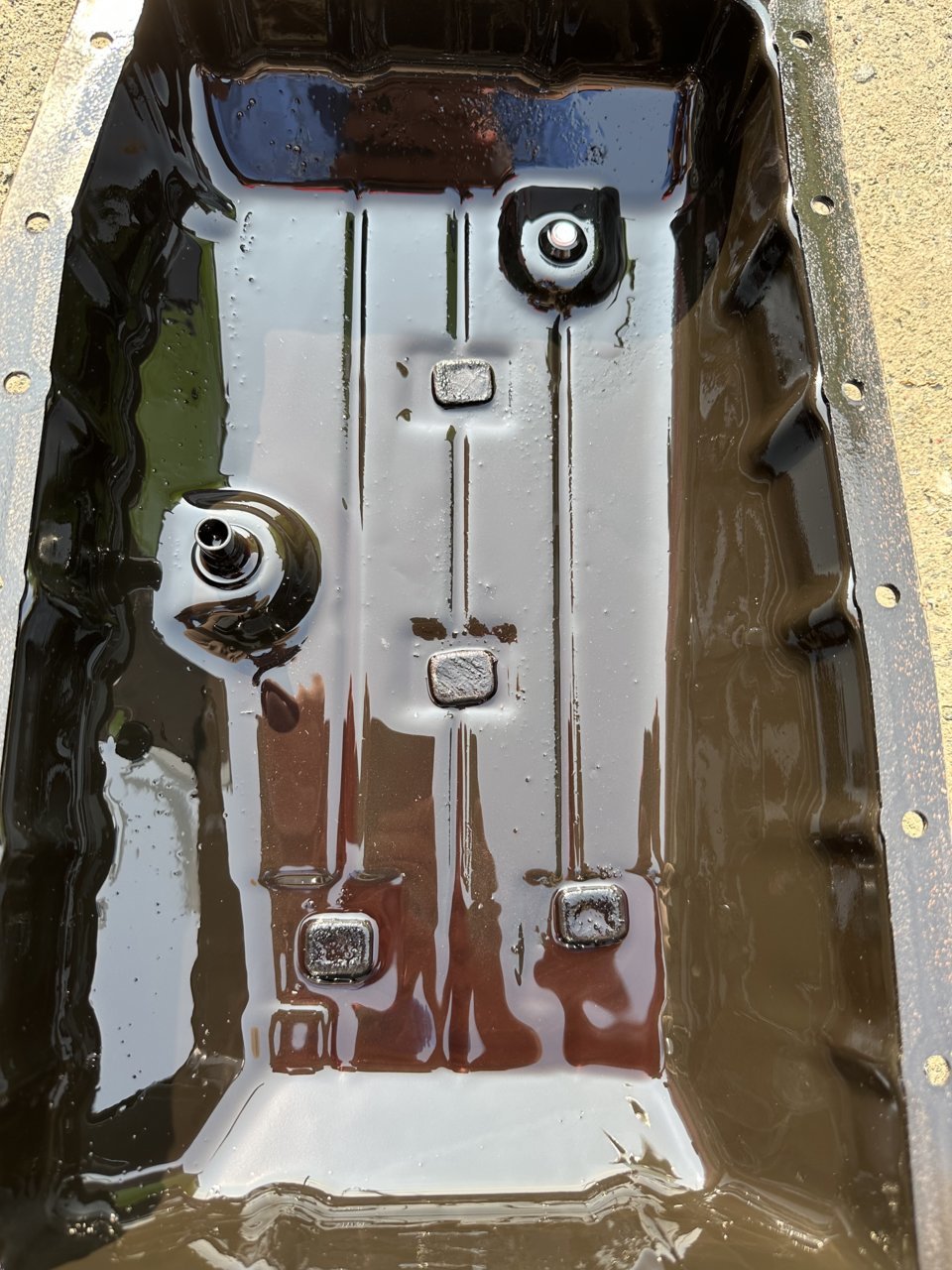

    How about a picture of the bottom of the transmission pan ? Thats going to give us an idea of the condition of the transmission .
    What was on the magnets ?
    Was there any alluminum in the bottom of the pan ? Brass or plastic chunks ?

    it seems like there is a couple of really tiny pieces of metal, not very much though. That’s about it. Will wd-40 be alright instead of brake cleaner?

    Just cleaned out all of the solenoids with brake cleaner. Gasket still looks good might just use it again. A couple of them looked dirty. I am just wondering if there is anything else I should check or do before I piece it back together now.

    Not liking what I saw in the transmission pan .
    It explains why you have a loss of forward . Too much metal and alluminum .
    Your valve body is going to be hung up .

    Damn, yes usually short distances. Gets about up to -50 to -55 for a few months, when we use it the most to get around too. Seems like it more than likely needs a new transmission now.
