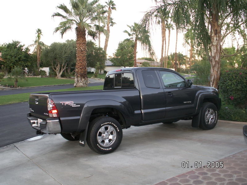

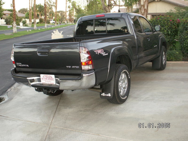

    Hey guys i got my TSB Suspension done yesterday 4 Leaf, and i got a 2009 Taco they should do it for you guys i just told them that the springs numbers match the ones from the 2008 tacomas at first they didnt want to do it but with a complaint they approved it good luck with that

    Yea thats not cool, Well i got mine done in Palm Springs thats where i live, and its 2 hours away from san diego its called TOYOTA OF THE DESERT good guys there, i dont know if you want to drive 2 hours to get here

    Like an "1 1/4 or so but it looks good and feels better , you really cant tell a difference though
