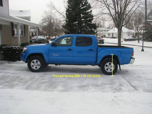

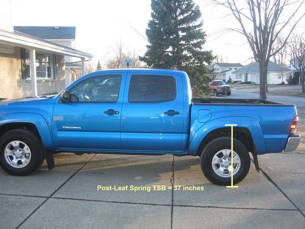

    I have a 2009 Tacoma Double Bed 4x4. The Leaf Spring TSB was installed yesterday. I did not get hassled from the dealer, and I followed the logic about harsh ride complaints that I read on the TW posts. I had approximately 1000 miles on the truck when the TSB was performed. Here's some pics:
    Pre-Leaf Spring TSB:
    Post-Leaf Spring TSB:
    Picture of the New 4-Leaf Spring:
    I prefer the way the truck rides with the new leaf springs. I loaded the bed with stuff for my son at college and it did not bottom out on the trip.

    That's great that you've put up photos to show the difference in heights. I currently have 1" blocks in the rear (height is 36 7/8 on drivers 37 on pass) I'm assuming a non level ground. I'll be getting my TSB done this next week (dealer's ordering the parts now) and don't expect a height change, I originally was going to increase my front from 1.75" to 2.5" but feel the front will then be taller than the rear. Anyways, your photos will help people see the differences in pre and post. Great job posting pics again!
