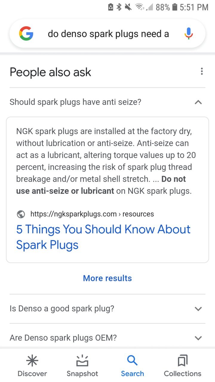

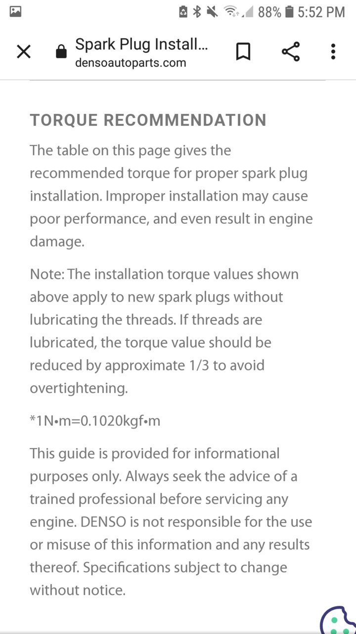

  20. Oct 12, 2021 at 3:55 PM
    #20
    tacotoe
    tacotoe Pastry Chef
    Nov 25, 2007
    #3593
    5,915
    Nebraska
    `17 AC Sport MT
    ARE Topper, Icon aal, OEM Audio+
    Here's a couple things I just screenshot from NGK and from Denso goggle itScreenshot_20211012-175105_Google.jpg Screenshot_20211012-175248_Chrome.jpg
