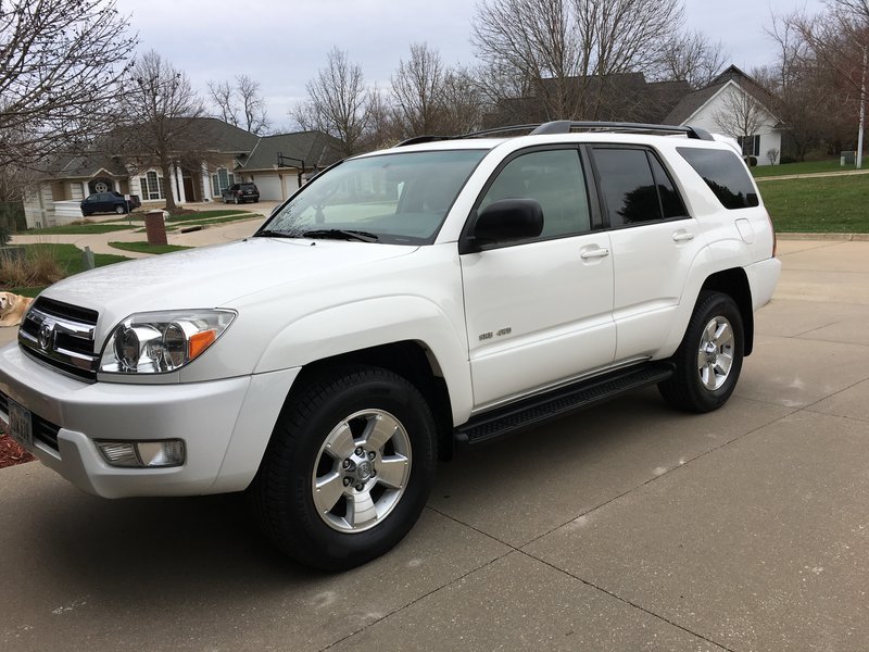

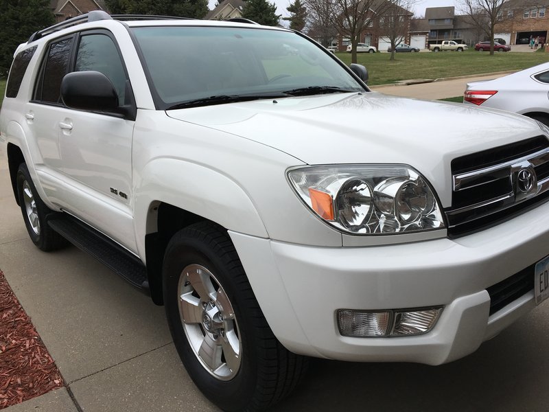

    Most of my Toyota's have been white. White 2005 4Runner, white 2007 SE Camry, white (Blizzard Pearl) 2007 Solara CV and a white 2001 Corolla. My ordered 2017 Tacoma is also white. I love white because it's easy to take care of but since it's not clear-coated it will oxidize more than some if not taken care of properly. Best advise is to keep it waxed and do it often. If the body is still in good shape don't paint it! You can still bring it back to life. Amazon sell's a Meguiar's buffing pad, DFC6 DA Foam cutting disc and some Meguiar's G17216 Ultimate compound that'll bring it back to life. I just did this to my 2005 4Runner that hadn't been waxed in almost 7 years. I don't have a before picture but I'll include an after and you can see for yourself. IMG_1556.jpgIMG_1560.jpg
