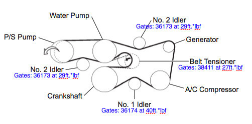

    IMG_4095.jpg Maybe check all your pulleys when you're replacing the belt, the idler pulleys need to be replaced on these trucks sooner than some vehicles out there. There are 3 pulleys. Also spin the alternator and make sure the bearings in it feel ok.
    Edit, there's a bearing in the compressor clutch assembly too, but it's not a common wear part.
