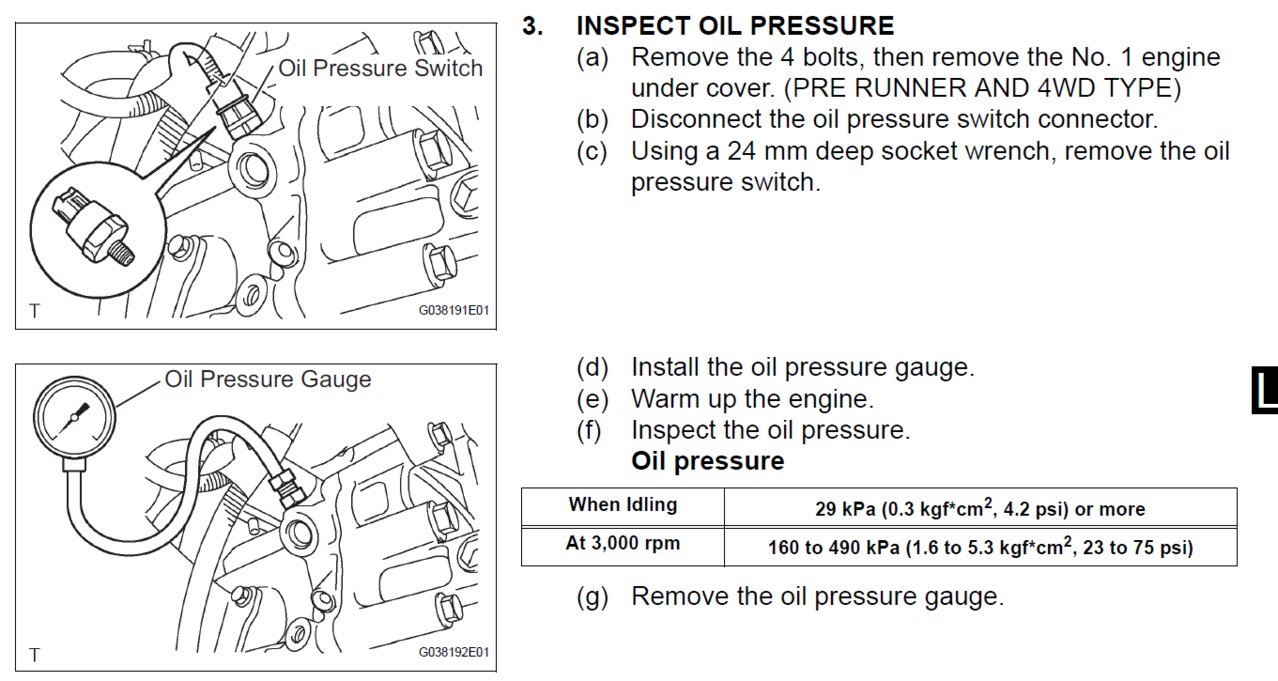

    Do not torque it, it is pipe thread and should be installed with a small ratchet by hand.
    It's just a deep 24mm socket, you don't need to purchase an oil pressure switch socket.

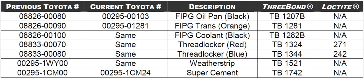

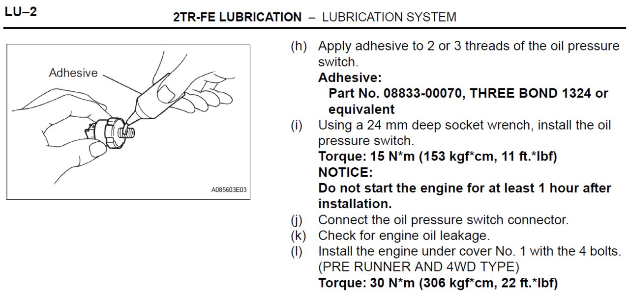

    Toyota recommends Loctite 271. I'm a fan of using something like Gasoila on those types of components. Teflon is a no no, if a piece becomes dislodged it can easily clog an oil passage. Torque is 11 ft-lbs.

    Wow, they recommend 271?
    I guess the tapered threads don’t “hold” as well as standard?
    The last one I replaced was on a Ram 1500 w/5.7
    I was afraid of stripping or snapping it off.
    There wasn’t much to the threaded inlet.
    6 gearT444E likes this.

    The switch drops out at <4psi. Even with a crack or a leak it would not go that low I don't think. Not sure about the 4cyl but the V6 it threads into the oil filter gasket assembly so it's easy to see at the top of the engine. What you suggested is a good idea, have a spare on hand. More than likely, the sealant on the OE threads just degraded and broke down over time and is causing the leak.

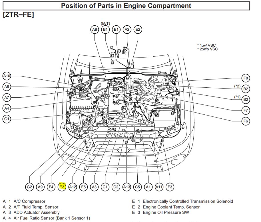

    Wow is it a pain in the ass to access on the 4 Cyl without a lift...

    it looks like a crappy spot from the pics in the FSM. Good luck! Maybe get a wobble socket or swivel adapter to remove it once you get it unplugged.
