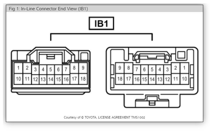

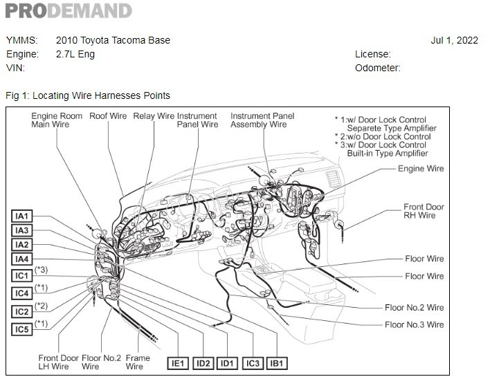

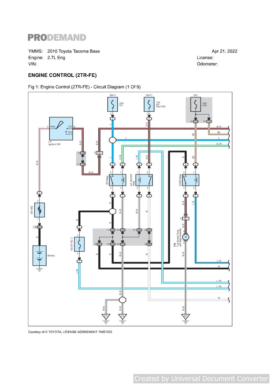

    Check the fuel pump wire (Pin8 Black/Red) at the IB1 connector behind the drivers side kick panel, sometimes it develops a bad connection there.

    I think I'd check the IB1 connector for signs of corrosion or a bad connection.
