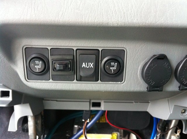

    has anyone tried to fit the 4runner 2010-2012 heated seat switch on the 2012 Taco empty slots next to the A-trac switch? they're both square and look about the same size. I went down to a dealer to try and figure it out but they didn't have any friggin 4runners!
    the 2012 taco has two very conveniently placed empty slots next to A-trac switch...one on the left and one on the right of the A-trac switch, couldnt be a better place for the heat switches. Im sure i can take aftermarket heat pads and wire them to the OEM 4runner switches, just wondering if anyone knows of they're the same size? from pictures they sure look like a dead ringer.

    ok, got them and installed them, worked like a charm
    $90 shipped from somewhere deep in China, took forever to get them, but they're well made and work great. THeyre back lit when you turn your headlights on, and theres a on/off light that goes on when operated. It has a 5 position click wheel
    Im out of blank switch spots on my truck :)...i hate blanks, means I'm not getting something others have on their trucks

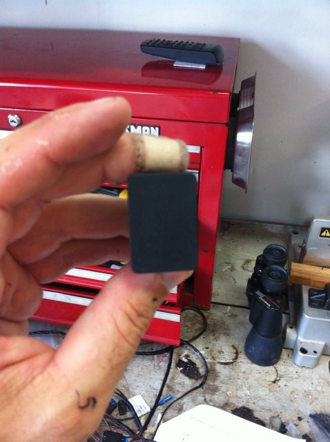

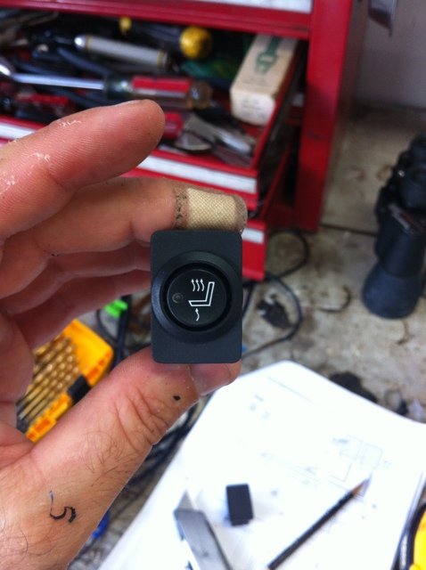

    if you use a step drill you can install a switch right into the blank plug... this is what i did with my katzkin heater switch.
