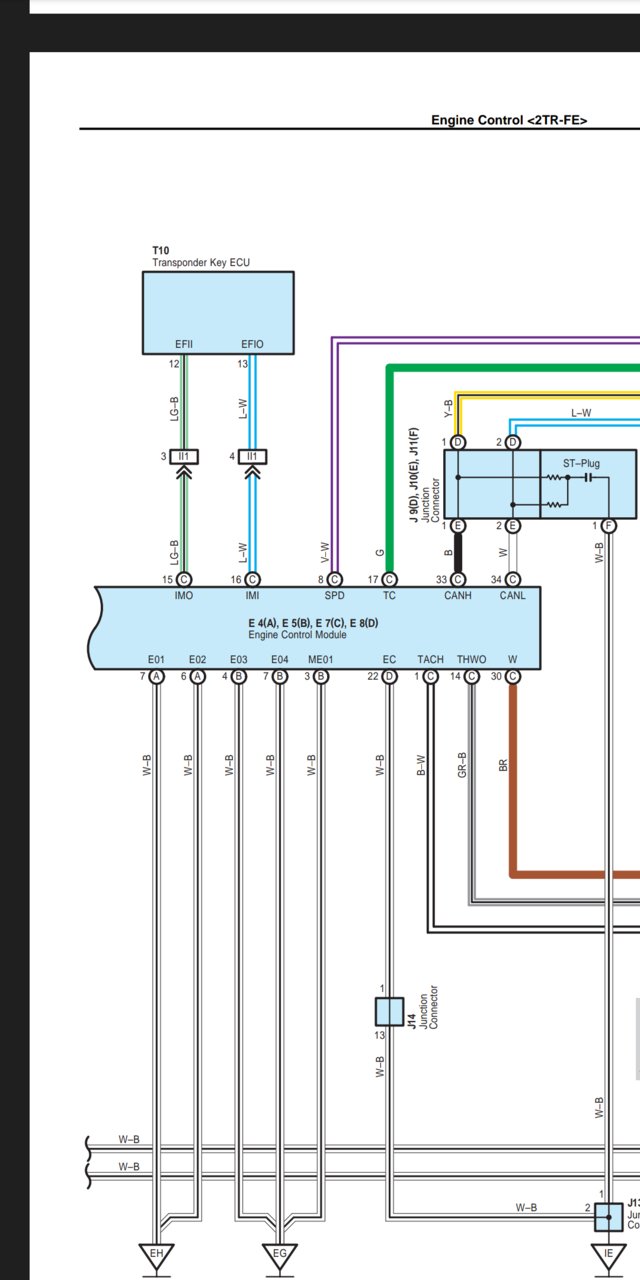

    The only place where the immobilizer ecu ties into the ecm is on pin 15 (IMO) and pin 16 (IMI) with a non immobilizer ecu like the one I bought those pins should just be unused. I am thinking the ecu I bought might be bad, but I want to be damn sure before I throw yet another ecu at the truck.
