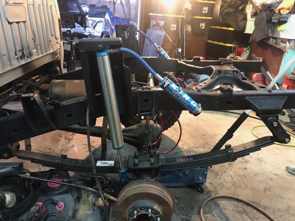

    I’m curious about this and how you got a 63 to flex more than a well built leaf pack. My Chevy 63 experience did not net any more amount of travel to make he amount of work worth it and if you’re running the Archive kit then you’re limited to a 14” shock.
    I guess my question is what are you actually cycling with 63s?
  4. May 8, 2019 at 3:50 PM
    #24
    ovrlndkull
    ovrlndkull STUKASFK - HC4LIFE
    Jan 7, 2017
    #206806
    37,794
    Skip
    Burlington, NC
    2005 DCLB Silver
    63s, XD Machete, Beat not Babied
    Sorry finally getting around to answering this.
    Am I getting more flex out of a well built leaf pack? At this point not much shocks are limiting factor.
    Limited to 14" shocks with AG kit? Yes and no. I have a 1" body lift this allowed me to raise the towers up from typical mounting location. But yes in a normal position you would be limited to that length. Not sure if you could run bigger if you ran the springs I am running.
    What is my cycling I have no clue haven't done the math or measured yet. It won't be a whole lot more than the 14" shocks since they are mounted ~6 inboard of the WMS
    So how I was able to accomplish what I did. First off I wasn't impressed with the typical 63 leafs and how flat they were. So I looked all over to find one with more arch including looking at lift leafs. I was about to just have a custom pack made, but I stumbled across a 5+1 leaf pack for 14+ 1500HD and 2500. This had a little over 1" more arch than all others. I just removed the overload spring. Having a 1" BL and more arched springs I was able to raise the top of the shock up and the lower mount set with 5" of uptravel rotate the lower mount so the lower eyelet is ~1" above the top of the axle tube. I also have the hangers set to ~25* after everything has settled and will be down around 20* once I add the weight I accounted for. Fully drooped out I am getting 0 leaf separation and the hangers can still rotate down a few more degrees. With 16" shocks the hangers will be able to rotate down that last little bit and I can get some leaf separation to gain some more droop. This was months worth of research and searching for what I was looking for. I was about to order a custom leaf pack from Alcan or Deaver with very similar specs as to what I have now. I have seen some not so great 63 swaps, I think a lot of the appeal to them was the cheap swap parts and can source the springs used from a junk yard. At that point I think you are better off with just hammer hangers and a shock relocate with some Dakars, Deavers, etc. as those 63 swaps don't seem to have any more travel than that set up.
    I do think that with a custom pack and/or SUA you could get a little more travel with hammer hangers and keep the stock length springs. There are many ways to skin a cat.
    Hope all that made sense.
