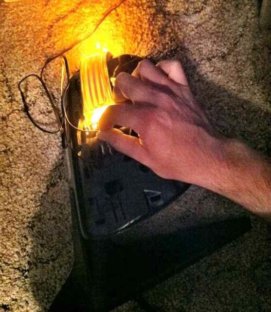

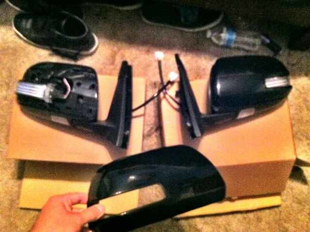

    That eBay company shipped me another pair...received it today
    The covers will be color matched by either Saturday or Monday morning..
    Also tested both turn signals
    I need to run all my wiring ASAP for the turn signals and heated mirrors (the heated mirrors will come in time.
    Question: does anyone know if these are power folding mirrors? I didn't see it saying anything but they seem to have the actuator on the inside :notsure:

    Here you go...
    10-11 Toyota 4Runner Power Heated Signal Puddle Light Mirror LH & RH Set Pair
    http://bit.ly/R4VigX
    These guys are awesome...ups lost my package and had a new package shipped to me 2-3 days later :thumbsup:

    :laugh: this guy...just remember these are not Toyota ones...they're aftermarket but IMO the quality is pretty good...they feel really solid so I can wait to have them installed :goingcrazy:
