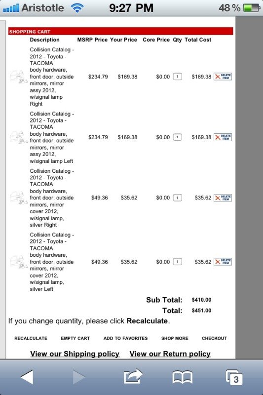

    manage to price a pair of 12 Tacoma OEM side mirrors with color match cover. so far this is the most affordable ones I've seen. 451.00$ shipped

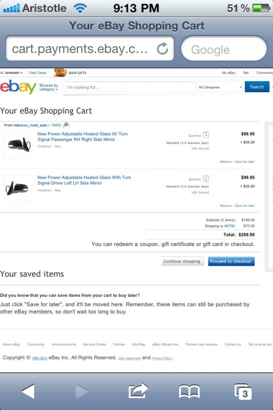

    but was also tempted to go cheap route. aftermarket 4Runner mirrors with plain black covers. 269.90$ shipped. got some thinking to do. what to do, what to do haha.

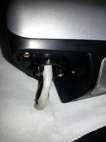

    I pulled the trigger on some of the 2010 4runner aftermarket mirrors. They came in a Kool-vue logo'd box, mirrors and the cover caps, made in Taiwan. Looks ok, but the one problem is on the mounting part with the factory Tacoma mirrors. The three screws on the inside to remove the mirror from the bracket part are not the same. The three screw holes are close, but do not line up 100%. On the OEM mirrors there is a metal part that the aftermarket mirrors do not have. Even trying to move the grey metal part to the 4runner mirror, didn't work.
    OEM mirror metal part - grey part, even after removing it doesn't match up.
    Aftermarket 2010 4runner mirror - black part.
    It looks like the aftermarket ones combined the OEM grey part into the bracket part.

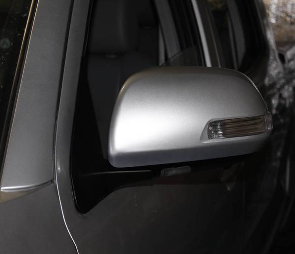

    The bracket arms from the base model manual mirrors worked, same setup from the Kool-vue mirrors between their Tacoma and 4Runner mirrors. The aftermarket ones had all the screw holes bases the same length, instead of one deep one and two shallow ones.
    All the wires were different colors but everything still works based on the pin settings and where the wires go.

    Looks good man :thumbsup:

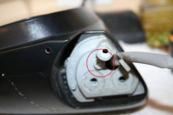

    The OEM bracket that bolts to the truck had a different end than the aftermarket mirror assembly where they bolts together. The grey metal piece from my truck's mirrors wouldn't fit to the aftermarket mirror and with out that piece attached to the brackets it wouldn't fit together.
    I bought a set of non powered mirrors to get the brackets that would fit a Tacoma and the aftermarket mirrors. No shaking or anything that I can tell.
