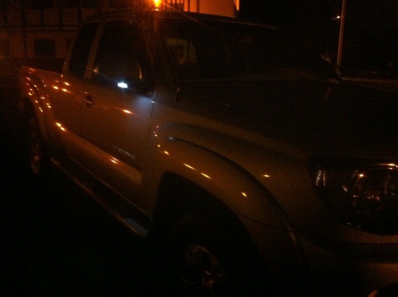

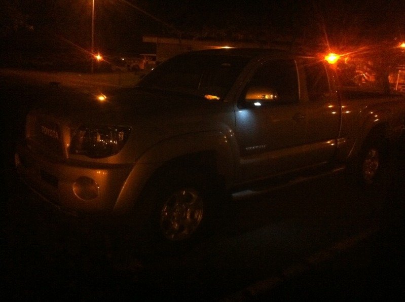

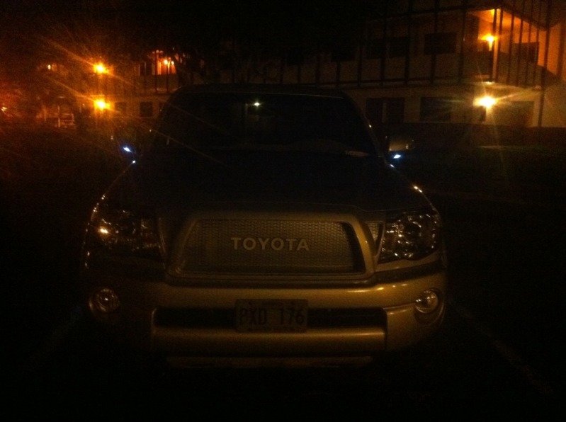

  17. Dec 25, 2012 at 9:40 PM
    #357
    adio
    adio Well-Known Member
    Sep 11, 2008
    #9165
    2,637
    HI
    2015 INFERNO TRD PRO
    here's some night pics, grainy pics from my iPhone but I'll take better ones later on. but I can vouch that they look a lot better in person. has that premium look to it :D

  18. Dec 25, 2012 at 9:59 PM
    #358
    Jerez
    Jerez SoCal LED Dash Swap
    Feb 1, 2010
    #30488
    17,999
    Rod
    Ontario Ranch
    08 TRD 2wd converted to 4wd
    Estock
    Looks great man :thumbsup:
    A buddy of mine wants to buy mine off of me...made me and offer the moment he saw them :laugh:

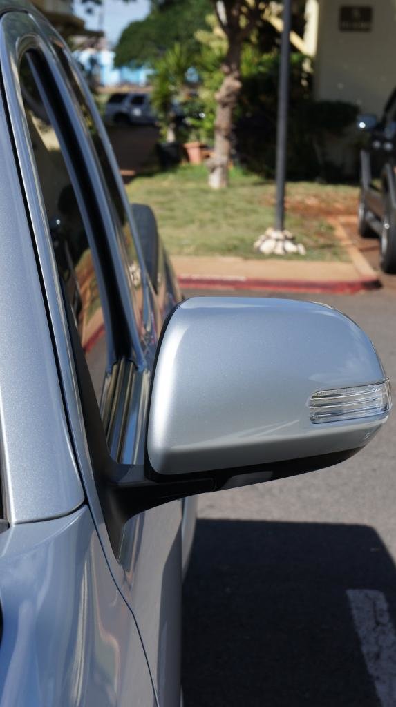

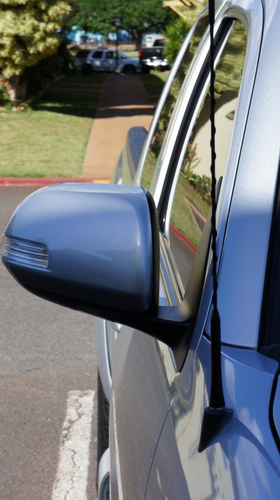

  20. Dec 27, 2012 at 5:43 PM
    #360
    adio
    Sep 11, 2008
    #9165
    2,637
    HI
    thanks guys.
    here's some day time pics.
