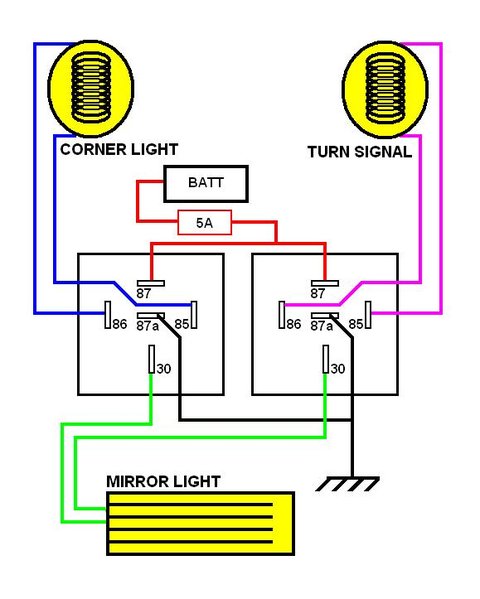

    Whether or not this will work depends on a number of things:
    1 - You must use turn signal lamps, or non-polarized LEDs (will light up regardless of polarity)
    2 - Your Tacoma parking light/turn signal circuit must be relatively stock. I don't know if this will work with flashback mods. It won't work with the mod that cross-ties the turn signal to the corner marker without some creative use of diodes.
    What it do?
    It ties the corner marker and turn signal into the mirror turn signal.
    Truth table:
    Corner off - Turn signal off = Mirror off
    Corner off - Turn signal on = Mirror on
    Corner on - Turn signal off = Mirror on
    Corner on - Turn signal on = Mirror off
    It uses the corner marker and turn signal to switch a pair of relays that operate like a 3-way switch in a hallway or large room with two entries.
    When the corner marker OR drls are on, the mirror is on.
    When the corner marker is off, the mirror light follows the front turn signal/DRL.
    When the corner marker is on, the mirror light follows the inverse of the front turn signal, so you get an alternating flash between the two.
    Two identical circuits are needed... one for each mirror.

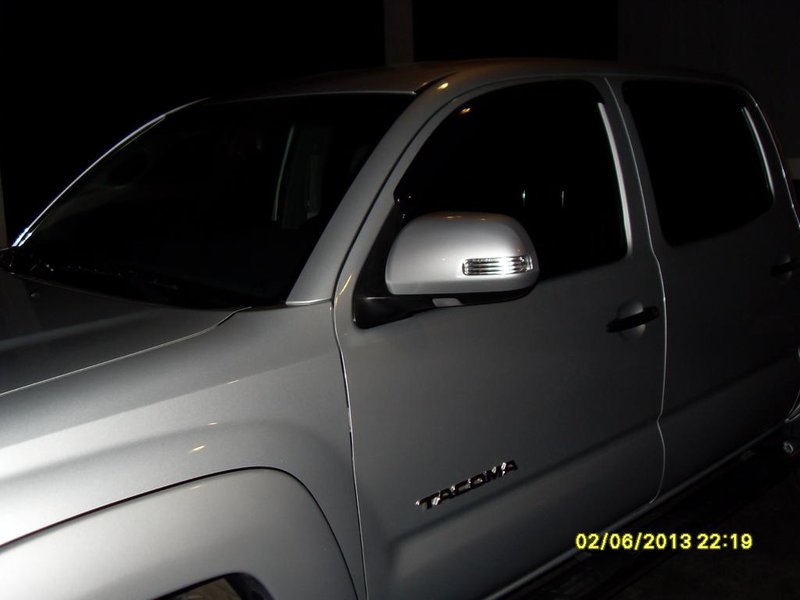

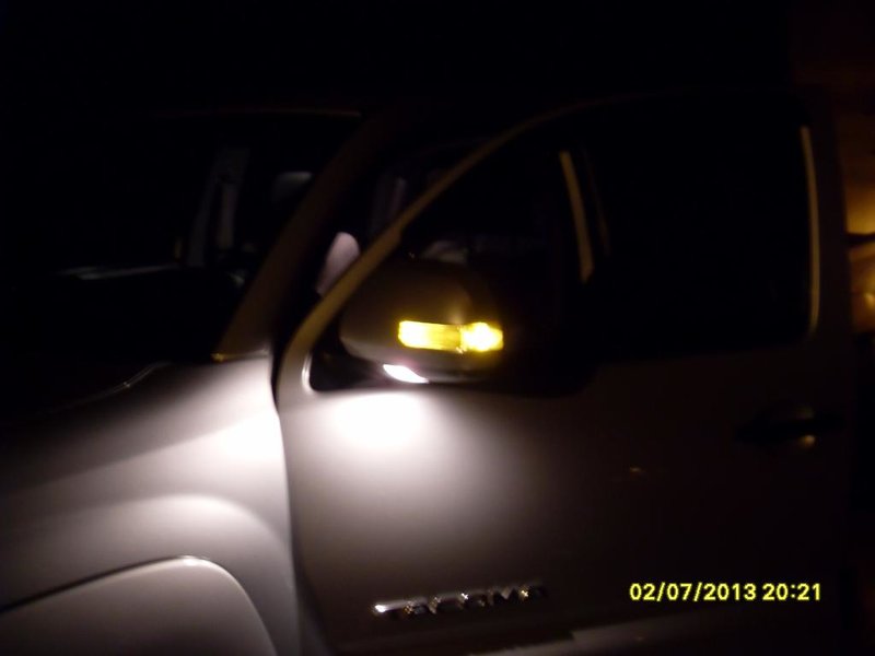

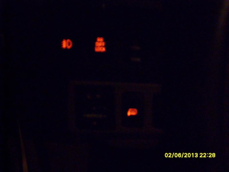

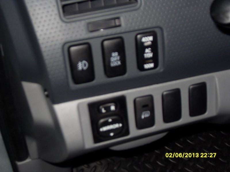

    Hey guys, I installed my OEM 4runner mirrors the other day and got a friend of mine to do the wiring, he's a car stereo installer tech, done a very neat job and had all the parts needed. I used the highlander heated switch, here's some pics...
