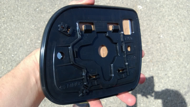

    First pop off your mirror lense, pulling up gently from the bottom until it pops off.
    How it looks like from the back. You can see how it attaches to the motor.

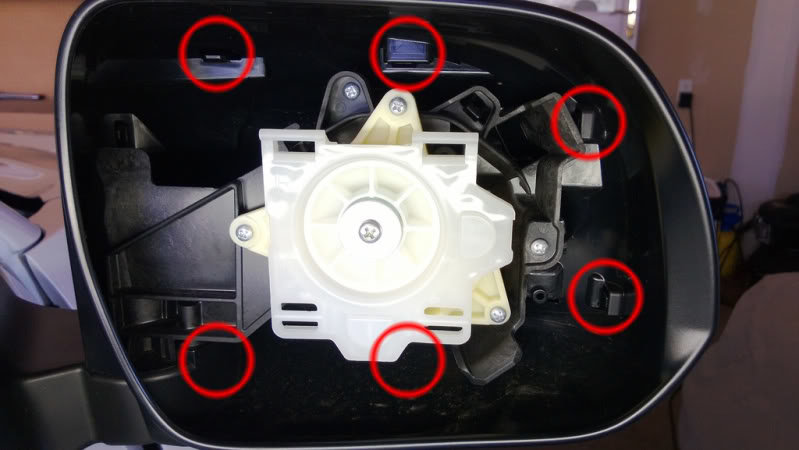

    Now you can see the inside of the assemly and how the cover attaches to the mirror assy. Red circles indicate how the cover locks to the mirror motor assy. You can use a flat head screwdriver to release the tabs. That's pretty much it.
    0d43415e3ffb9180e8d6a456667b2d7f_zps60a4_162f82372e94476480c5e4c22bf84c43aa04d224.jpg

    Thanks for the pictures adio...that looks like a better way of removing the covers than just prying them off like I was trying. So looks like I pull out on the bottom half of the mirror, then pull down so the brackets slide out from the top... correct?

    Yups, exactly like you said. Just be gentle when you're pulling that mirror.
