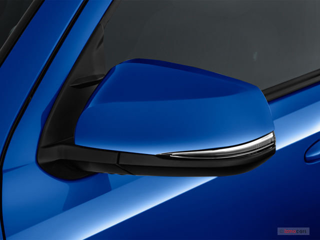

    Wait, 3rd gen side mirrors have integrated puddle lamps in them now :confused:
    I don't think it'll work, looking at it, it's a different design from the 2nd gen.
