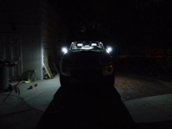

  19. Oct 27, 2016 at 7:45 AM
    #519
    nazlax10
    nazlax10 Check out my build thread for any products used!
    Mar 31, 2015
    #152198
    2,232
    David
    Woodstock, GA
    '21 Toyota Rav4 LE... At least it's a Toyota
    https://www.tacomaworld.com/threads/nazlax10s-build.408318/
    Does anyone have good pictures of how much light is placed on the ground from the foot lights? I found one on page 12 but that's it. @Jerez, is all the ground light in this picture from the foot lights alone? and if so did you use a specific led to obtain that? thanks for any help.
  20. Oct 27, 2016 at 3:53 PM
    #520
    Jerez
    Jerez SoCal LED Dash Swap
    Feb 1, 2010
    #30488
    17,999
    Rod
    Ontario Ranch
    08 TRD 2wd converted to 4wd
    Estock
    yea its only from the foot lights....and i honestly dont remember what and where i got them :laugh:
    EDIT: holy crap its been 4 years already :eek:
