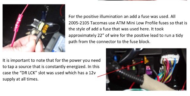

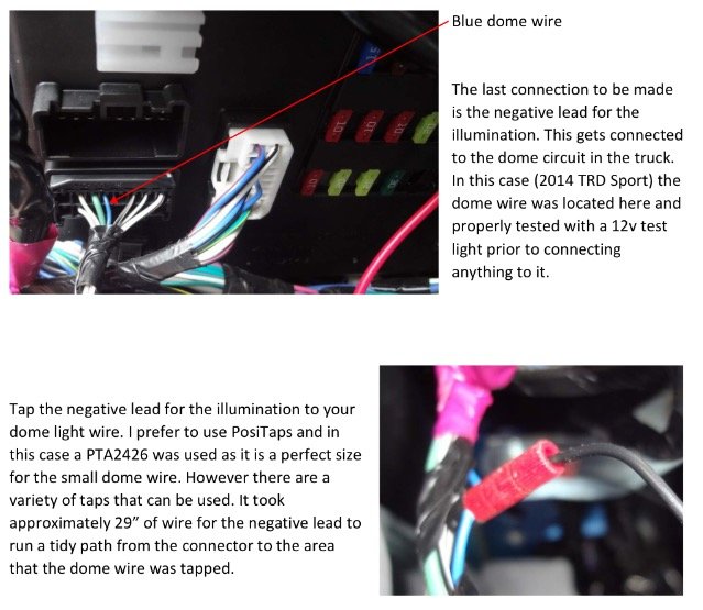

    @adio How did you wire your puddle lights? I currently did the mod, my truck was wired for turn signals and just hooked these straight into the side mirrors. Don't need the heater option since Hawaii doesn't get to cold to need the option. I'm stuck on how to wire the puddle lights (where does the Positive wire into and where does the negative wire into?). Mahalo nui loa.

    Try this, go to page 2 & 3 it shows you where to tap into to get illumination. I know it's for the illuminated transponder amplifier mod but it's pretty much the same concept.

    Shoot from the looks of it you might not have enough post counts for you to able to see it. I'll get pics up of that PDF file.

    Then, looks like wiring the puddle lights is a pretty detailed task, tapping into the blue dome light wire by the fuze box and a power source. Shouldn't be too hard... What about the blinkers? Do I have to tap into wires for that too. I didn't think I needed a new connector, but looks like I might.

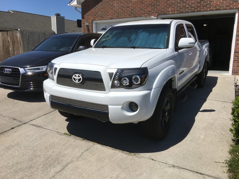

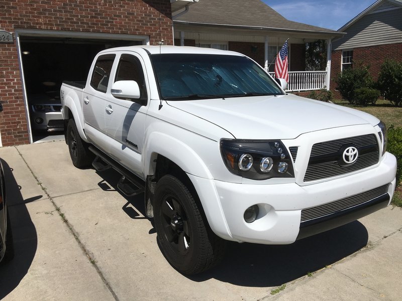

    I did mine. Thanks everyone for your input.
    Factory mirrors and covers
    Highlander heated switch
