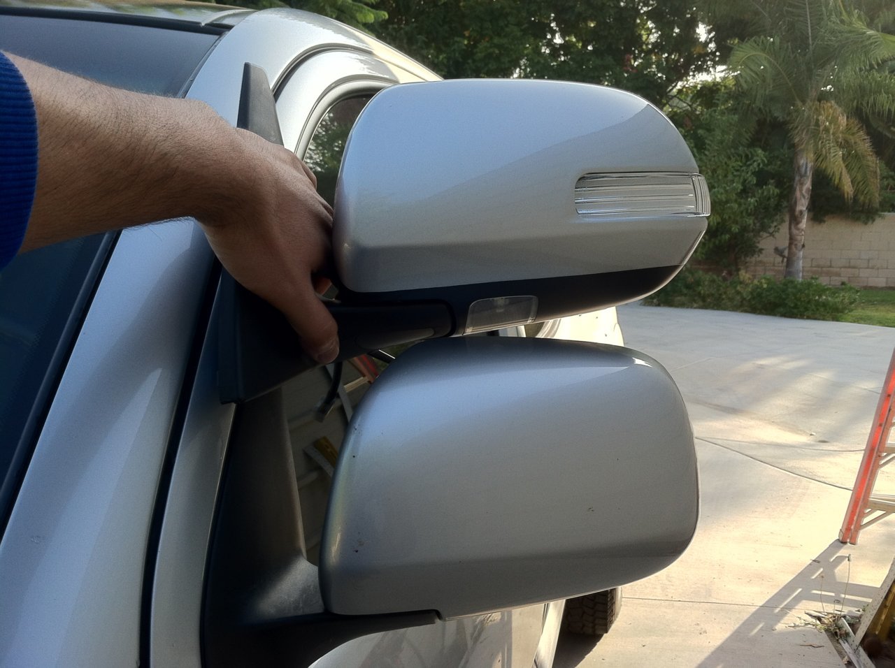

    Yea there’s a couple of threads on it...I’ve had mine since 2012
    It’s technically the same mirrors on the 12-15 trd sports just with puddle lamps and heated mirrors
    But you need to use the metal swivel piece under your stock mirrors and door mount from the tacomas to mount them

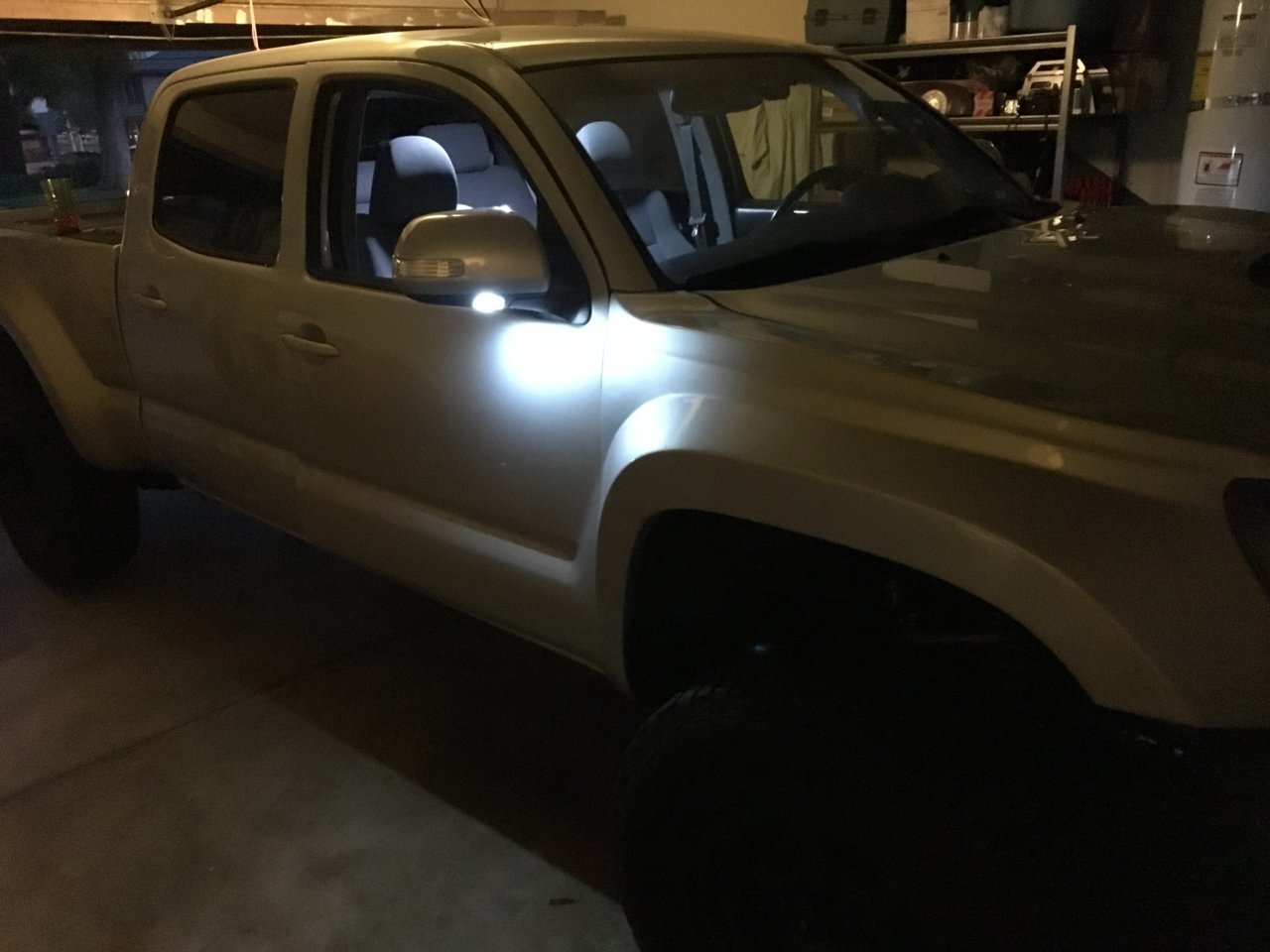

    Day I installed them:
    Puddle lights
    A couple months back...still look good

    Awesome, thanks. I searched and seen lots on 2010, but missed seeing anything past that for what any other years might work. Maybe I was just blind, but thanks for the info.
    Mirrors still look good for sure, and so does your truck, nicely done.

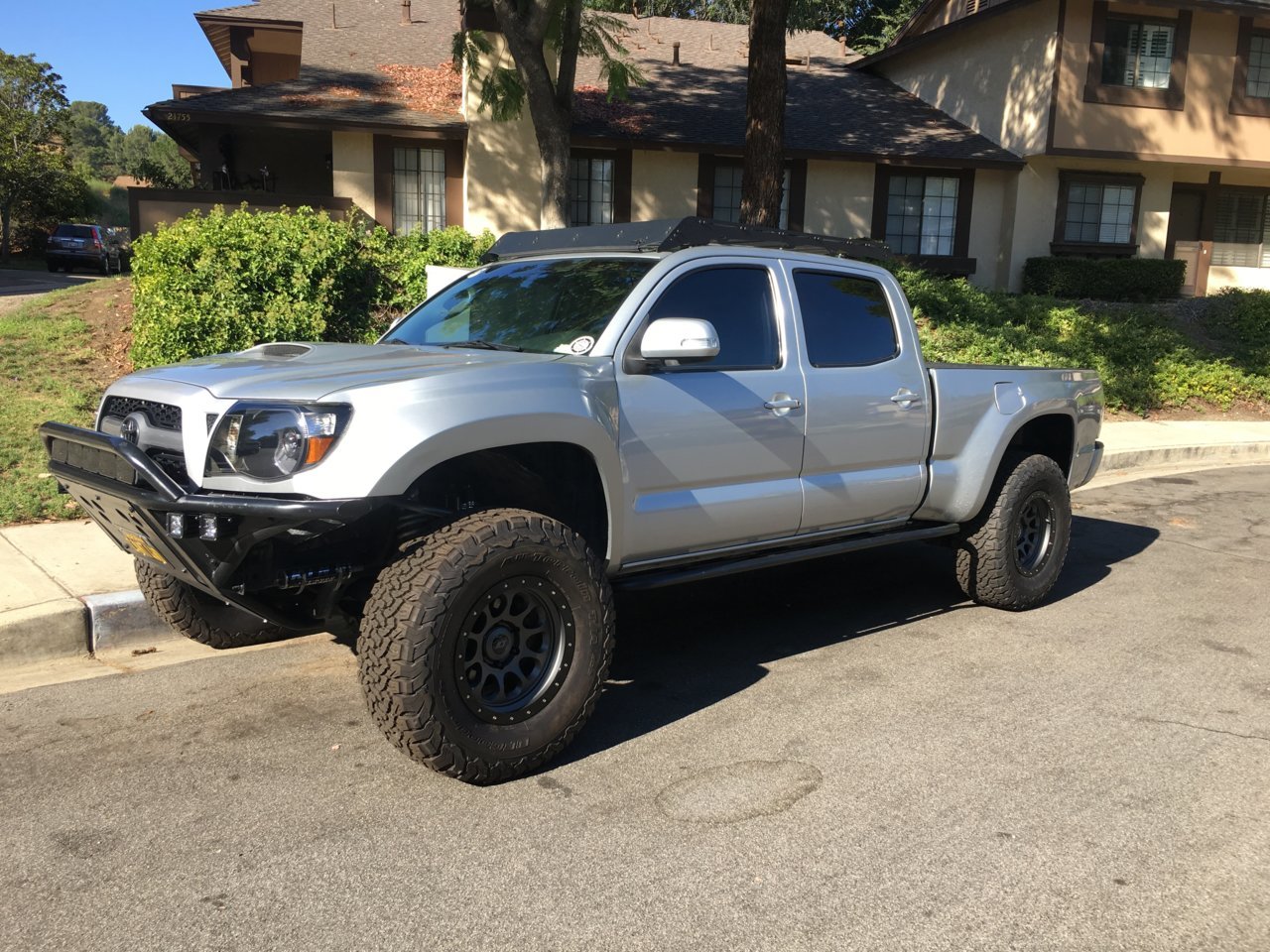

    As mentioned above, it’s 2010-12 4runner mirrors work on all 2nd gens
    But just need to run the new wiring for things to work

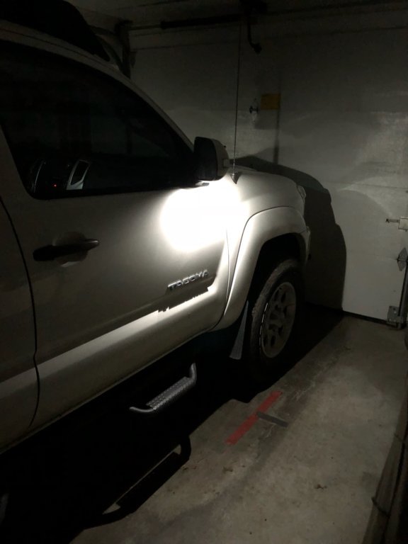

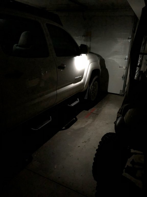

    Puddle lights are awesome!!
